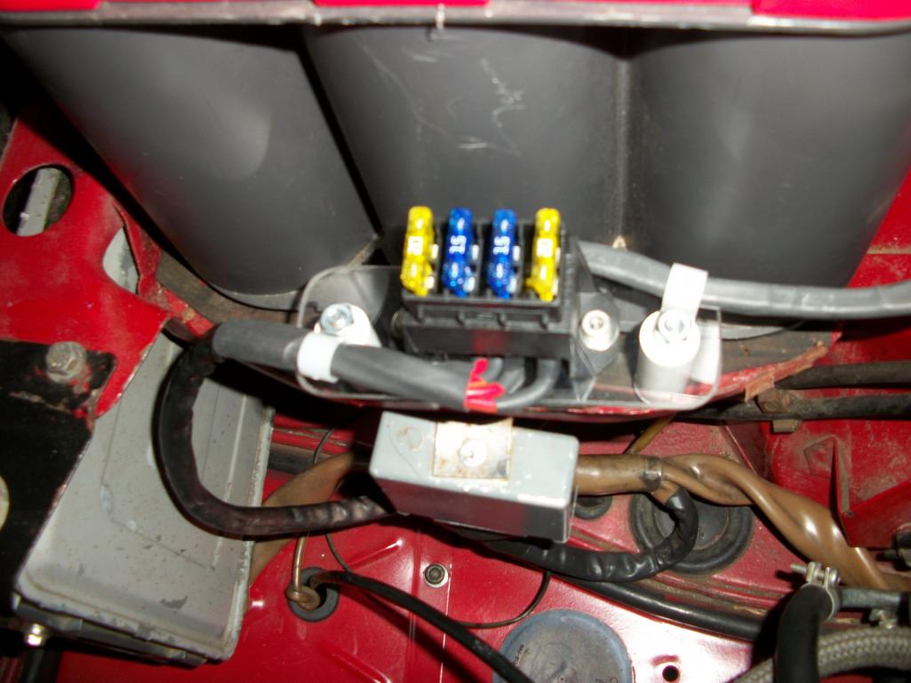

NEW INFO FOR EARLY CARS. THEY CAME WITH ONLY THREE RED WIRES!! Two 4.0mm and a much larger wire running forward to the dash area. Please check before ordering.
Last round this summer. Maybe next winter I will do this again if there is a demand.
See pics of the new 4-way and 6-way kits, and the completed install of mine. Kits are designed to go on the outer edge of the battery box, however some have mounted elsewhere. If you have need for longer wires so you can mount yours differently, let me know and we can make that work for you.
Also, please see the two pages of info below. You should be able to print copies.
From the supplier: 4/6 individually fused circuits with connections that enter and exit from the bottom allow this fuse block to be mounted in narrow locations. Clear plastic dust cover is included. Max load capacity for all circuits combined is 50 amps, 65 amps for the 6-way. Connections are made using 1/4" female push-on connectors.
I will open round four as I already have 3 folks who want one. There will be two models, a 4-way and a 6-way, and three stages; 1-basic, 2-connections on and soldered, 3 - with new battery connector.

Thanks guys,
I have three to ship out Monday to Type47 Fan,wingnut86, and rwilner and then there a couple of guys I'm waiting on to see if they decided or not. If they don't, I already have several guys wanting to purchase the left over ones.
Also adding a pic with the cable clamps installed and the fuses down graded. 20 amp in the outside fuses and 15 amp in the two inside ones. If one blows, I'll up it to the next higher. In this case, smaller is better.
