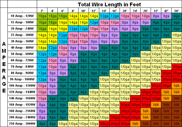

QUOTE(Tom @ Aug 23 2011, 11:26 AM) *
In researching, I've found that 14 ga. wire is good for 40 amps, so really no need to go 12 ga. Of course you are welcome to modify yours as you think necessary. Wire is expensive!!
Some wire sizing info.
