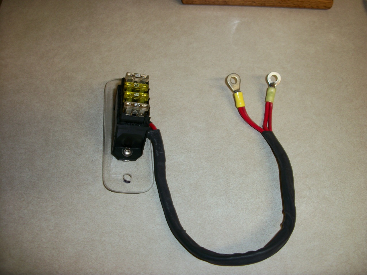

See pics of the new 4-way and 6-way kits, and the completed install of mine. Kits are designed to go on the outer edge of the battery box, however some have mounted elsewhere. If you have need for longer wires so you can mount yours differently, let me know and we can make that work for you.
Also, please see the two pages of info below. You should be able to print copies.
From the supplier: 4/6 individually fused circuits with connections that enter and exit from the bottom allow this fuse block to be mounted in narrow locations. Clear plastic dust cover is included. Max load capacity for all circuits combined is 50 amps, 65 amps for the 6-way. Connections are made using 1/4" female push-on connectors.
I will open round four as I already have 3 folks who want one. There will be two models, a 4-way and a 6-way, and three stages; 1-basic, 2-connections on and soldered, 3 - with new battery connector.

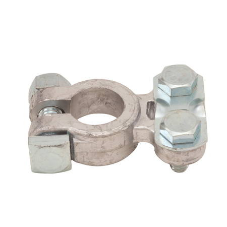

stage 1- basic kit $25.00
stage 2- connectors on and soldered and harness heat shrinked $30.00
stage 3- With new battery connector $32.00
6-way
stage 1- basic kit $30.00
stage 2- connectors on and soldered and harness heat shrinked $35.00
stage 3- With new battery connector add $37.00

I found some 1/8" X 1" bar stock that I think will do the job nicely. I will include a larger piece of heat shrink that can be placed just under the fuse block area if anyone has any concerns.
I don't supply the mounting screws or bolts to mount these kits. Some may want metric, others std., so I will leave that up to the individual.
I have, previously, stressed the importance of good solid connections in electrical systems. The system is only efficient in carrying current and voltage as the poorest connection allows. So I will put together the 4 wires and connectors between the battery positive and the fuse block if you so desire. There will be a slight charge. $2.50 per kit. See pic #2.
Basic kit will be $25.00 with shipping included, $27.50 if you want the connectors installed, and $30.00 if you need a new battery connector shown in the pic. The connector on the wires to the battery is the same ID size as OEM, so if your positive batt connector is in good shape, they will fit the stock bolt.

76-914   Wow. Opened my kit tonight. It's very professi...   Oct 15 2011, 10:56 PM
moparrob   Yep, I got mine too. Thanks again - it looks good...   Oct 15 2011, 11:08 PM
Tom   Thanks guys, I have three to ship out Monday t...   Oct 16 2011, 07:23 AM
76-914   Thx, TOM. The fuse block saved me again. I pm...   Feb 7 2012, 01:42 PM
