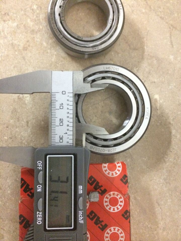

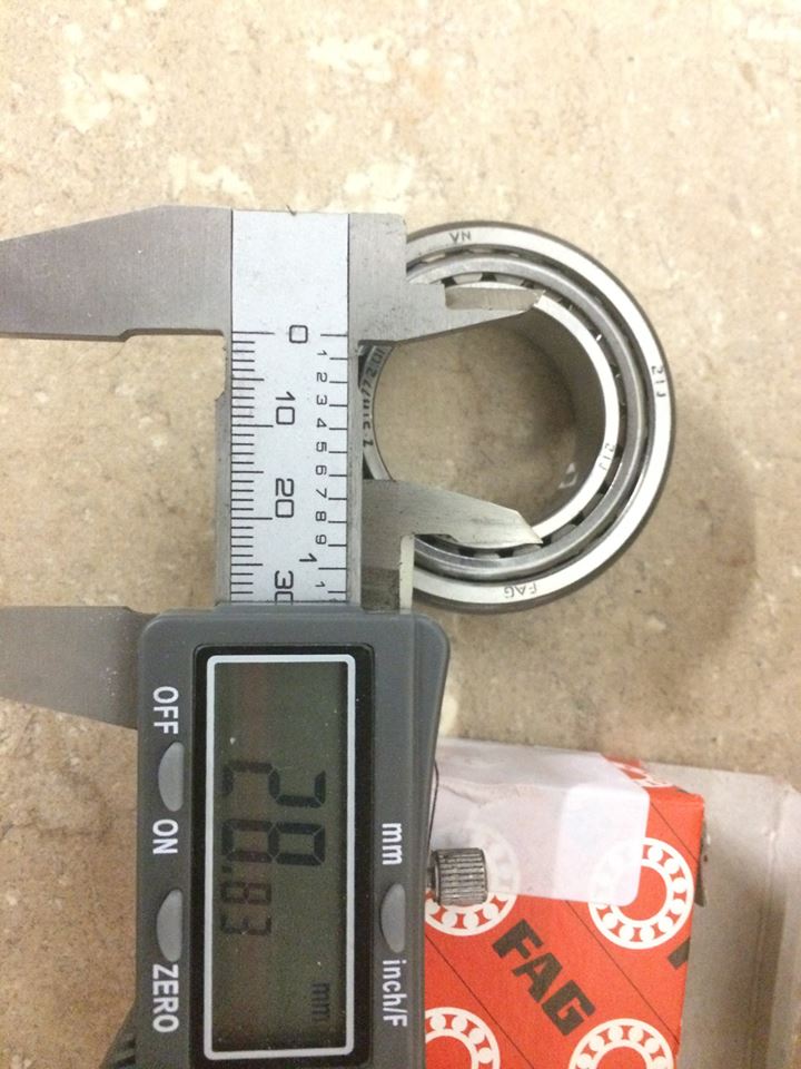

Smallish 914 inner bearing measurement:
(IMG:http://www.914world.com/bbs2/uploads_offsite/scontent-a-pao.xx.fbcdn.net-1110-1395175770.1.jpg)
Not as smallish 911 inner bearing race measurement:
(IMG:http://www.914world.com/bbs2/uploads_offsite/fbcdn-sphotos-e-a.akamaihd.net-1110-1395175771.2.jpg)
