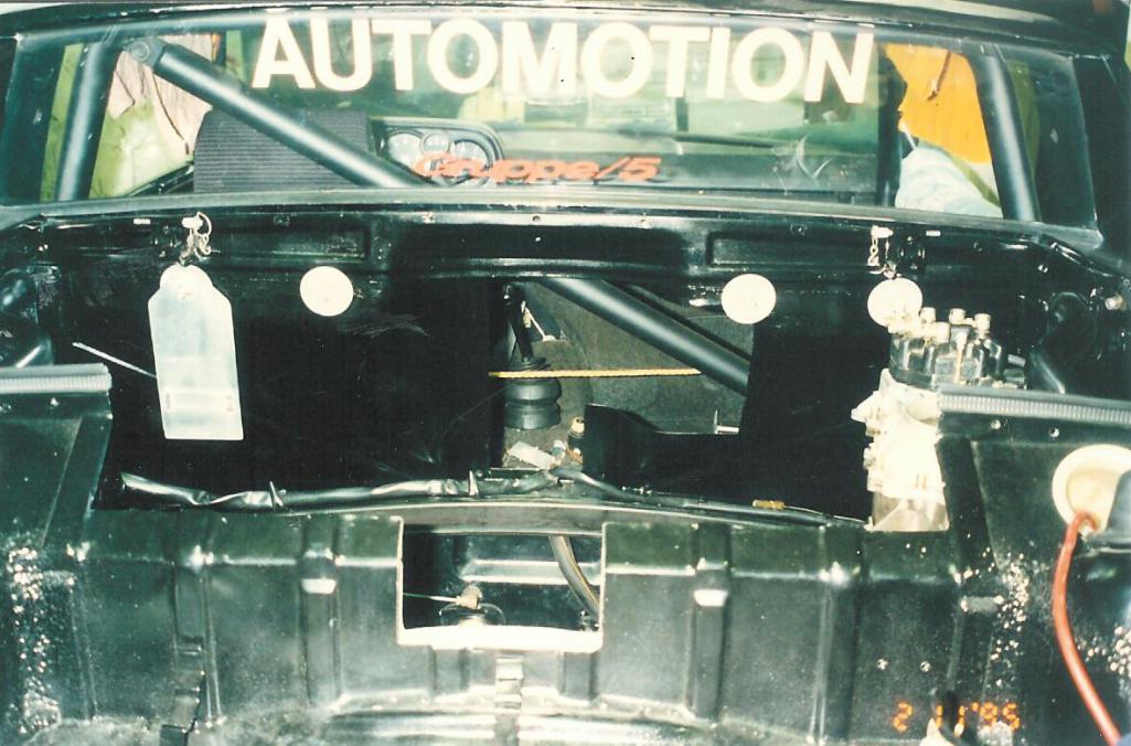

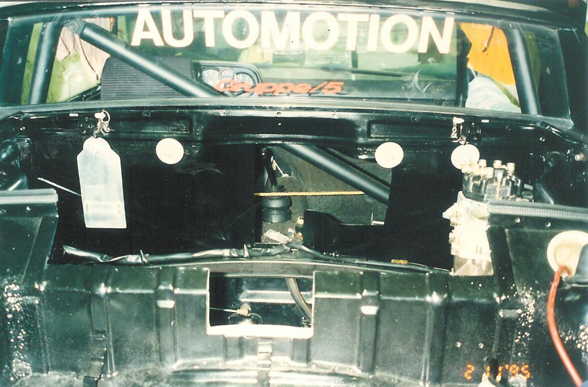

I always like my cars to speak of my personal style, probably the reason I sketch then proceed to hands on building. As far as bodywork, engine +trans, I will work with these craftsmen throughout the project. I don't know if my work is outlaw, but just coming from the need for speed and then creating it on my vehicle.
Then there's the first cut into metal, you need to be an outlaw to start cutting on your perfectly good car (IMG:style_emoticons/default/blink.gif)
Work started on this build in 1988.This pic from 1995, I've already got the firewall shaped for the 935 horizontal fan housing and its accompanying top-right mounted alternator.
The alternator pulley enters the cabin by 1", so a custom cover plate was shaped as well. 930 fuel distributor is mounted to the battery tray. The trunk cutting is for intercooler tubing and the throttle body- to- plenum area.The flat aluminum plate is a bracket for the catch can. Attached Image
