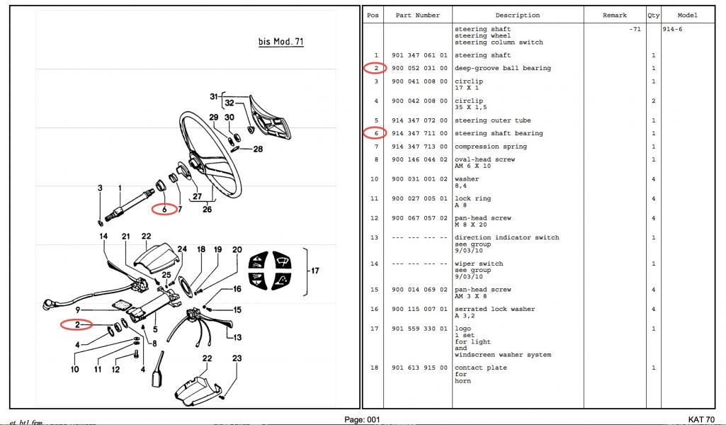

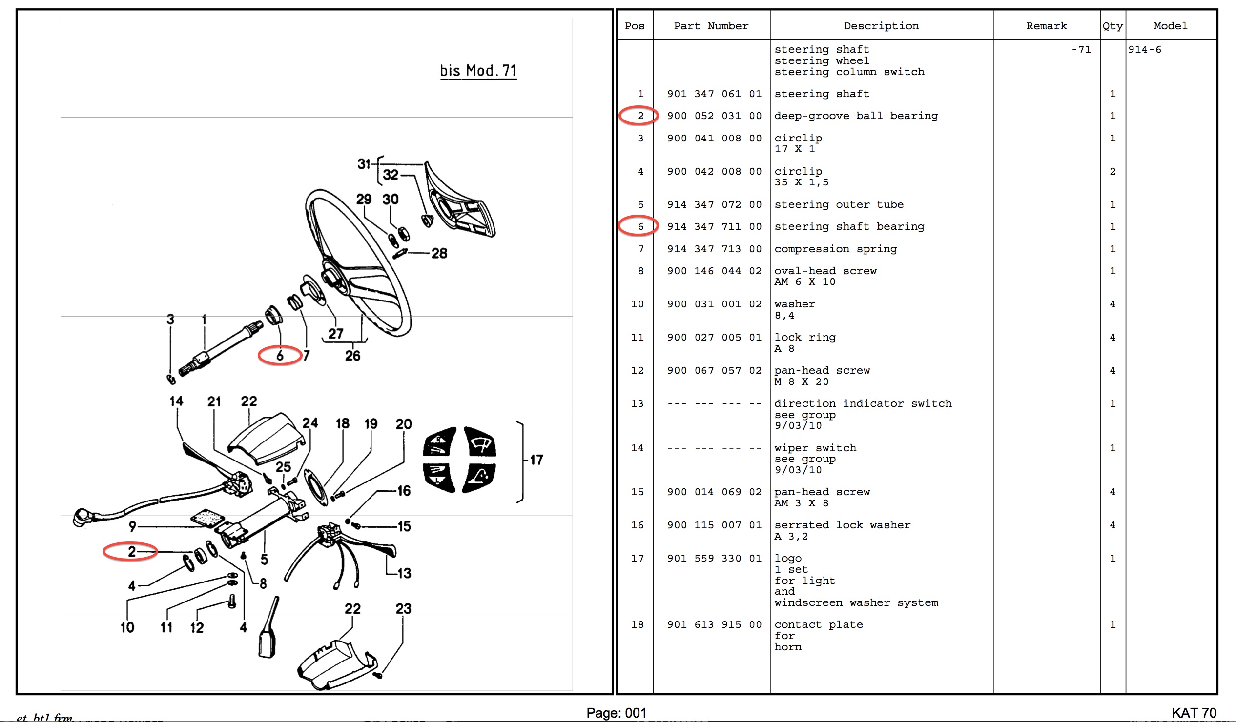

Lookie here (2) and (6)

jim_hoyland   Got a question: I have two bearings, the larger be...   Oct 27 2016, 05:11 PM
euro911   Lookie here (2) and (6)   Oct 27 2016, 05:56 PM
jim_hoyland   Hmmm.....looks like The Who assembly would have to...   Oct 27 2016, 07:35 PM
euro911   I only replaced the one closest to the steering wh...   Oct 28 2016, 01:38 AM
