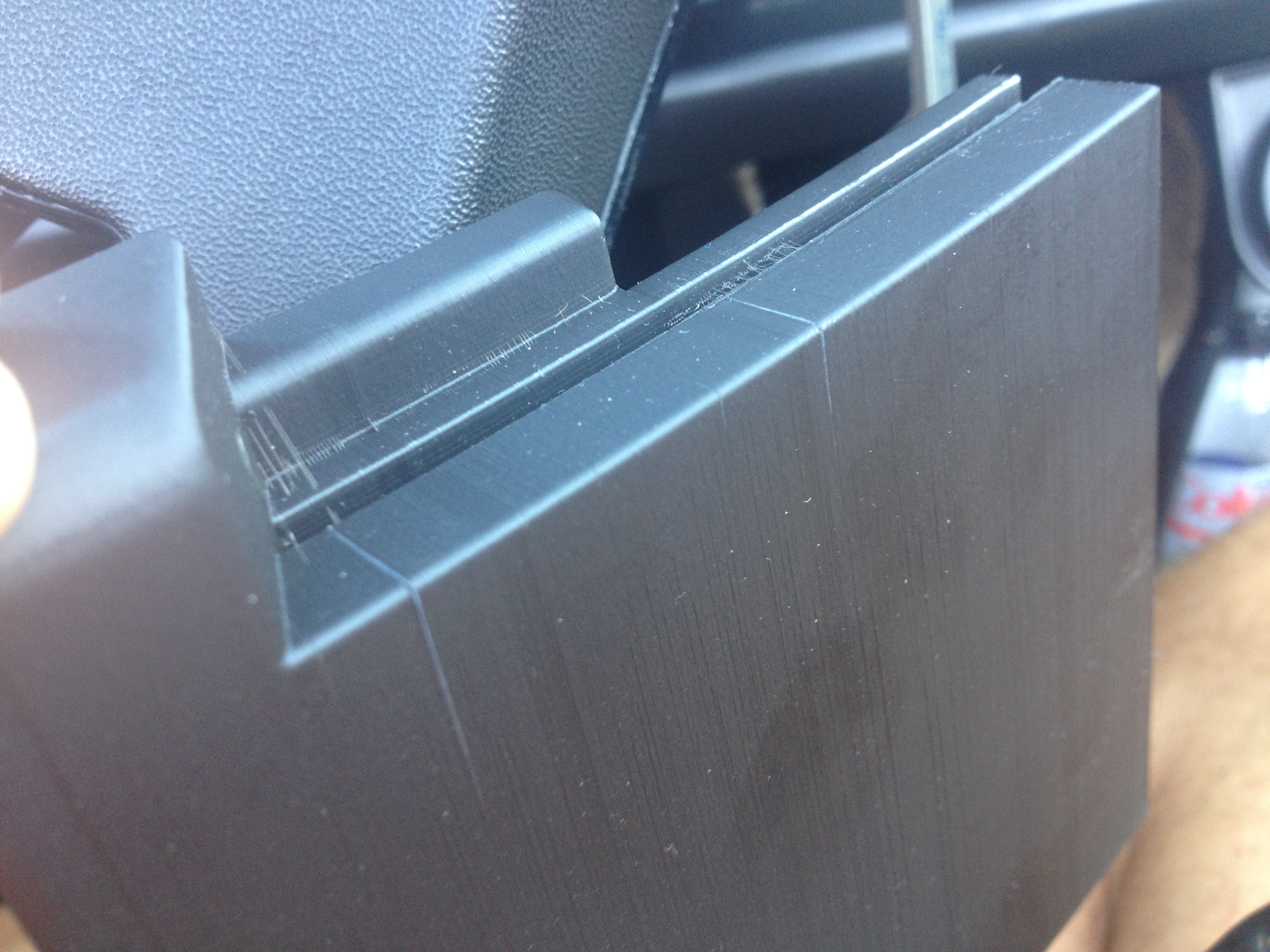

I know NOTHING about 3D printing or the material. But can anything be done about the cracking? I know these are just fun prototype type items. But it is super useful. I really do like it. I wonder about the one you sanded and painted. Is it holding up? Maybe a paint job will stop the cracking.

QUOTE(malcolm2 @ Jul 9 2017, 06:44 AM) *
The material is ABS plastic so a tiny drop of acetone or plastic model glue will dissolve the plastic a bit and fuse it together. Painting them tend to make 3D prints a tad stronger as the paint will help the layers adhere to each other better. Hope that helps. Let me know if you need more help with it.
