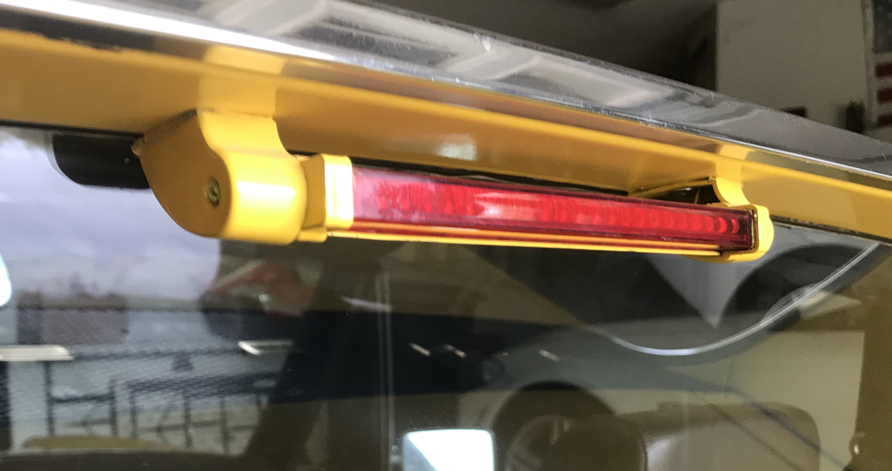

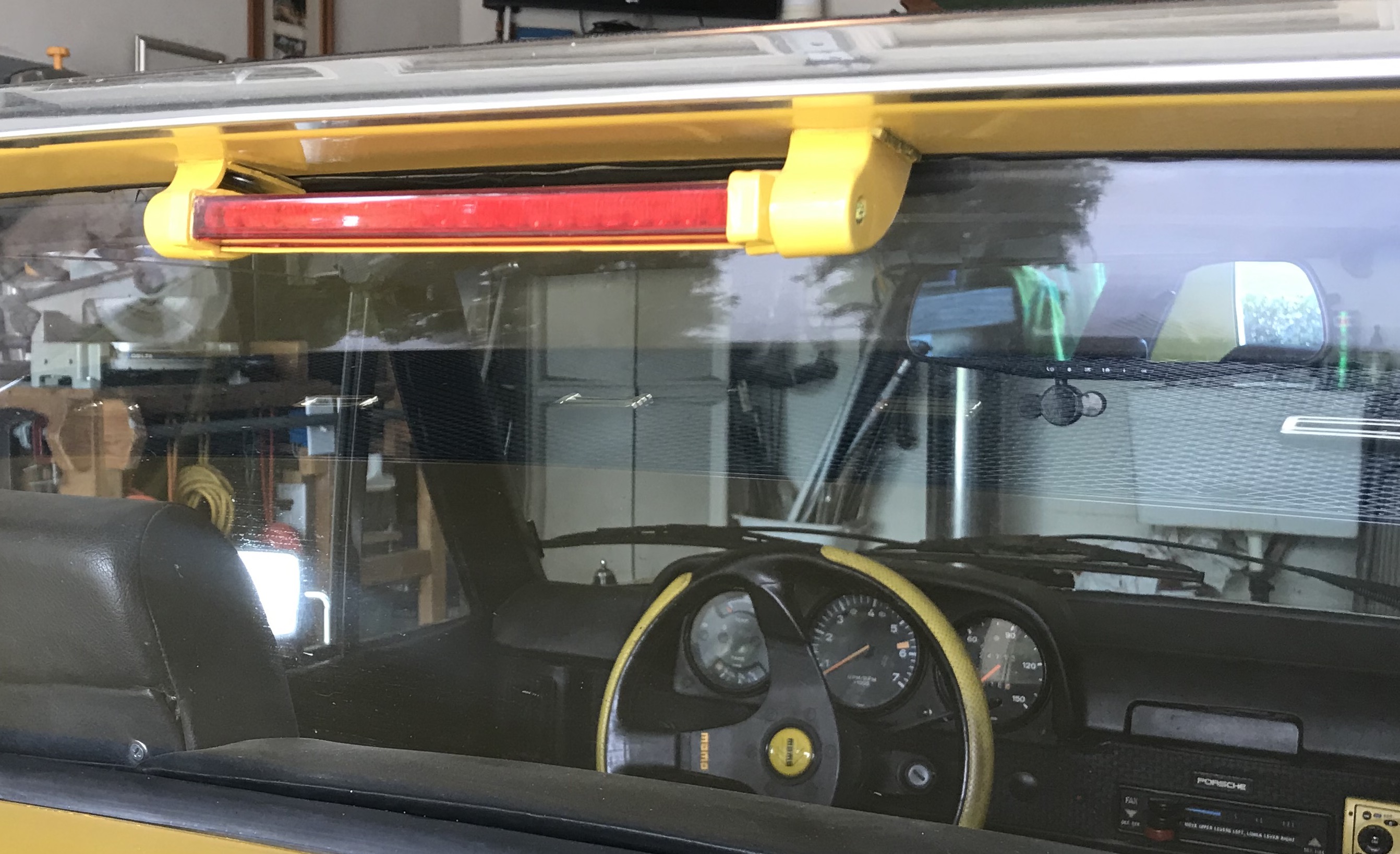

drem914   Finally finished up my install yesterday. A sim...   Oct 10 2021, 01:21 PM

FlacaProductions   Thanks @drem914 - smart install. Those led stri...   Oct 11 2021, 02:37 PM
