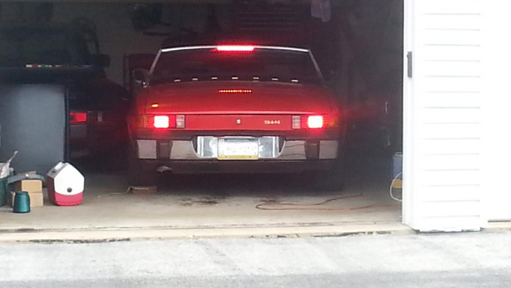

drem914   Finally finished up my install yesterday. A sim...   Oct 10 2021, 01:21 PM
Chris914n6   Finally finished up my install yesterday. A simpl...   Oct 11 2021, 01:44 PM
FlacaProductions   ok - this is pretty brilliant (so to speak...) wha...   Oct 10 2021, 06:41 PM
drem914   ok - this is pretty brilliant (so to speak...) wh...   Oct 10 2021, 08:33 PM

FlacaProductions   Thanks @drem914 - smart install. Those led stri...   Oct 11 2021, 02:37 PM
