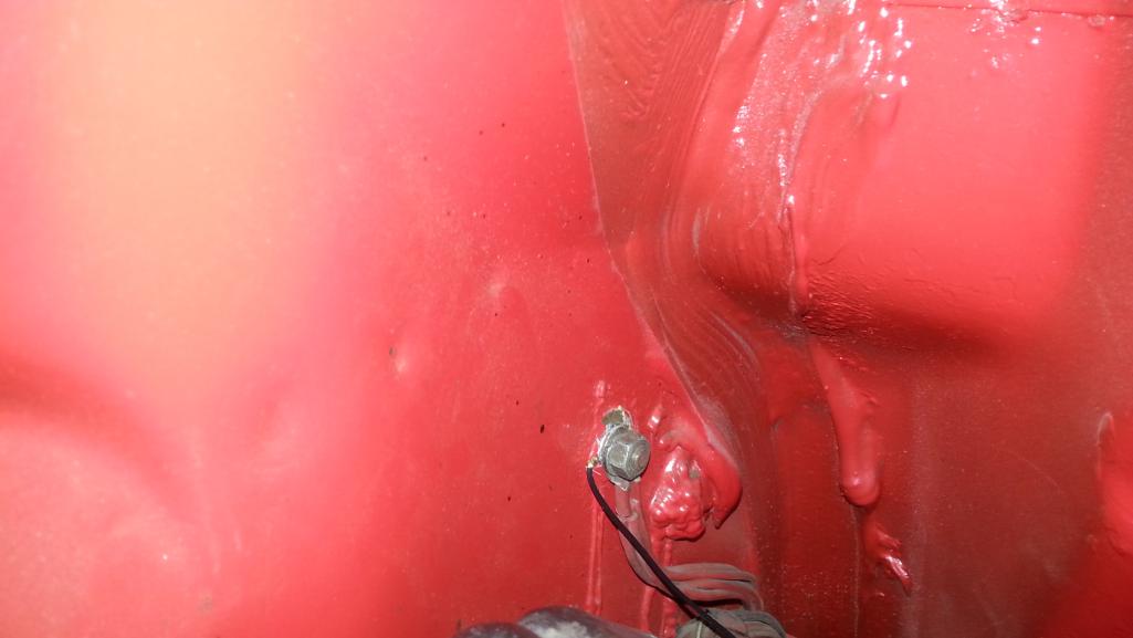

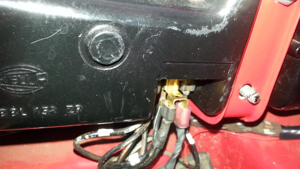

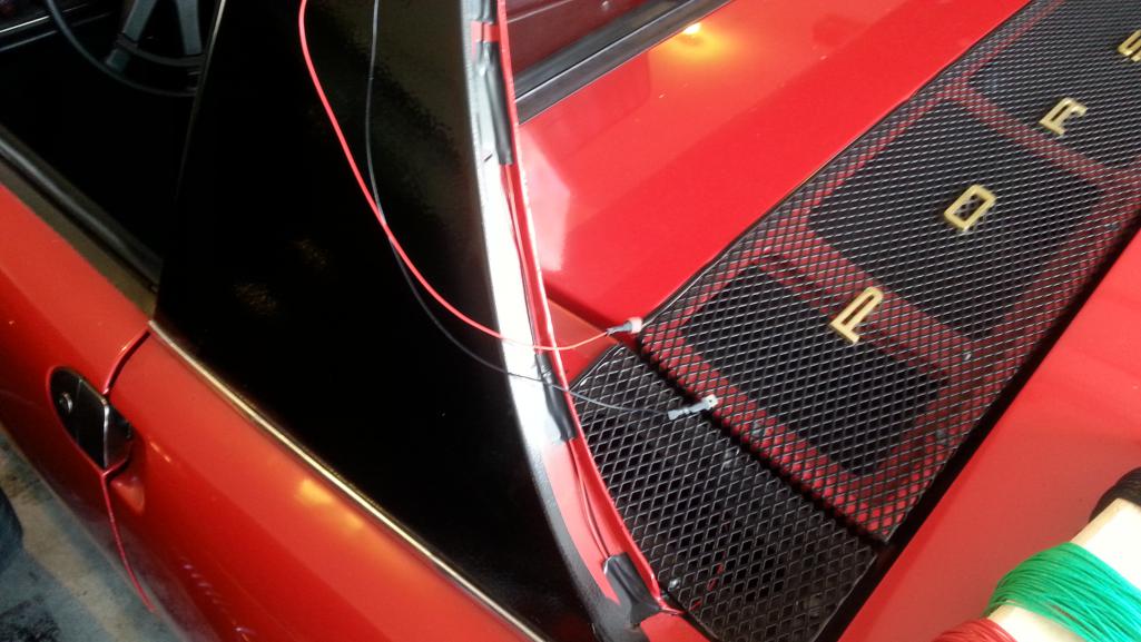

One thing I have thought about making is a pigtail with or without a flashing module that would help to wire a third brake light onto the roll hoop or engine lid. This is what I did with my 914.
On my 914 I stole power from the driver side rear light bucket using a Y-spade connector.
For ground I used a ring terminal and attached it to the ground stud behind the relay board.
I ran the power and ground wires up the sail panel under the trim and over to the 3rd brake light.
