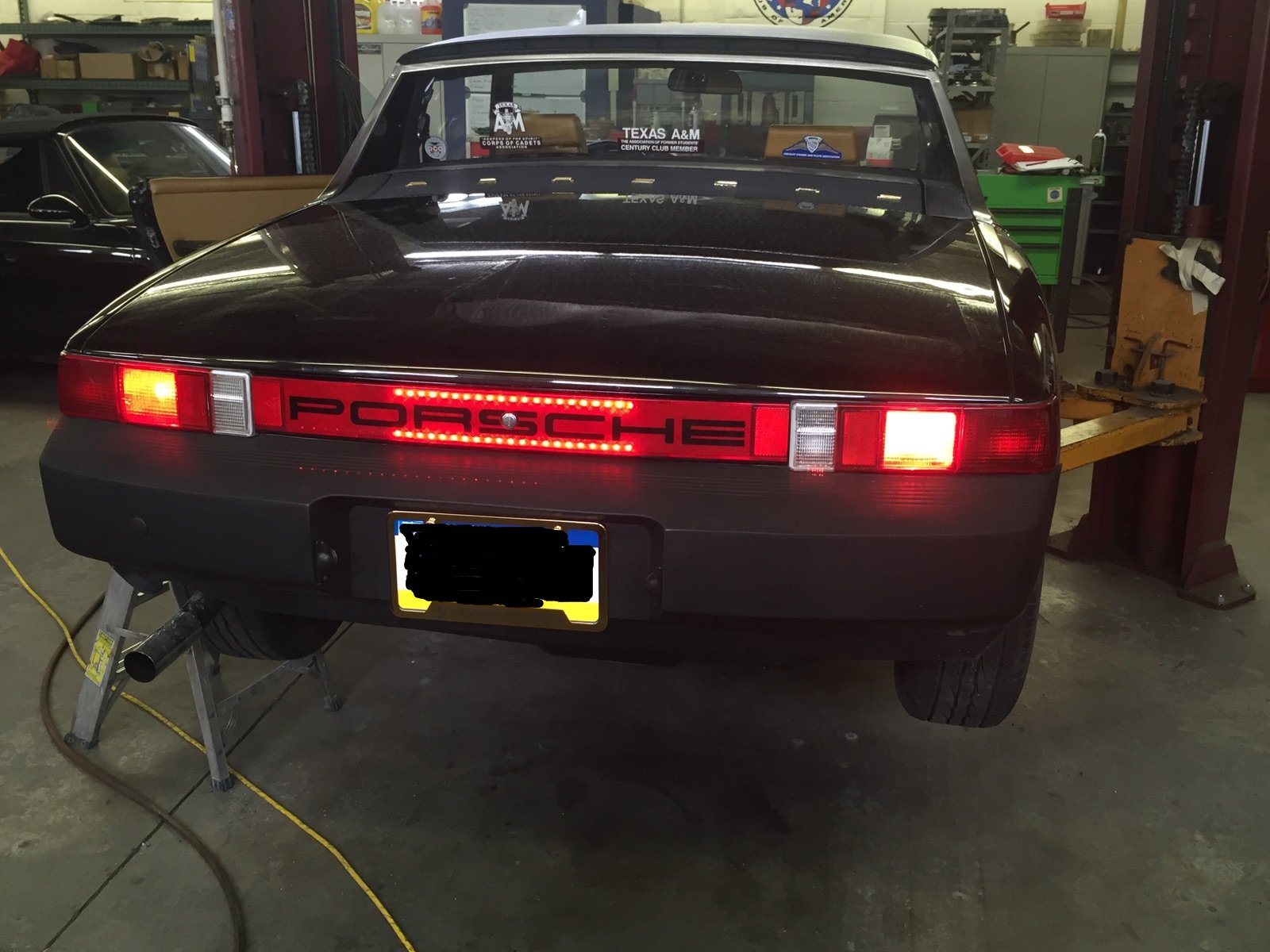

Reacting to the awful rear end collision reported this week here on World, I think a third brake light install is a low cost serious safety upgrade, Here is a question for SPOKE, how about suggesting or better, supplying a "blinking" relay(?) to wire in series with a third brake light power supply? Thus always, but only making the third brake light "blink' when the brake light is on via the brake pedal, to get the attention of these idiot texting drivers.

I was thinking about doing the same thing. I had an idea, that I might put in the rear reflector panel. It appears that the panel itself is red, and that there is a coating on the back of it. I was thinking that all I had to do was get the coating off somehow, then wire up the lights. Also, put a row in the upper strip on the sail panel, can't be too safe.
That's what I did. I later added the flashing module, which I think should add to its visibility. Yes, I know, it's not up high, but the car had the center reflector when I bought it, and this solution was better than nothing.

drem914   Finally finished up my install yesterday. A sim...   Oct 10 2021, 01:21 PM
Chris914n6   Finally finished up my install yesterday. A simpl...   Oct 11 2021, 01:44 PM
FlacaProductions   ok - this is pretty brilliant (so to speak...) wha...   Oct 10 2021, 06:41 PM
drem914   ok - this is pretty brilliant (so to speak...) wh...   Oct 10 2021, 08:33 PM

FlacaProductions   Thanks @drem914 - smart install. Those led stri...   Oct 11 2021, 02:37 PM
