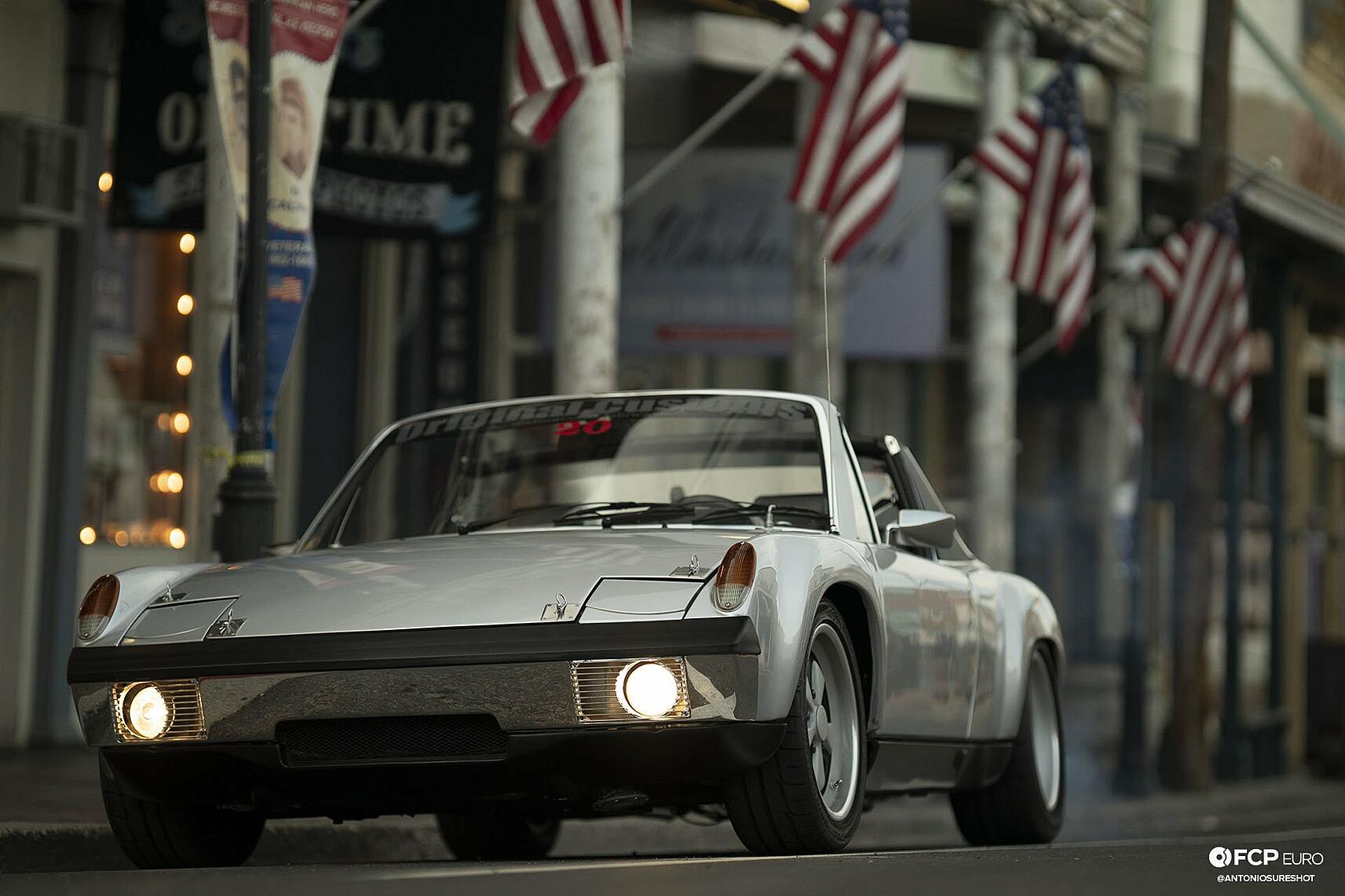

Pic for Attention-

Jay Wellwood   FWIW - the pic I posted isn't my Car - but rat...   May 3 2020, 10:13 AM
