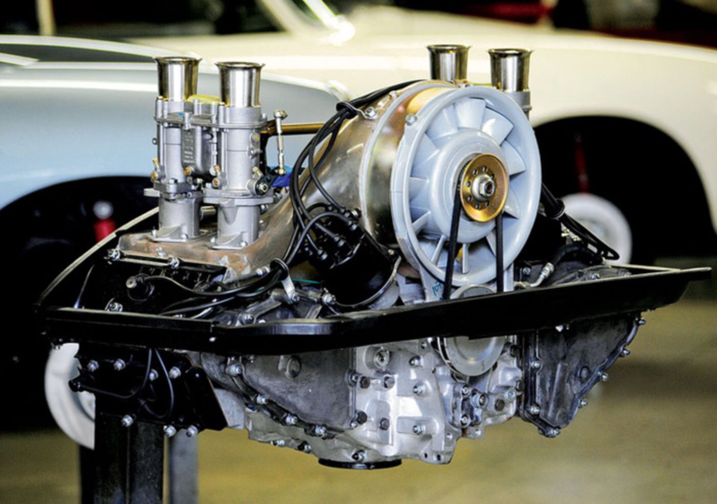

Fun question. One I've thought of a lot. I'd take a '70 914/4, light ivory, with the /6 suspension and Fuchs. Powered by a Polo 4.

That would be interesting.... the Polo motor was built for the 356 but I don't see why it couldn't be put in a 914.
If you have the bucks, just buy a 356 Carrera 4 cam motor and put it in a 914. Add Megasquirt EFI to make it perform better.
Then take it to Parade and watch the 356 guys have seizures when they look in your engine compartment. (IMG:style_emoticons/default/happy11.gif)
