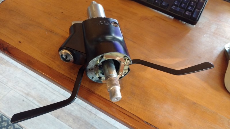

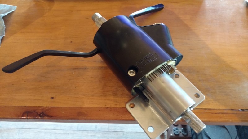

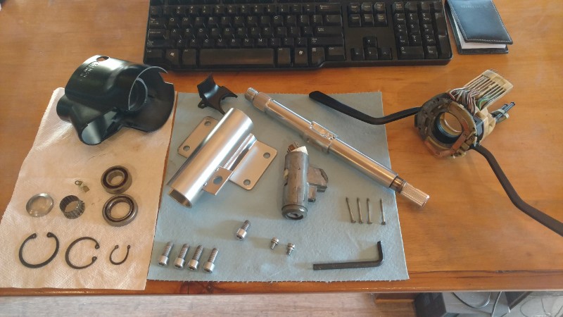

Couple pics of mine that I just finished...
Hope it helps...
