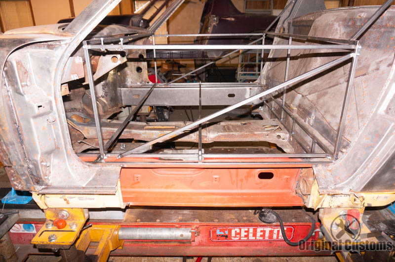

rgalla9146   Your car has great potential but needs much care. ...   May 9 2021, 06:24 PM
SirAndy   It is advisable to stabilize the door openings (a...   May 10 2021, 11:20 AM
KBMC1304   Your car has great potential but needs much care....   May 10 2021, 03:52 PM

jcambo7   With no door bracing from what I can see, what are...   May 20 2021, 02:13 PM
SirAndy   With no door bracing from what I can see, what ar...   May 20 2021, 02:22 PM
KBMC1304   With no door bracing from what I can see, what ar...   May 23 2021, 05:33 PM
SirAndy   http://www.914world.com/specs/bodydims.php http:...   May 20 2021, 02:25 PM
wonkipop   http://www.914world.com/specs/bodydims.php http...   May 20 2021, 05:01 PM
KBMC1304   http://www.914world.com/specs/bodydims.php http...   May 23 2021, 05:33 PM
