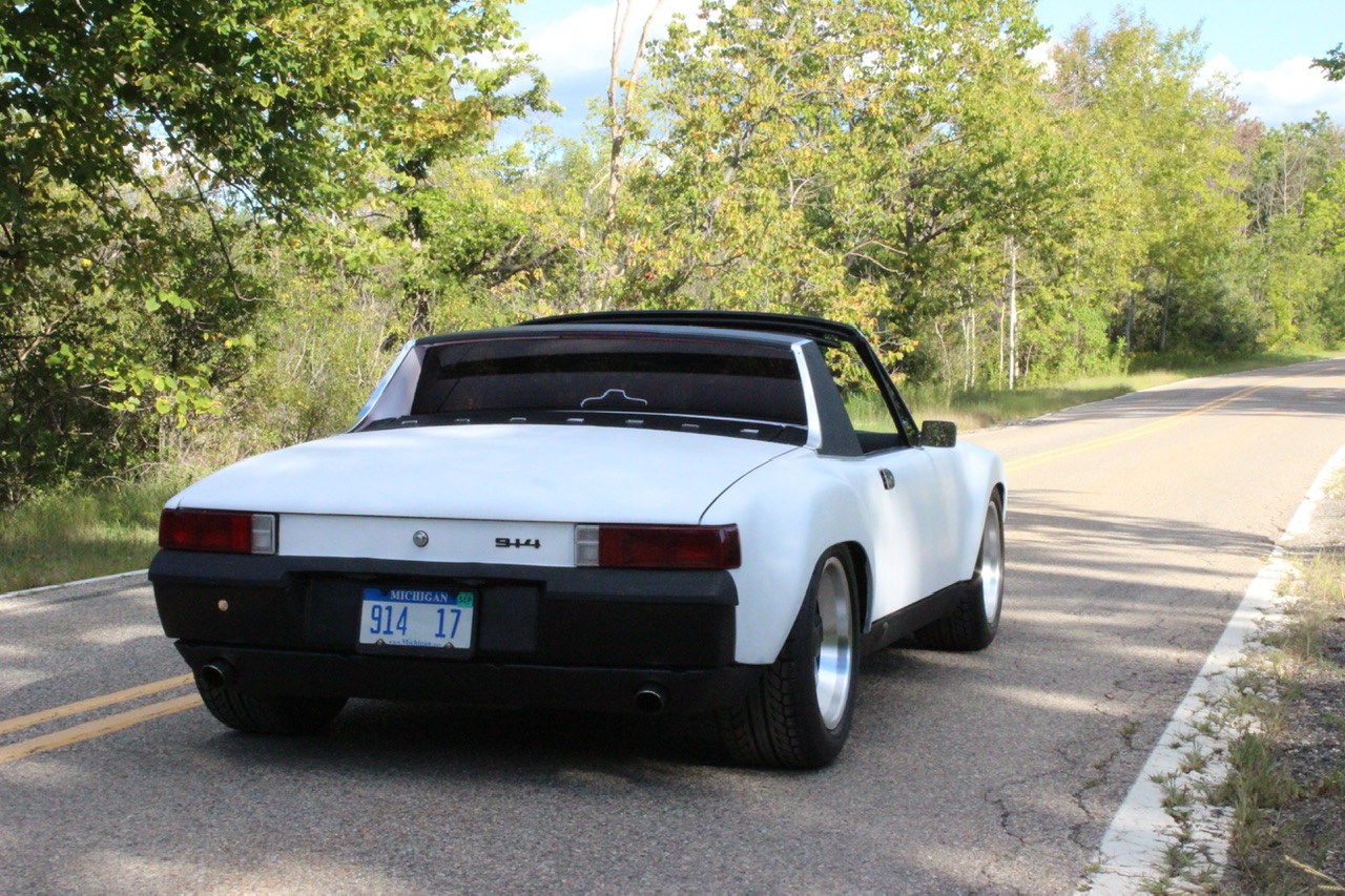

(if i did it again the only thing I would change, frt's 1/2" more foward) Running 9x16 on all 4 corners. Messure 10 times, and cut 1 time. I fit and welded mine before I had the wheels and tires. I focused strongly on the size of the tire space being equal, and distance from the hubs, using all of the flare, not just the outer look. Welded all 4 on.
Then I got the wheel and tire size to fill the rear space. buying the rear set first, using them to check turning clearance on the front. The 9" fit! Got 2 more.
Some say fit the flare to the wheel and tire. Using the tire as the guide, this will work also as a starting point. If you know the wheel and tire size you want to use. That was my biggest question.
Michigan Build
And one more link with lots of pictures :
Pictures of oversized wheeled cars
And,
My 73 Michigan Build, wheels 9x16, 245/50-16 tires on all 4 corners.
