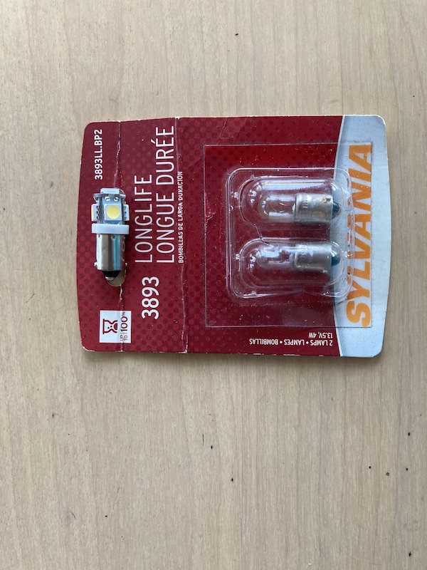

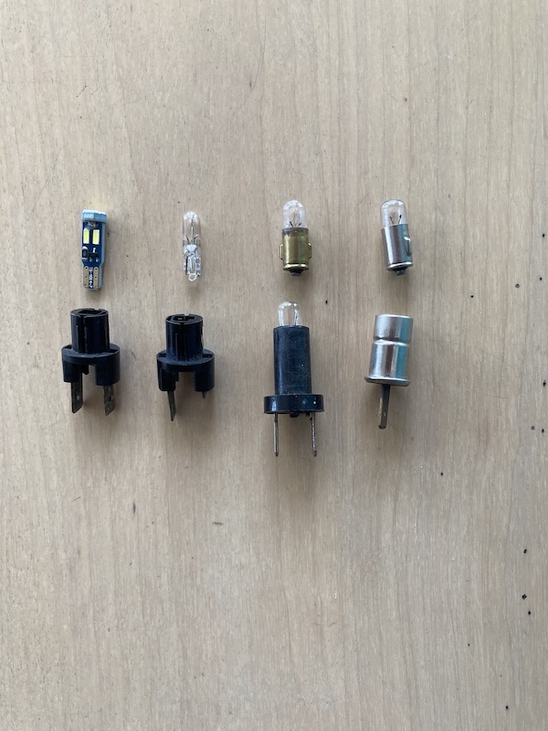

For gauge lighting, there are 4 different bulb holders OEM. 2 are body ground & other 2 are remote wire ground
I've converted to LEDs for all but the flasher bulb.
Here's some examples, got them off Amazon or somewhere.
