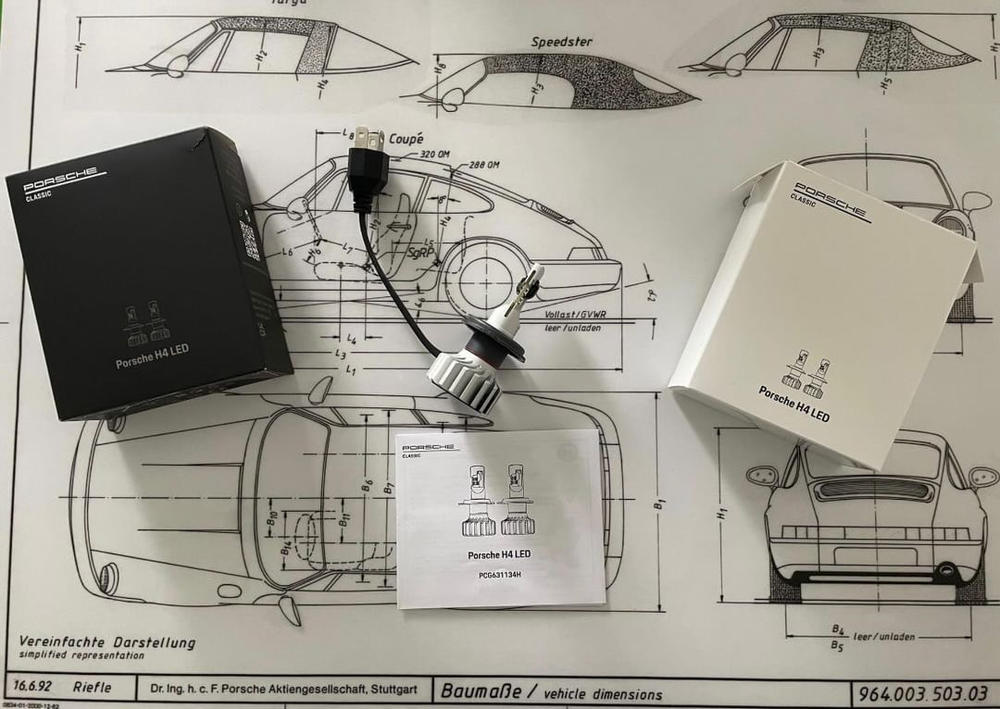

Porsche is now selling a plug in h4 led bulb.

mepstein   Porsche is now selling a plug in h4 led bulb.   Oct 21 2023, 07:24 AM
