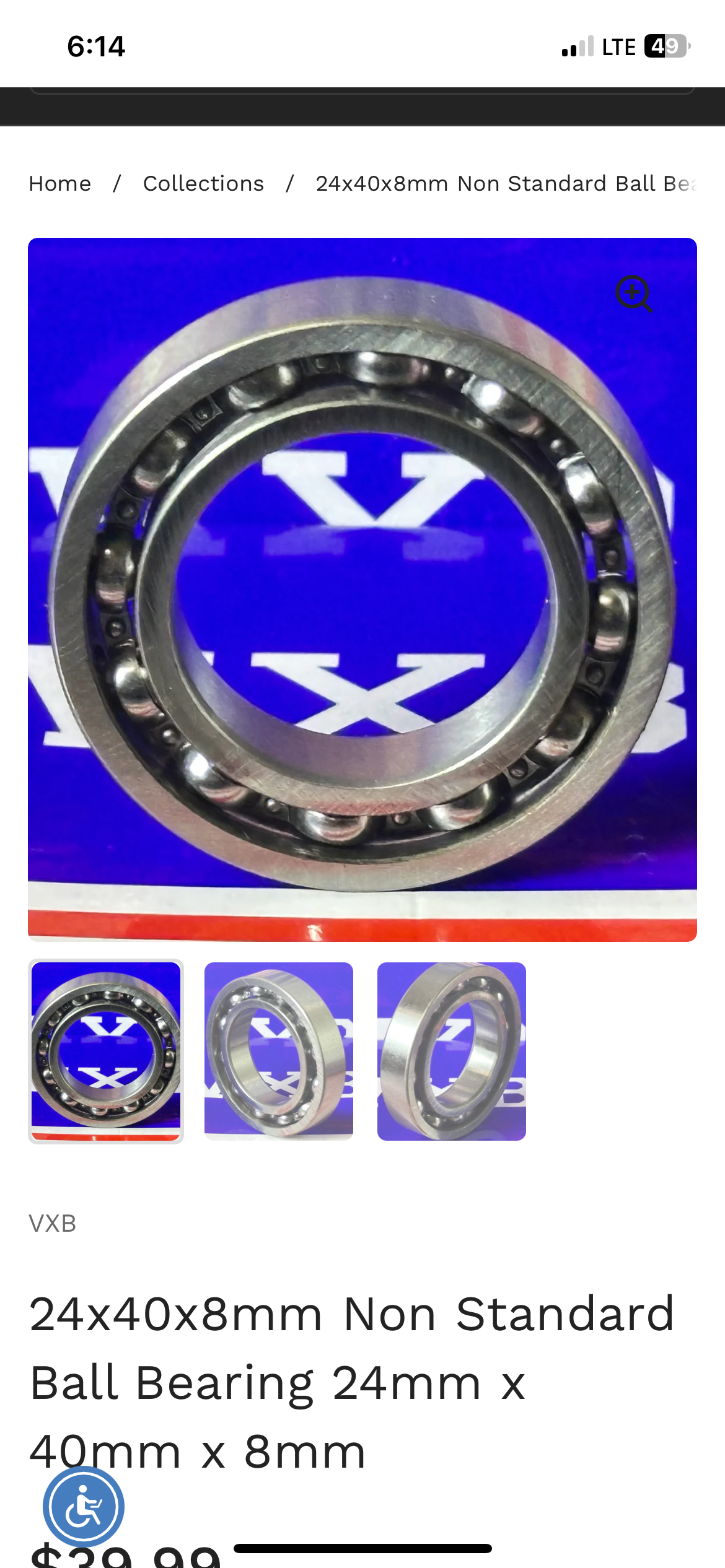

Both bearings lower and upper are still available. The part numbers are in the picture. The original bearing has a plastic inner layer. This allows the bearing to flex more than I cared for. After replacing both bearings and putting the steering column back together, it still had way too much play for my liking. When I purchased the car, the PO had used a sleeve to fix it sometime in the past. It’s a good thing I didn’t throw it away, because I ended up using it. After much searching on the Internet, trying to find a bearing to fit the shaft made of steel with no plastic, it was impossible. The original bearing is 22x40x8mm. After more searching I found a 24x40x8mm steel quality VXB bearing that cost me 40 bucks. When used over that sleeve my steering now is super tight with no deflection. So if you’ve done this change out of new bearings, and you’re not satisfied… This is the way to go!
