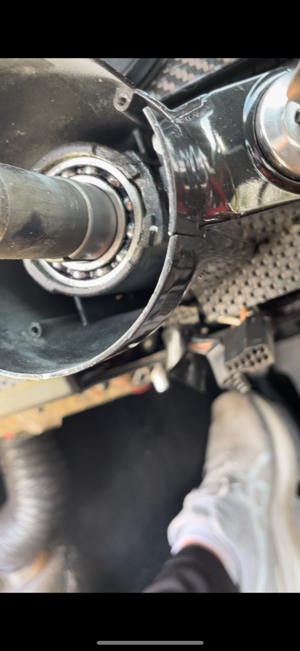

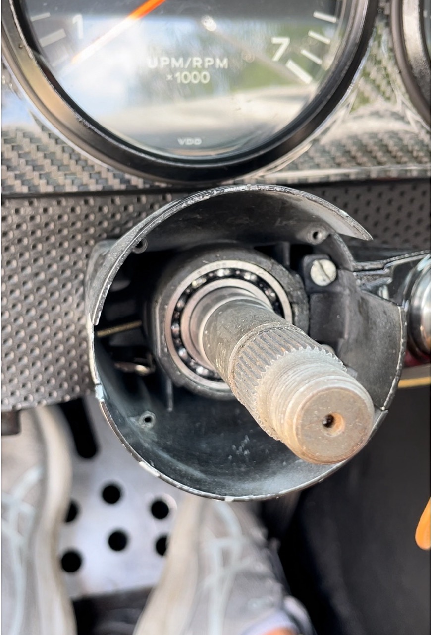

Yes….if you use that sleeve that is offered on many Porsche websites it takes up the 2mm’s needed to fill when using that VXB bearing that is all steel. It is a Much better fix than the one offered as a stock replacement. It has a plastic insert with tiny little plastic teeth that surrounds the shaft. So when you multiply the distance from the bearing to the steering wheel, it stills has too much play. The sleeve and steel bearing are tight with 0 deflection.
