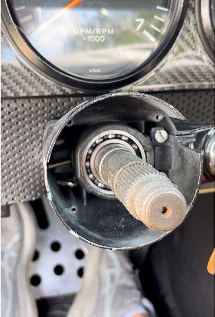

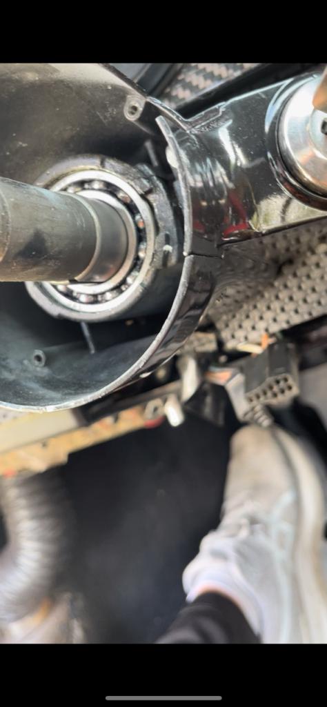

Yes….if you use that sleeve that is offered on many Porsche websites it takes up the 2mm’s needed to fill when using that VXB bearing that is all steel. It is a Much better fix than the one offered as a stock replacement. It has a plastic insert with tiny little plastic teeth that surrounds the shaft. So when you multiply the distance from the bearing to the steering wheel, it stills has too much play. The sleeve and steel bearing are tight with 0 deflection.

Thanks for the clarification. When I took my car apart it had been put together just as you have described/pictured. It was very loose, from old age deforming the plastic race.

So does the bearing I gave a part number to, it bites into the shaft with no need for a bushing. Both methods will eventually loosen up again as the plastic deforms. However, once that happens, I can install the steel bushing and tighten it up, whereas with your method, you can’t. You’re back to replacing everything again, correct?. I guess I don’t see the benefit.
