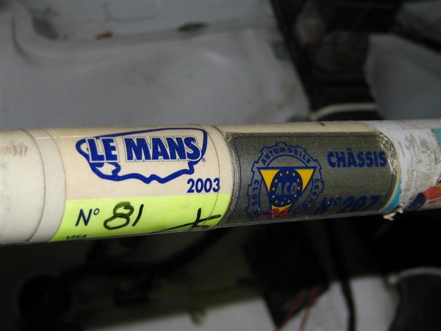

Ya they are out of a car that raced at Le Mans

TimT   Ya they are out of a car that raced at Le Mans   Feb 10 2006, 08:57 PM
SGB   fascinating. I feel like I'm in school again....   Feb 10 2006, 09:31 PM
MattR   A quick google search... thats a TRG car? Do you ...   Feb 10 2006, 09:53 PM
