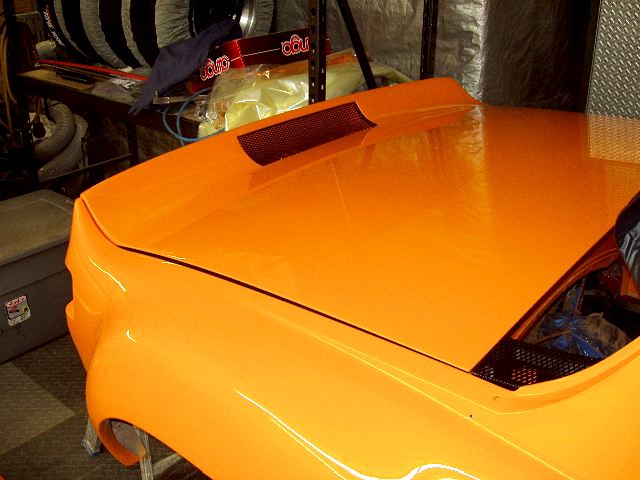

iamchappy   Shots of the front hood....   Sep 22 2007, 12:18 PM
Eddie914   Where did you source the gas filler door? Beautif...   Sep 22 2007, 12:21 PM
Air_Cooled_Nut   Where did you source the gas filler door?... Psh...   Sep 22 2007, 04:00 PM
iamchappy   Where did you source the gas filler door?... Ps...   Sep 22 2007, 09:32 PM
effutuo101   And does it come wiht a lock?   Sep 22 2007, 01:37 PM
iamchappy   Ebay fits a Ford f150 or Mustang, yes they have lo...   Sep 22 2007, 01:47 PM

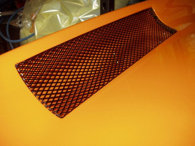

iamchappy   Intercooler duct in rear lid...   Sep 23 2007, 09:14 PM
