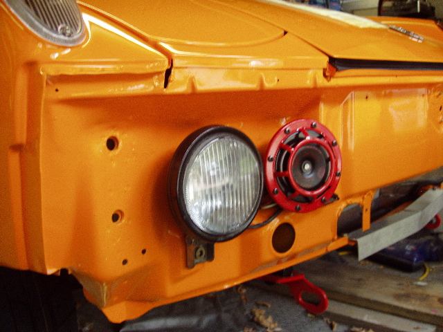

Horns on.
Still waiting for my front valance from the body shop to finish the front end off with the bumper.
I didnt get much done on the car last week but expect there to be major movement getting things put together this week, time is running short up here in Minnesota...
