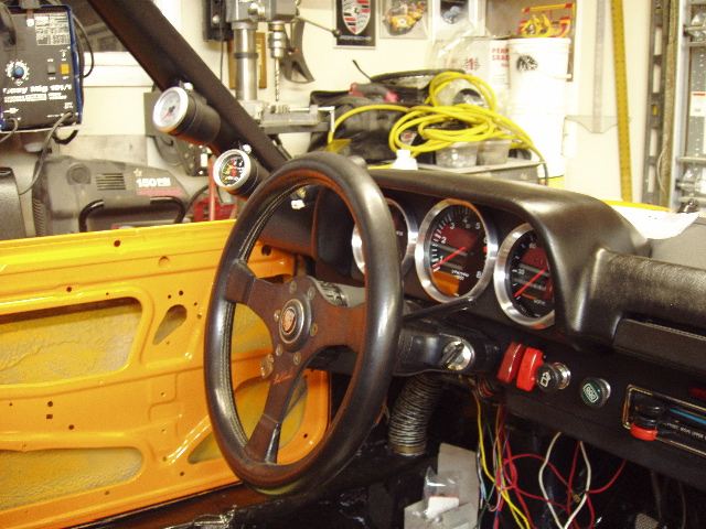

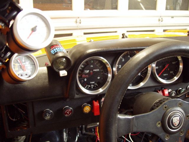

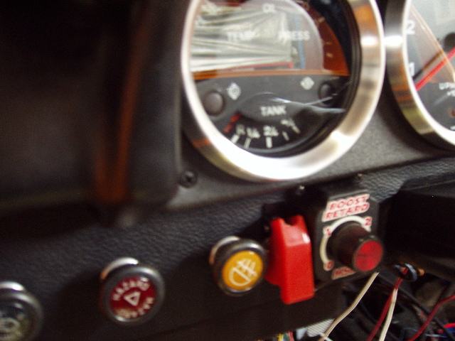

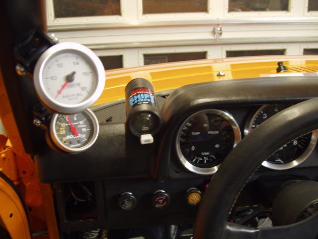

Upper dash, pillar gauges and instrument gauges installed. Yes all those switches go to stuff. Transmission cooler pump, intercooler fans, kill switch, and boost timing retard.
Moving to finish off the lower dash, center console gauges and stereo install and
Engman aluminum pedal and passenger floor boards next.
