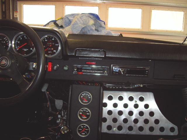

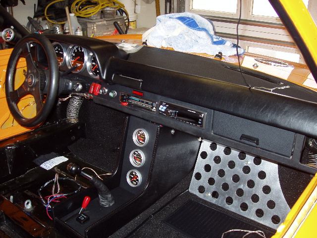

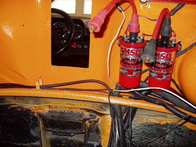

Most of my time has been consumed with cleaning things and cleaning up paint overspray on the wiring, I have a whole new respect for the concourse guys, I hate this type of work it has to be the hardest part of this build.
I did a major cleaning up of the wiring and the connectors and simplified some of the hook ups to the gauges and the stereo. The interior can really come together fast now. The lower dash pad will go on after i get the wiring for the A/R gauge finished up.
All of the new cables are in place, and have a little more wiring on my innovate A/R gauge and relocation of the fuel pump to the front cross member.
I moved into the engine bay for a little while and have more wiring to simplify and clean up.

iamchappy   Upper dash, pillar gauges and instrument gauges in...   Oct 2 2007, 10:14 PM
Blood red 914-6gt   Wow, that is a cool dash/ guage set up. I like tha...   Oct 2 2007, 10:20 PM

iamchappy   Most of my time has been consumed with cleaning th...   Oct 7 2007, 11:51 AM

914-8   what are all the gauges for? (triple gauge in the...   Oct 12 2007, 11:31 AM
iamchappy   what are all the gauges for? (triple gauge in th...   Oct 12 2007, 07:03 PM
