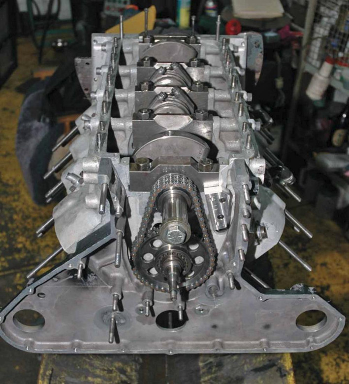

This is the bottom end of the RepcoBrabham block.
Steel caps and cross bolted with a modified y-block skirt.
Billet 4340 crank and rods.
A custom camchain housing was cast up and fastened to the front of the block.
The coolant passages moved from the front.
Beautiful.

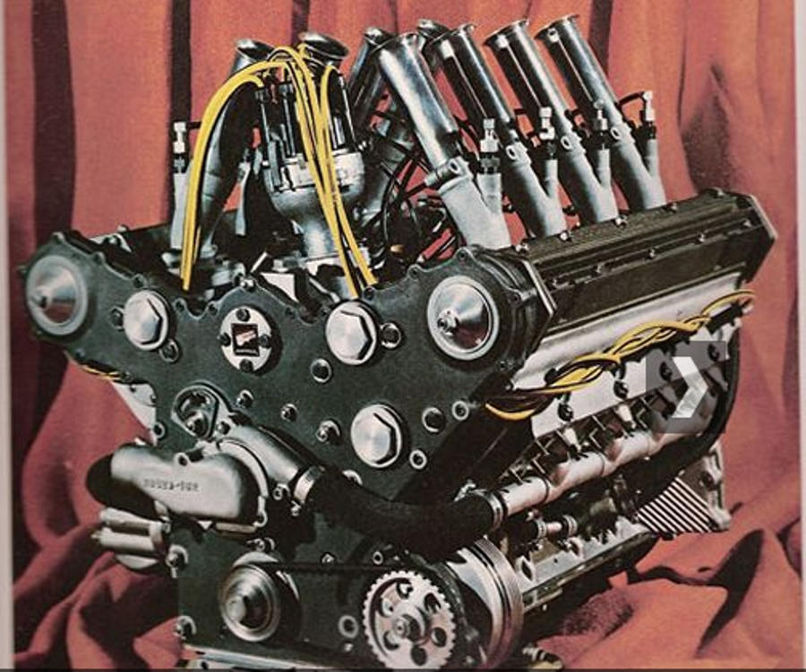

This is the stock Oldsmobile 215 block in 1965 as modified by Jack Brabham.
High stack injection,a dizzy run off the back of the chain drive or a stub shaft in the valley.The waterpump is driven by the stubshaft.
The coolant pipes are brazed tubing directing water to the block and heads.The drysump scavenger pump is driven by a Gilmer belt.
Some of these ideas are suitable for a shorter engine length to fit more easily in the 914 bay.
A transverse installation is also possible with a wide selection of FWD gearboxes both auto and manual for cheap.

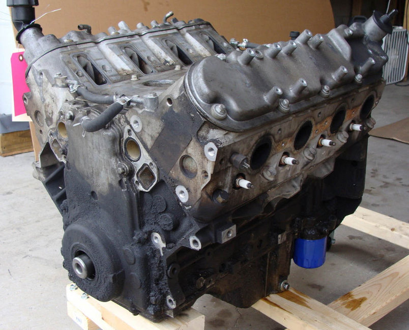

04-LS1-GTO shaved of the ancillaries will fit nicely with room for a damper,shorter than stock.
Piping will be necessary to the coolant passages,welded tubing to a remote pump,driven by a jackshaft perhaps.
The deep pan will be discarded for a dry sump system.The ancillaries driven by a serpentine belt.
A plan to install an engine for your highpowered 914 must be just that a plan,making drawings of parts to fit.
Stretching the wheelbase is an option if a custom 914 is considered.Part of a plan.
A modification of the suspension to suit the changed CG and CM likely be necessary to suit those changed conditions.
Is it possible to fit an LS1 without cutting the firewall front and rear?Maybe,a tape measure is handy.
