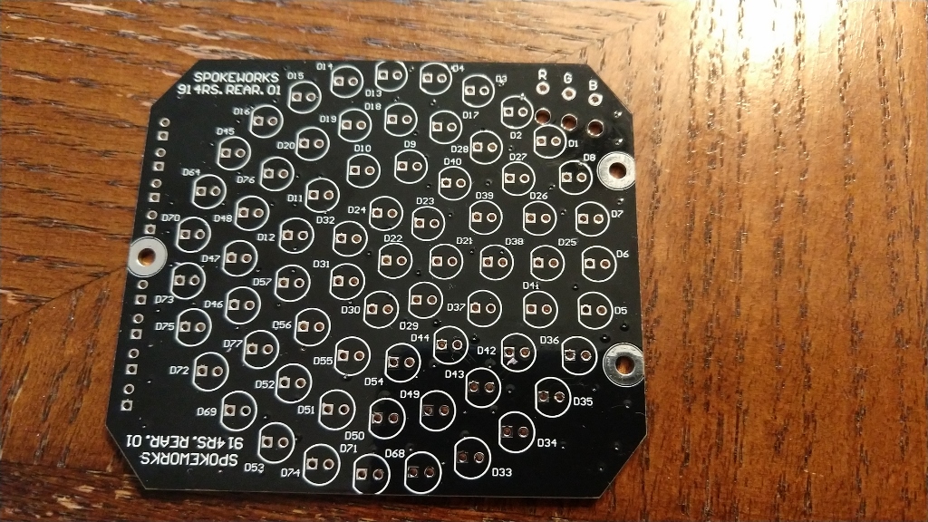

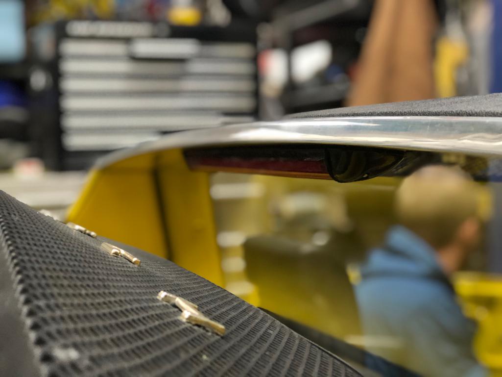

After chatting with Bob, I decided to look into making a kit using the 12 inch LED strip hung under the chrome strip. It will also have a provision for adding a strobe flasher. I've got to figure out a way to attach the LEDs without much modifications. I had to file a bit of the chrome strip and Bob drilled and used a screw to hold the LEDs.
Also looking at the picture and his brake lights and license plate, I started working on this board. Anybody interested in it.
When I see the small strip of LEDs on the side of the board above, I wonder: How thin could a third brake light under the targa bar be? Could it get close to invisible?
If so, I'd be in…
Need to pull the trigger on Spoke's rear brake lights. Tempted by his other stuff but a love of the old incandescent glow stops me short on the front running lights and turn signals. Having already been rear-ended once, back in 1995, brake lights are another matter…
Jerry - I'll buy whatever you make. (IMG:style_emoticons/default/beerchug.gif)

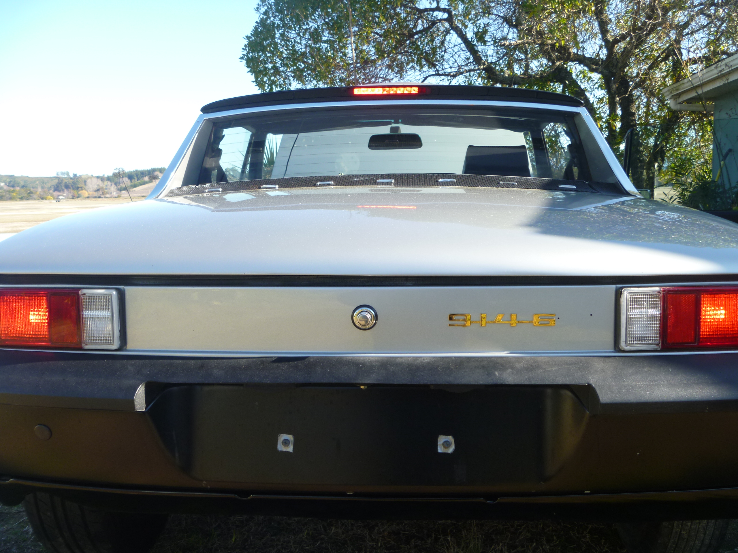

Mines a Hella unit which the PO had fitted into the roof ,why I don't know ?,my solution to power it was a small 2 pin plug mounted above the seatbelt anchor,unplugs easily when removing the roof.
Got the round pattern boards in. Will have to build up a couple of sets. Will give a set to Bob for his 914RS car.

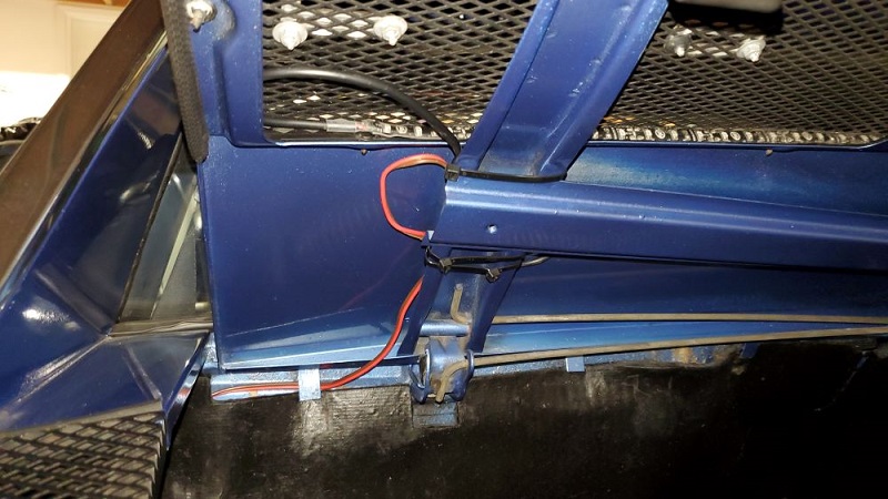

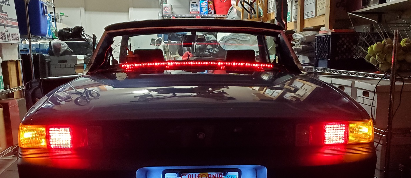

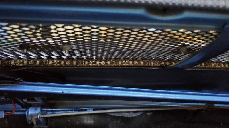

Finally finished up my install yesterday. A simple install of a 36" weatherproof red LED strip. No drilling or targa bar dis-assembly required. Full stealth install as the strip is black and resides just under the under the deck grille until it lights up. Facing straight back to the trailing driver. Previously did the Spoke LED brake lights a couple years ago.

ok - this is pretty brilliant (so to speak...) what LEDs did you use - any more pics of the install?

QUOTE(FlacaProductions @ Oct 10 2021, 05:41 PM) *
Here are a couple shots from the underside. Still need to clean up the wire management a bit. wire heads back to rear left brake light along wire harness for connection to power and ground taps. The strip https://www.superbrightleds.com/moreinfo/cl...redirect_disc=0 is currently discontinued by superbrightleds.com. Might be able to be found at another supplier.

QUOTE(drem914 @ Oct 10 2021, 12:21 PM) *
You beat me to it. I've been searching for a led strip to do the same thing (IMG:style_emoticons/default/aktion035.gif)
I think it would be more visible to SUVs then the under targa light.

Thanks @drem914 - smart install. Those led strips are pretty ubiquitous and can be found many places. the black pcb/tape is nicely done.
