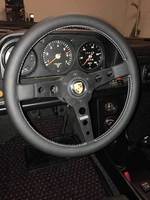

For my 1971 914-4, I ordered one of these from Classic Garage:
http://classicgarage.com/s5904.html

QUOTE(BuddyV @ Mar 6 2017, 10:11 PM) *
What is the Momo hub model # for later cars... .say, a 1975?
I may be looking for one soon. Is that hub still being produced?
I just put one on my '73. Bought the momo hub (8002) and prototipo wheel from Amazon. Shipping was free with Prime.
