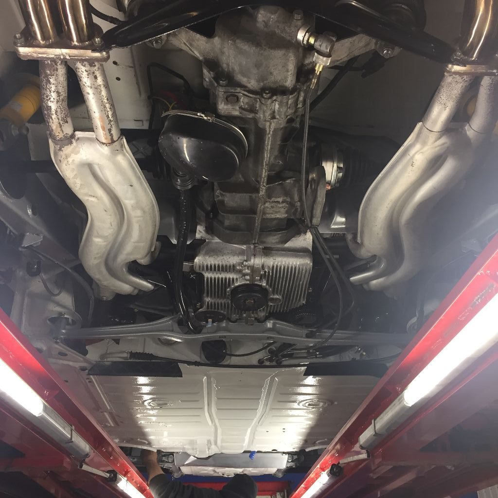

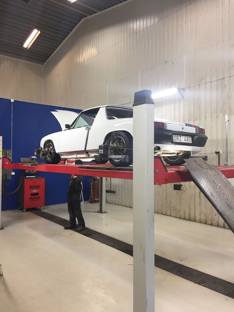

(IMG:http://www.914world.com/bbs2/uploads_offsite/matsgarage.com-15176-1492799155.1.jpg)
Waiting for our turn....

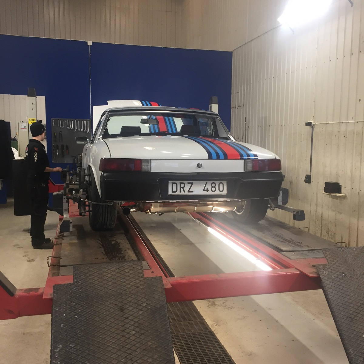

(IMG:http://www.914world.com/bbs2/uploads_offsite/matsgarage.com-15176-1492799156.2.jpg)
Going for an elevator ride, checking suspension movement, wheel bearings, brakes, rust and everything else. All lights, had to adjust the passenger headlight a bit to get it correct.

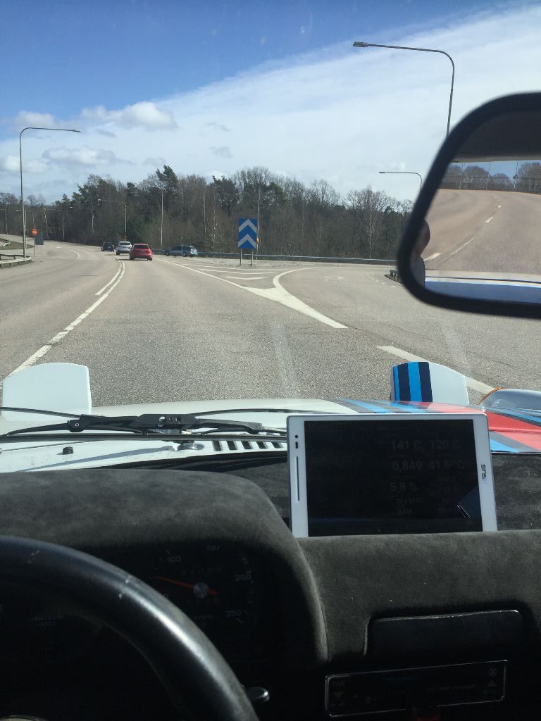

(IMG:http://www.914world.com/bbs2/uploads_offsite/matsgarage.com-15176-1492799157.3.jpg)
Driving home again, the tablet displays my rpm, lambda value, CHT values, fuel trims and anything else I want to see from the ECU.

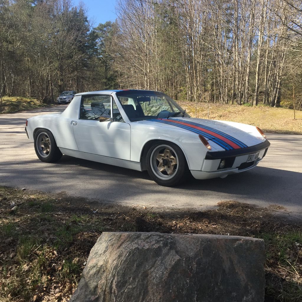

(IMG:http://www.914world.com/bbs2/uploads_offsite/matsgarage.com-15176-1492799158.4.jpg)
Took a litle break for some photos before we went home. Still got a silly grin on my face. (IMG:style_emoticons/default/biggrin.gif)

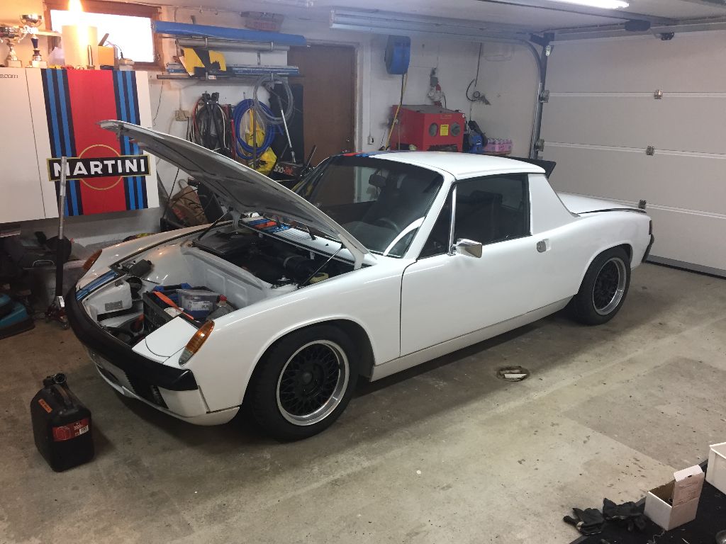

(IMG:http://www.914world.com/bbs2/uploads_offsite/matsgarage.com-15176-1494524706.1.jpg)
Been dealing with the alignment issues for the last three weeks.
No matter how I elongated the mounting holes for the outer bracket I couldnt get toe in.
Weekend two weeks ago I snapped and demounted both rear trailing arms, putting them side to side revealed the left one being 5 mm longer from the pivot axis to driveshaft center. Found the culprit!
(IMG:http://www.914world.com/bbs2/uploads_offsite/matsgarage.com-15176-1494524707.2.jpg)
Ordered a used trailing arm from Germany, got it friday last week. Tore it apart after work and then drove to my blaster/powdercoat guy an hour away the same evening and got it painted and pretty. Managed to get my spare hub machined for 5 bolts for to use longer studs Got that fixed early this week and tuesday and wednesday I got the suspension back on again.
Today thursday I had booked an alignment, This time I had 4 degrees of toe IN on the rear left wheel. Sucess!! We adjusted it out to 1 mm toe in and that was that.

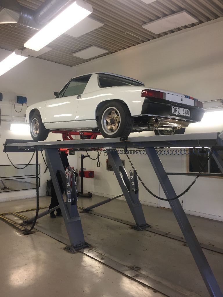

(IMG:http://www.914world.com/bbs2/uploads_offsite/matsgarage.com-15176-1494524790.1.jpg)
Once home i celebrated by putting on some new parts I had laying waiting.
*Tarret front drop links to the swaybar went on.
*New targa latch cups in the rear trunk
*Gas dampers for the rear trunk lid
*Spokes front led position/indicator boards
*BBS Mesh copies with new Nokia tires. (long distance driving wheels)
Feeling all set for this saturdays upcoming 500 mile roadtrip. (IMG:style_emoticons/default/smile.gif)
