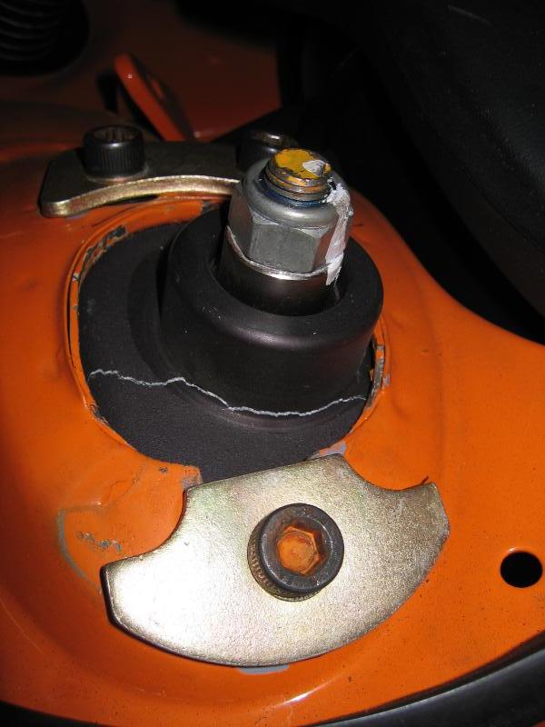

> cracked weltmeister camberplate, anyone ever seen this before?
siverson
post Feb 6 2005, 11:31 AM
Posts: 2,464
Joined: 5-May 03
From: San Diego, CA
Member No.: 654
Yikes, another new project to address on the car. Has anyone ever seen this before? I don't even understand how it would fail like this given the loads it should be supporting.
The product:
http://www.weltmeister.com/ProductDetails....x?productID=371
-Steve

TimT
post Feb 6 2005, 11:35 AM
retired
Posts: 4,033
Joined: 18-February 03
From: Wantagh, NY
Member No.: 313
Ive seen a camber plate fail in a similar manner, I dont know the mfg though
siverson

Aaron Cox
post Feb 6 2005, 11:36 AM
Professional Tinkerer
Posts: 24,548
Joined: 1-February 03
From: Corona, CA
Member No.: 219
upgrade to the tarett front monoballs (IMG:http://www.914world.com/bbs2/html/emoticons/wink.gif)
i really dont see WHY they would crack..... but man.... thats a fatty crack (IMG:http://www.914world.com/bbs2/html/emoticons/ohmy.gif)
Downunderman
post Feb 6 2005, 11:40 AM
Posts: 852
Joined: 31-May 03
From: Sydney, Australia
Member No.: 766
Region Association: Australia and New Zealand
Huge pot hole bottoming out the suspension did it to one on mine.

seanery
post Feb 6 2005, 11:45 AM
waiting to rebuild whitey!
Posts: 15,857
Joined: 7-January 03
From: Indy
Member No.: 100
Steve,
I have these on bluecar. One of my fears (after-purchase of course) was that they may fail because they are a cast part.
One of the billet pieces or a forged piece (if they exist) would probably be a better choice.
ArtechnikA
post Feb 6 2005, 12:24 PM
rich herzog
Posts: 7,390
Joined: 4-April 03
From: Salted Roads, PA
Member No.: 513
i really like the Wevo CamberKing monoball housing. investment-cast stainless, good stuff. i'm told they're available without the 911 strut brace mounts but i haven't investigated.
took a while to find the pictures i knew had been posted here, but they are in This Thread halfway down the second page.
airsix
post Feb 6 2005, 04:00 PM
I have bees in my epiglotis
Posts: 2,196
Joined: 7-February 03
From: Kennewick Man (E. WA State)
Member No.: 266
I notice the car is very low. I assume koni's with cut-down or possibly no bump stops? Could this be from bottoming the shock?

post Feb 6 2005, 04:52 PM
Bless the Hell out of you!
Posts: 10,926
Joined: 29-June 03
Member No.: 869
Ouchy! Happens.
I agree on billet vs cast for that lil booger.. and wow dood! BAD_ASS_RIDE!
The muffler scrape on the ground a few times?

post Feb 7 2005, 12:13 AM
Posts: 11,658
Joined: 22-March 03
From: USofA
Member No.: 453
Dont these type of products, because of the elimination of cushening rubber, transfer higher than normal loads on the chassis and are therfore a real compromise for a primarily street driven car?
