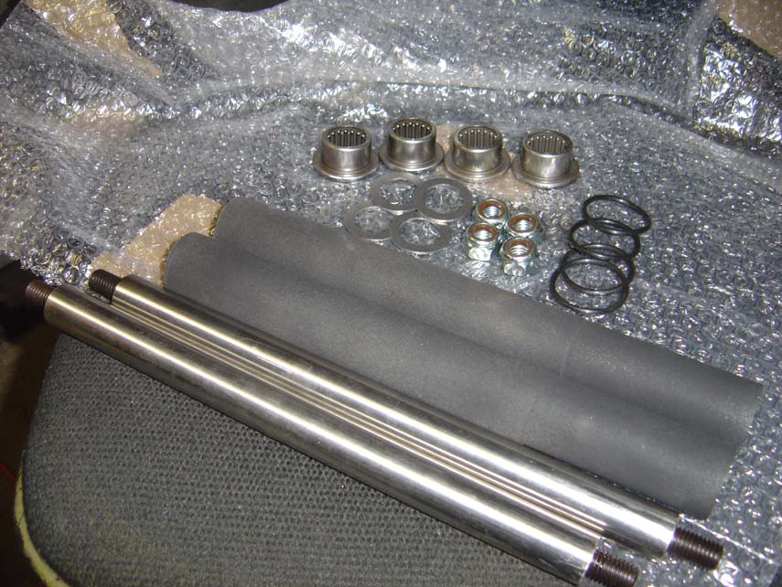

Got my new parts yesterday but when I took everything out of the box, there were no instructions. Does anyone have any instructions on how to install these? I mean most of it is self explanitory but there are some things I have to question. Like, where does the large O ring go? My best guess would be it is a seal to go on the outside to seal out dirt fromt the external rollers around the washer between the control arm and the mount on the car. This is starting to look like work. Mike, you out there?? This is your design.

Oops, forgot the picture

my design, but not my parts (IMG:http://www.914world.com/bbs2/html/emoticons/smile.gif)
he did tell you that correct???
it's not that big of a deal as long as everything works.....we talked about it and I'm cool as long as he does not pass them off as mine, I don't want to deal with broken parts or failed installs (a few people have gotten a little hammer happy trying to get the bearings into the tube once the tube is installed....on a few installs, the tube gets tweaked ever so slightly, no big deal, just clean the ID and the bearing will go in)
Rear kt instructions
do the tubes have one end turned down slightly?
if so, that is the end that is the end that you insert into the trailing (Pic 1)
Not included in the directions, but it helps, is once you test fit the tube so that it slides into the trailing at least halfway somewhat easy, remove the tube, spray the OD of the tube and the ID of the trailing arm with paint,
now insert the tube completly...the paint acts as a lubricant, sealer and locking compound.
if you have any questions, feel free to call me on my cell:
510.484.8700

oh yea....if you want, you can also add grease fittings to the trailing arm once the tube is installed, the zerk fittings can be found at your FLAPS, just drill and tap for the fitting
pack the bearings and lube the entire OD of the shaft before installing.......
two people are helpful with the install, the needle bearings are darn near 0 friction, the trailing arm will pivot so freely it can be dangerous if you lift the trailing arm up with no shock on it since the trailing arm will now swing back down with 0 resistance

front kits I outsource the machined parts from local machine shops...so all I have to do is bag them, the problem is the outlay of about 2 grand with each order to buy enough parts to get decent pricing....
currently for the rear kits, it's a PITA to produce....I buy the shafts in ~3' lengths, use an abrasive cutoff saw to cut them, then I precision grind the ends of the shafts in my lathe with homemade grinding attachment (I try to keep them -.001/+.002)
then the drilling for the 14x2.0 thread, the shafts eat up my drill bits big time, it normally takes 3 bits per hole to get to the 1" depth (I resharpen the bits, so sometimes I'll get lucky and get one hole per resharpening)
for the tapping, I'm lucky if I get 4 holes per one tap...
for the tubes I do a rough cut on with my bandsaw, then I use my lathe to clean up the ends and get those within the same tolerance range as the shafts....
I have a few ideas to either outsouce the machining of the rear kits and/or, re-design the kit completely.....
