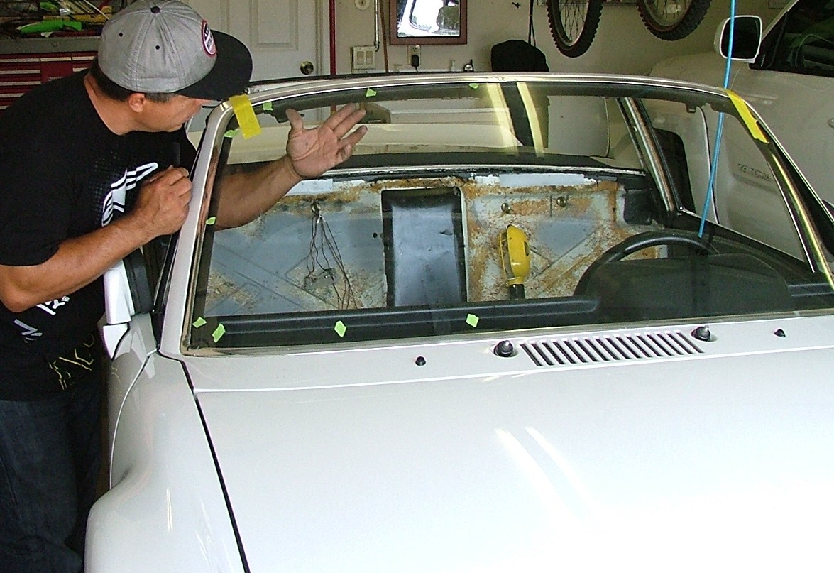

The good news is two fold, I do have a new German windshield installed!

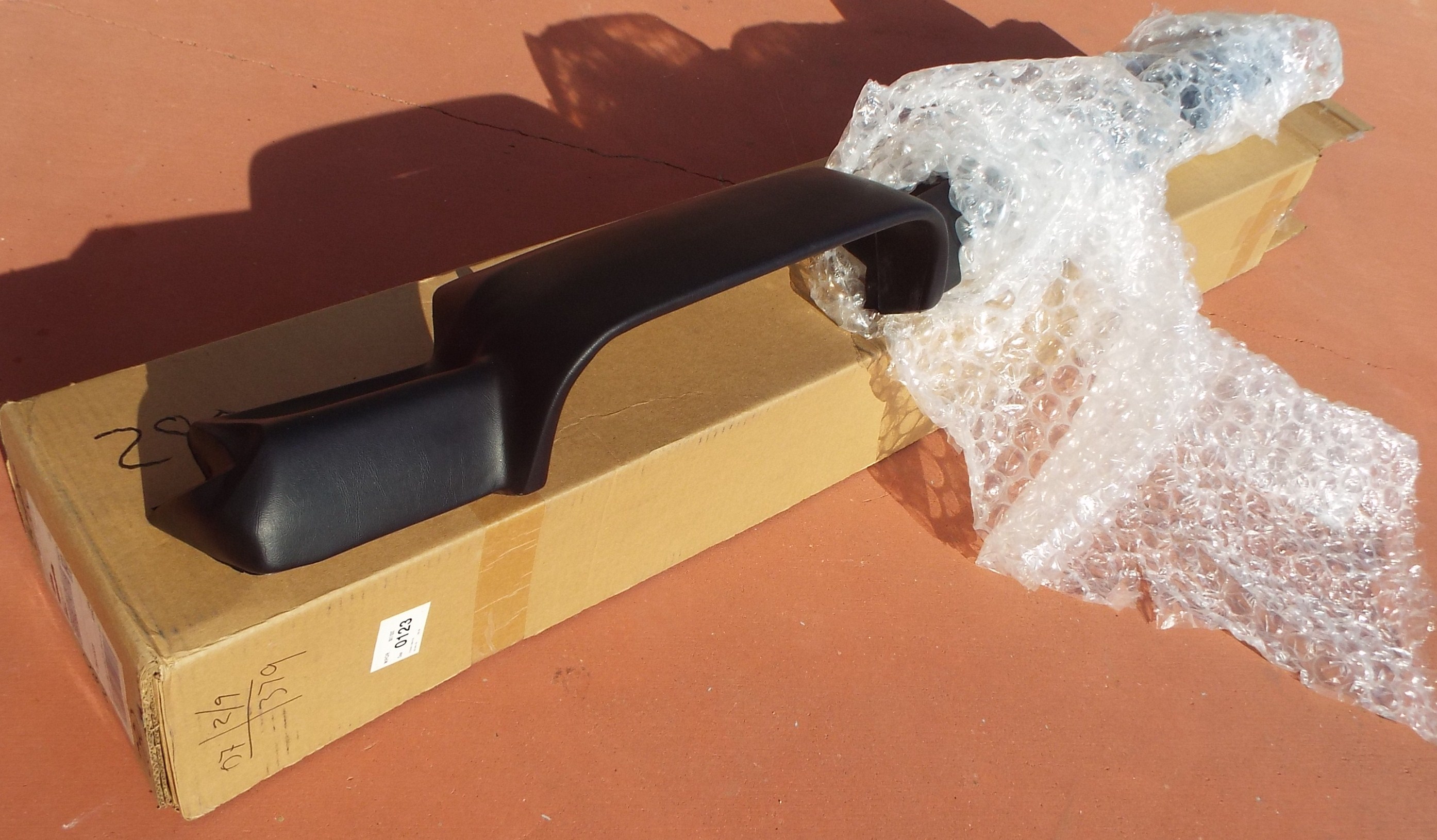

AND I scored a deal on a brand new 914 Rubber repro dash!
The bad news is the order things occurred. That’s it. (IMG:style_emoticons/default/biggrin.gif)
I bought the windshield and installed it over 2 years ago, June 2015.
I scored what I consider a smokin’ deal on the dash earlier this year in March 2017 that I got from a guy who gave up on his project here locally in my town.
My original dash is cracked but I had just planned to live with it and save the money for other things.
Sure would have been nice to have gotten the dash while the windshield was out as I have heard it is much easier. (IMG:style_emoticons/default/headbang.gif)
But can’t complain too much, I mean it is a brand new, still in the box, dash from 914 Rubber!

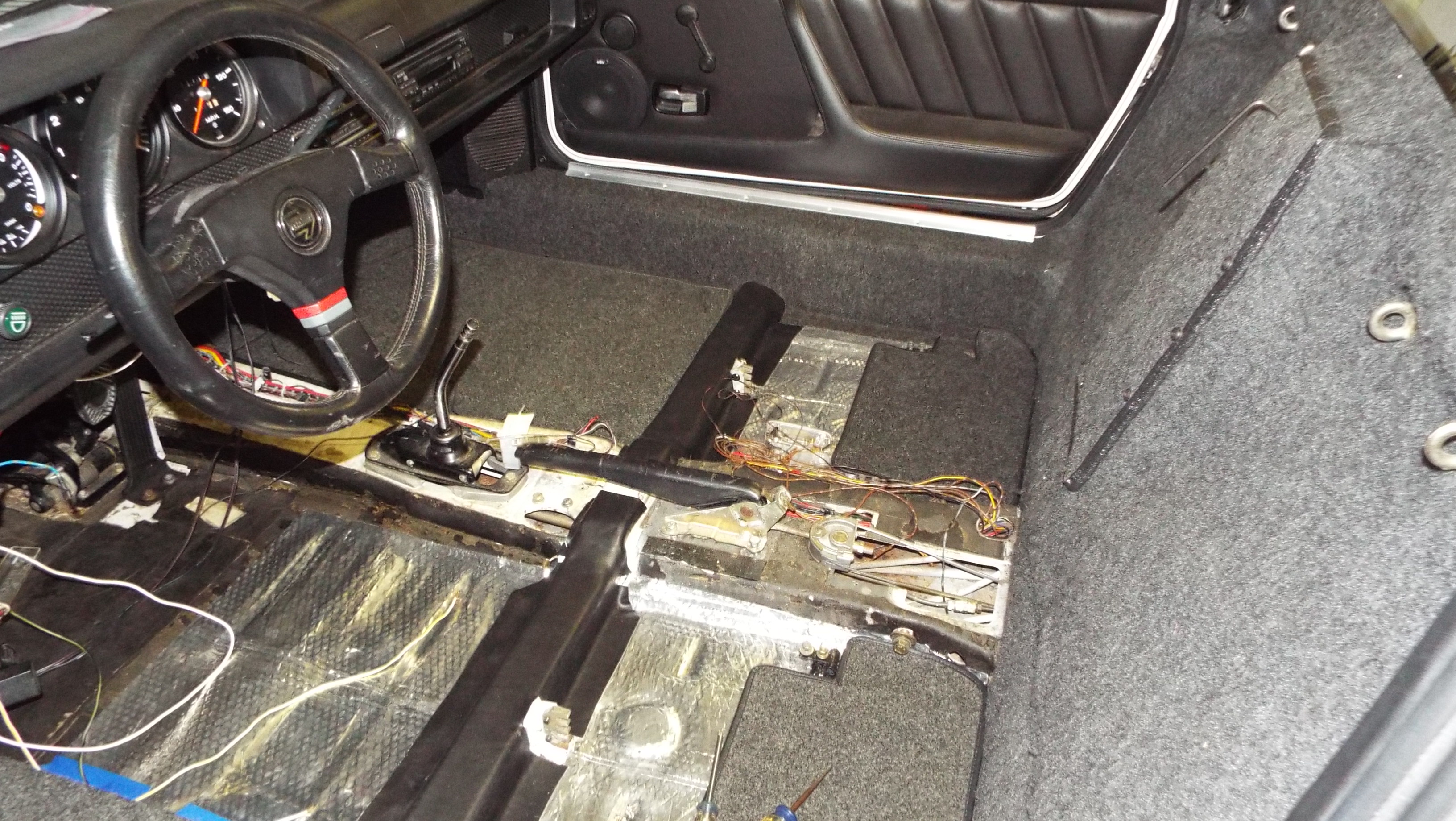

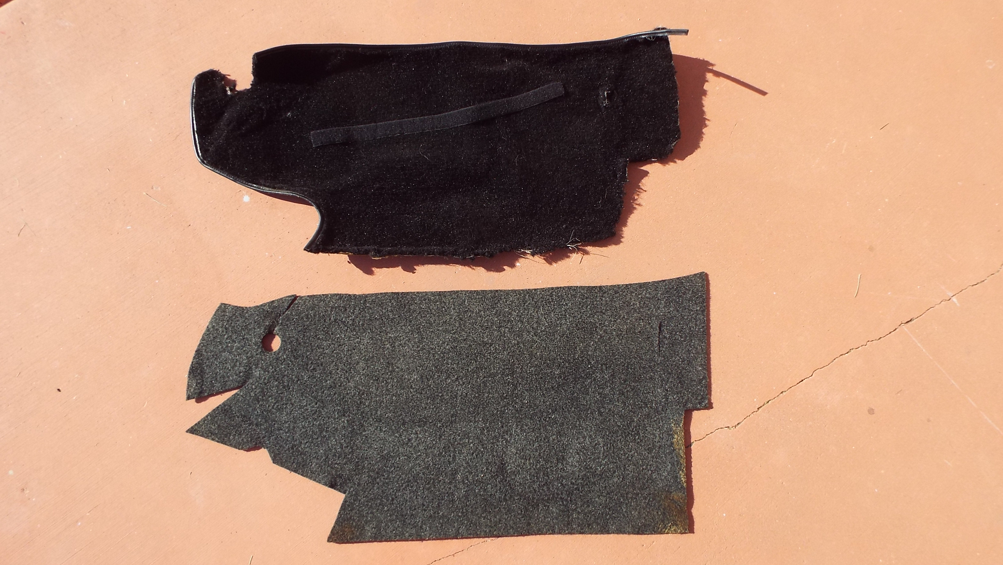

Also I have been working on the interior sound deadening, vinyl and carpets. This car had a few interesting things in it one of which was the carpet. Not complete and huge heavy black double layer front floor mats.
I was at a swap meet a couple years ago and a guy had a bunch of random charcoal perlon original pieces of carpet I picked up for $20, some nice some not so nice. My goal was to have all all charcoal carpet. I had not spent much time really looking at the pieces I bought back then until this week and I discovered I have the majority of it. So I removed this nasty black piece that was in the front passenger bulk head and my charcoal swap meet piece below.
This is where I am right now on the interior. You'll notice I am using alum thresholds and had been keeping an eye out for those. Stumbled on some for free recently, not perfect but useable and I prefer the alum to the black plastic.
It's coming along slowly. (IMG:style_emoticons/default/white914.jpg)

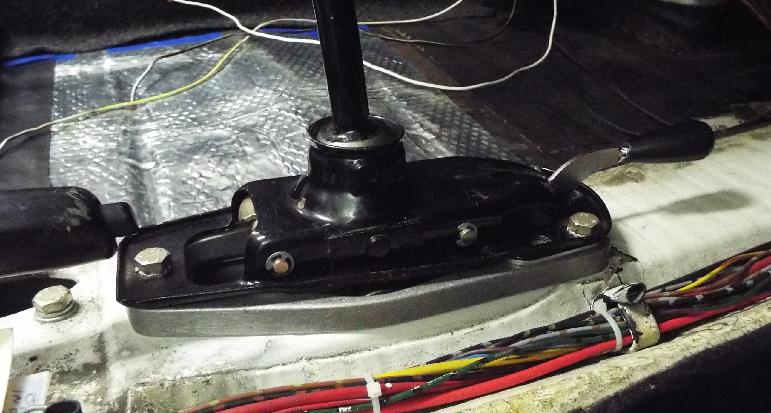

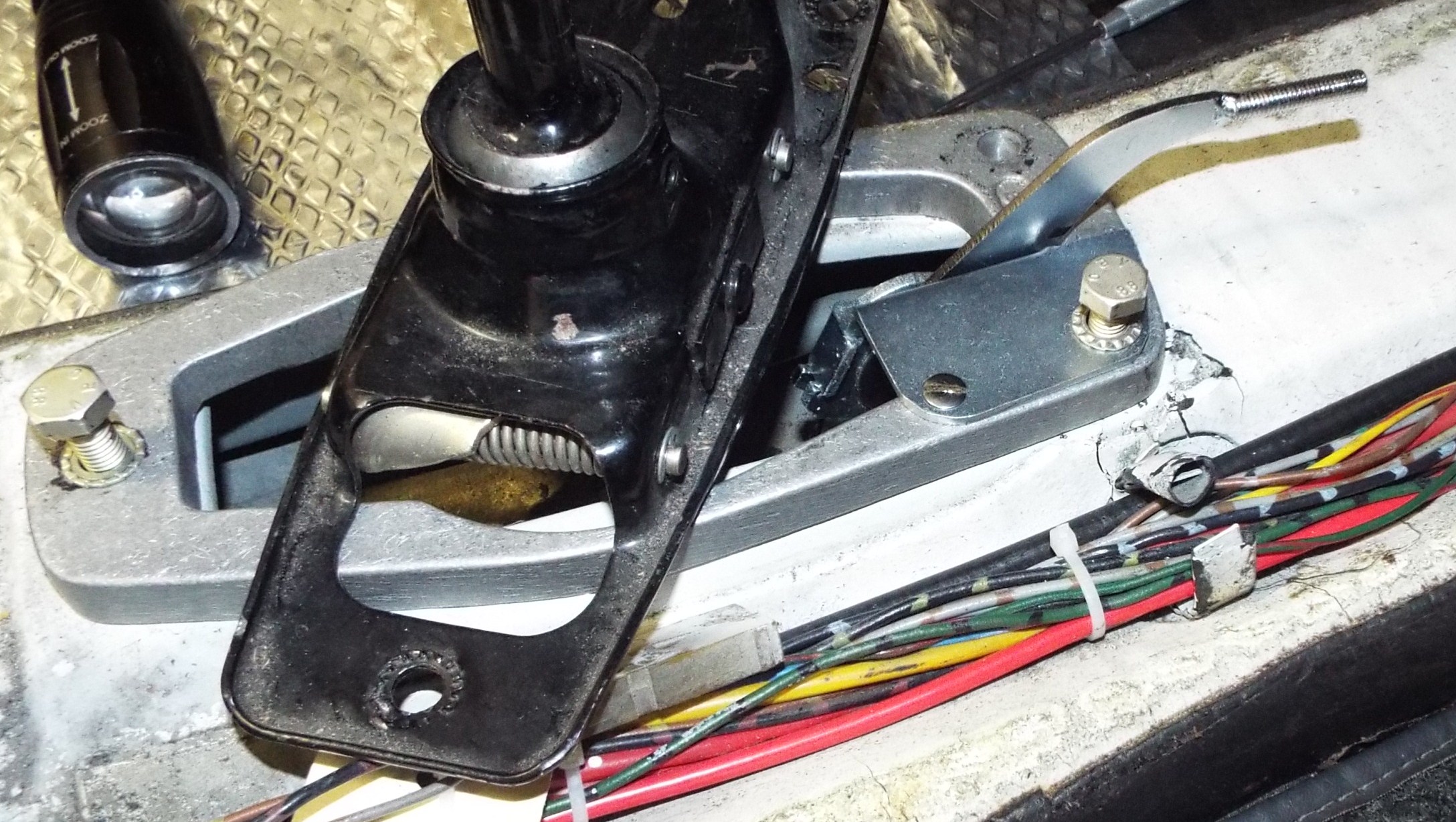

My 6 Hand Throttle Journey.
I posted a separate thread to gain a wider audience and more input which proved to be very helpful and provided the detail I was looking for. Here is the thread which will have more information than I have here.
http://www.914world.com/bbs2/index.php?showtopic=319072
I want to document in my build thread some of the more pertinent information I found most helpful and my final result.

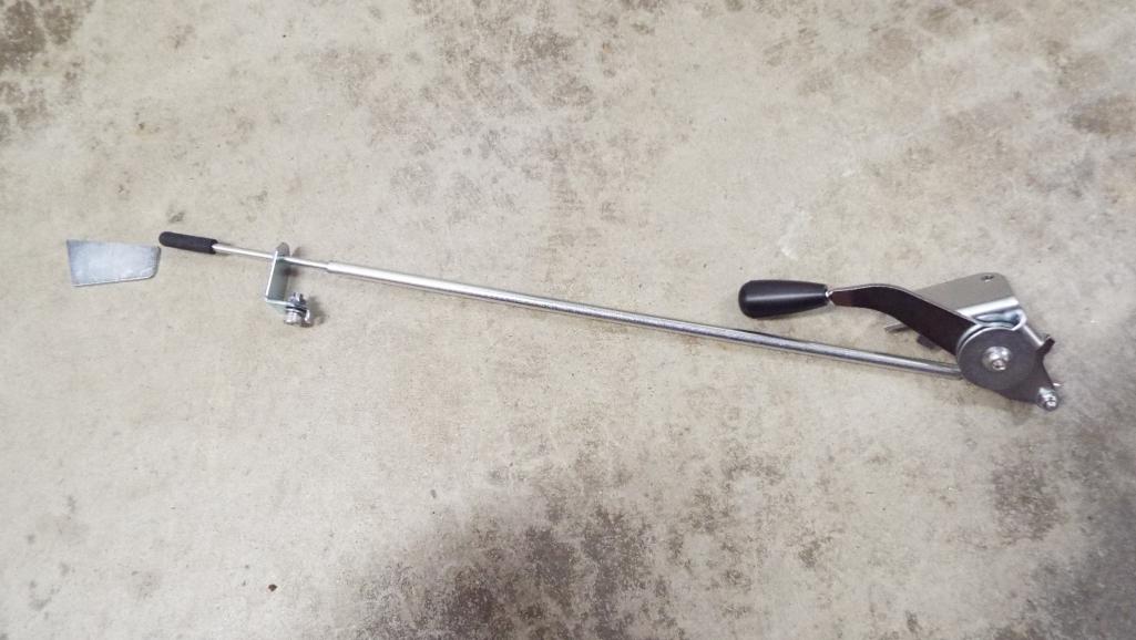

The lever assembly came from 914 Rubber and I thank them for replicating the factory lever assembly.

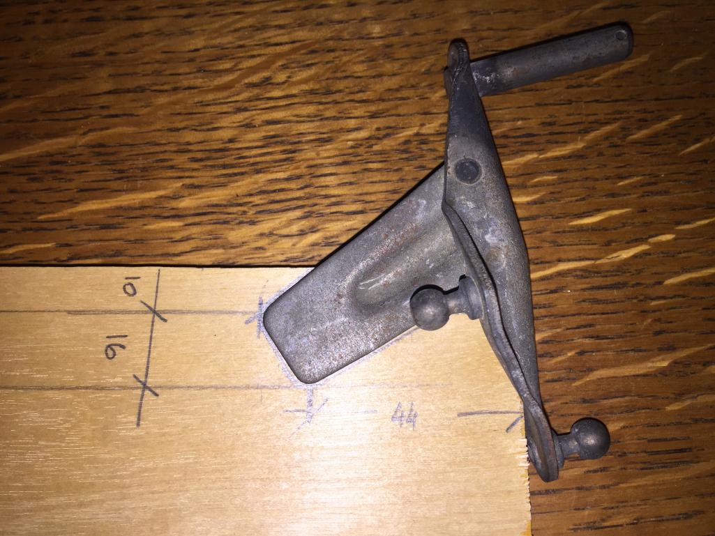

Pertinent to my install is that I wanted to install this hand throttle AND keep my short shift this of course mad it just a bit more complicated.
A few posts back I also sought help with a separate thread asking for short shift experience, where with a lot of very good input pro and con, I decided to try it (being as I have never actually driven this car) as one suggested, because it could always be taken out later.

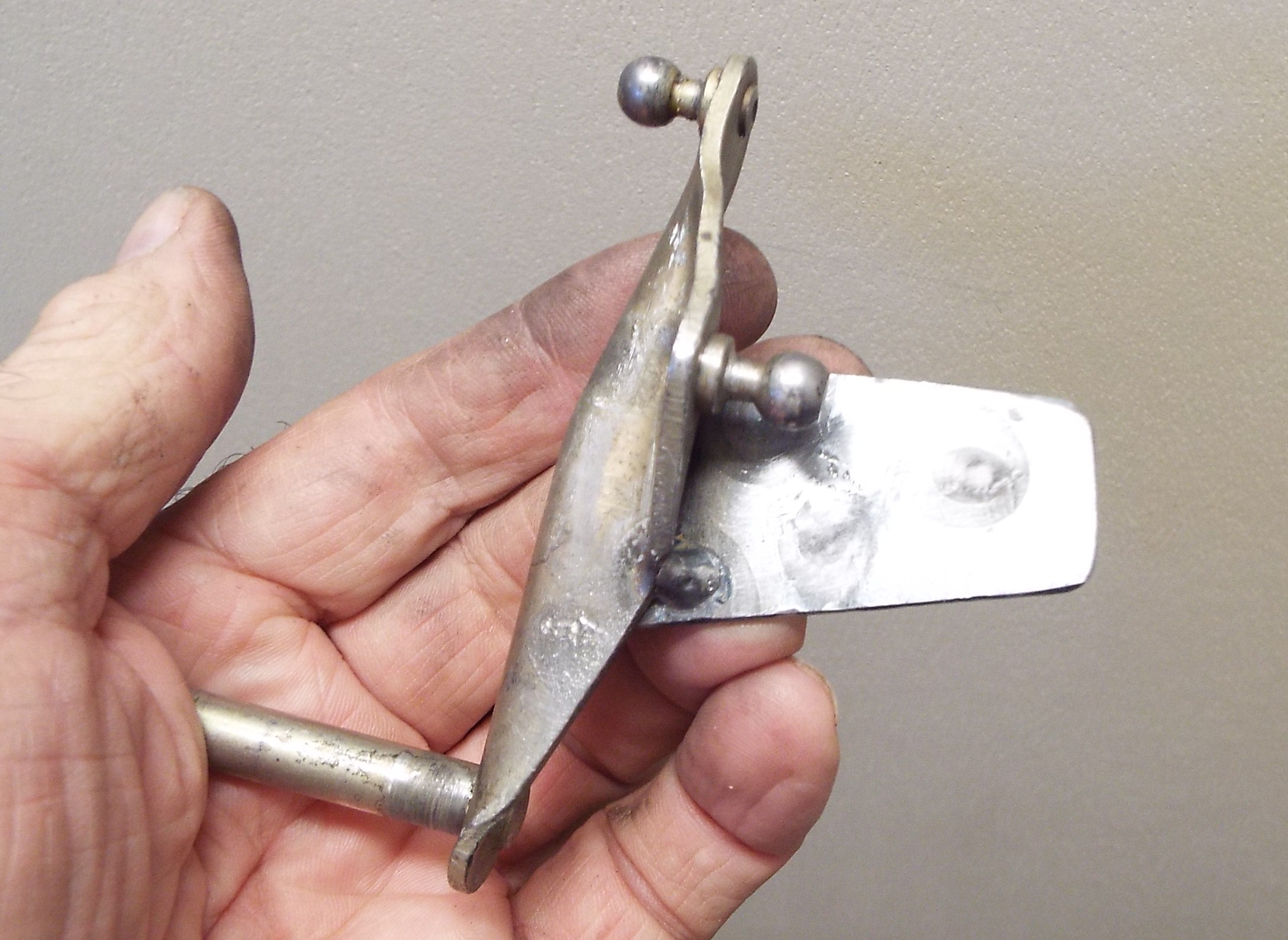

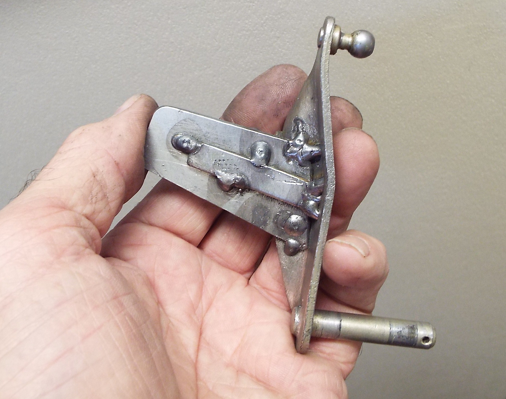

The short shift adapter alum casting is about ½” thick needed two modifications. One was to notch the forward end where there was plenty of meat to make room for the hand throttle but I neglected to get a pic of that. The other modification was to drill and tap a hole for the aft hole of the hand throttle assembly base. Then I countersunk the aft hole of the throttle assembly base and put the only metric flat head screw I had into it. Interesting there is a hole in the shifter plate that does not match the hole for the hand throttle?
In process picture
Here is all the stuff that really helped.

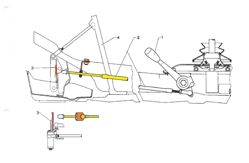

The colored sketch from 914 Rubber gives a good overview but not the detail for the “Shark Fin” install.

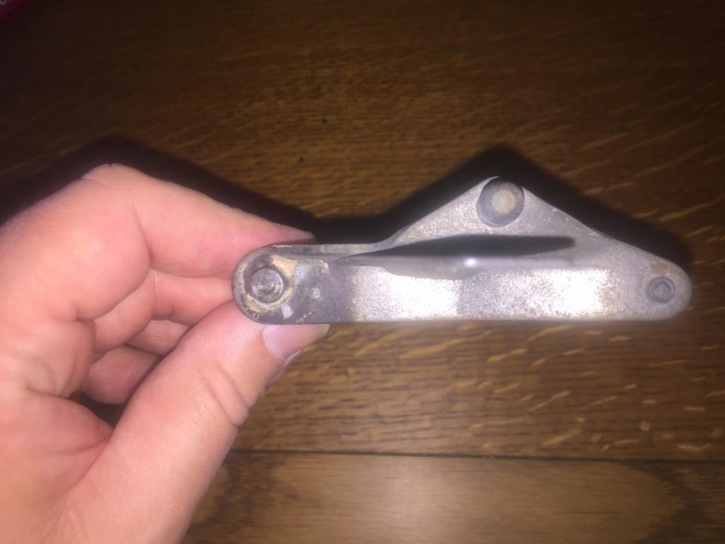

I found these pics from SixerJ to be most helpful to installing the “some assembly required” “Shark Fin” to the accelerator lever. (IMG:style_emoticons/default/pray.gif)
Attached ImageAttached ImageAttached Image

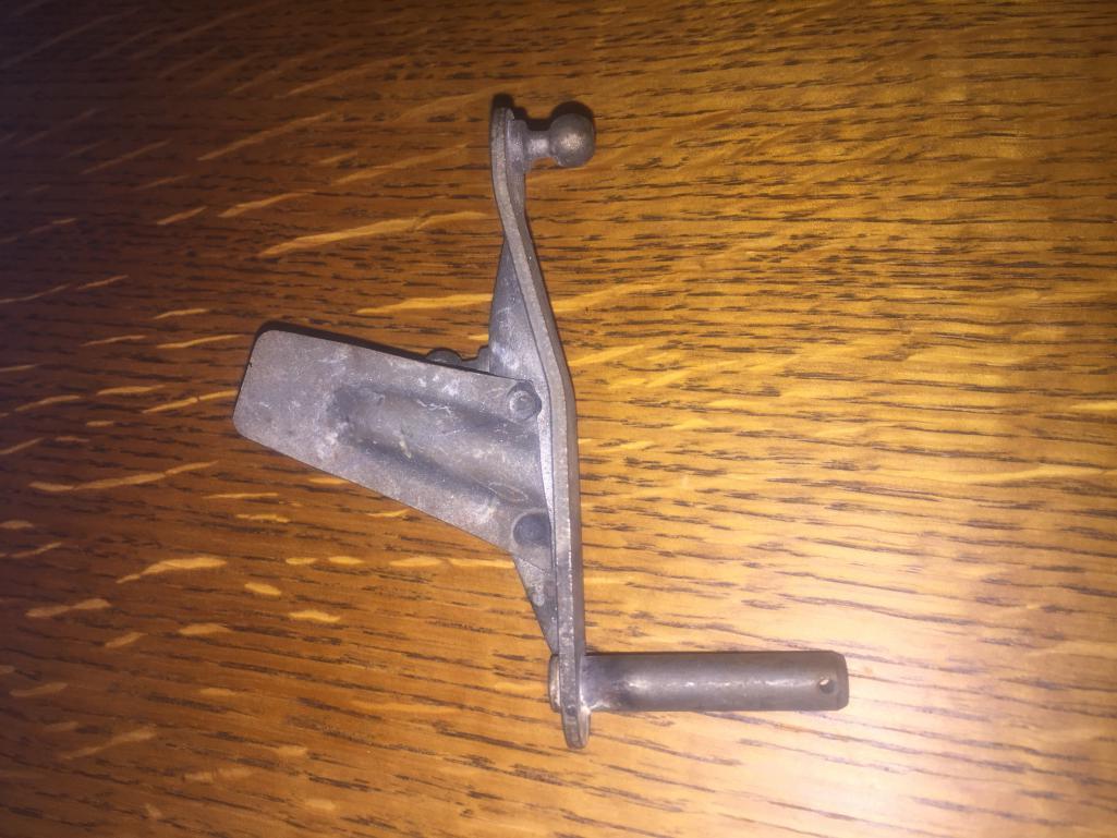

I also found this one from raynekat helpful of a 914 Rubber fin installed

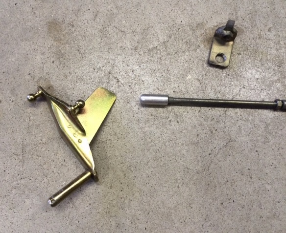

So here is what I ended up with.
On the back I tacked an extra brace. Probably looks like over kill but I don’t think too many people will be looking and it will never bend. (IMG:style_emoticons/default/biggrin.gif)

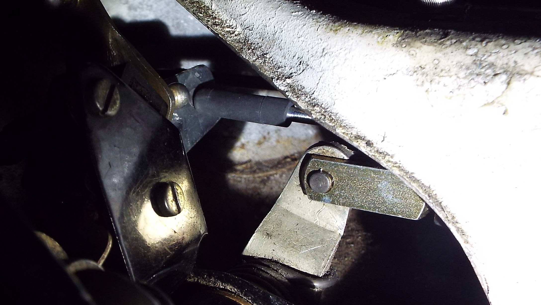

Re-installing the lever with fin was not too bad. But for those of us with transition lenses (trifocals) it is sometimes hard to actually see where you want to. (IMG:style_emoticons/default/blink.gif)
There you have it with the throttle rod smack in the middle of the “Shark Fin”
And the finished product that I am quite happy with.
On to the next thing! Thanks everybody! (IMG:style_emoticons/default/bye1.gif)

Was the front support (locating) bracket for the hand throttle hard to place in the correct place?
Looks like you got the rod end right in the middle of the shark fin.
Does the rod end slide up the shark fin when you engage the hand throttle?
Lucky9146
post Nov 3 2017, 06:16 PM
Post #330
Posts: 1,711
Joined: 22-September 14
From: Poway California
Member No.: 17,942
QUOTE(raynekat @ Nov 3 2017, 03:33 PM) *
Thanks for asking and I forgot to mention the hole/slot already exists on the tunnel for the front rod support bracket so you do not need to make one. Bonus! It was easy to place the front rod support bracket.
Install the the mechanism in the shifter area first without the front support bracket and rubber end cap. Then place the rod support bracket in from the top opening in the tunnel onto the end of the rod and bring it back and line it up with the slotted hole and secure it with the bolt provided. The support bracket has a locator on it to keep it from tuning and correctly positions the rod vertically as well aiming at the "shark Fin". Just make sure you have the clutch linkage attached because it will block access from the passenger side.
The rod does NOT slide up the shark fin it just pushes the pedal forward as intended. Note there is a rubber tip on the end of the rod.
The cool thing for me is having the short shift plate on there did not really affect the outcome. (IMG:style_emoticons/default/biggrin.gif)
Best of luck! (IMG:style_emoticons/default/beerchug.gif)

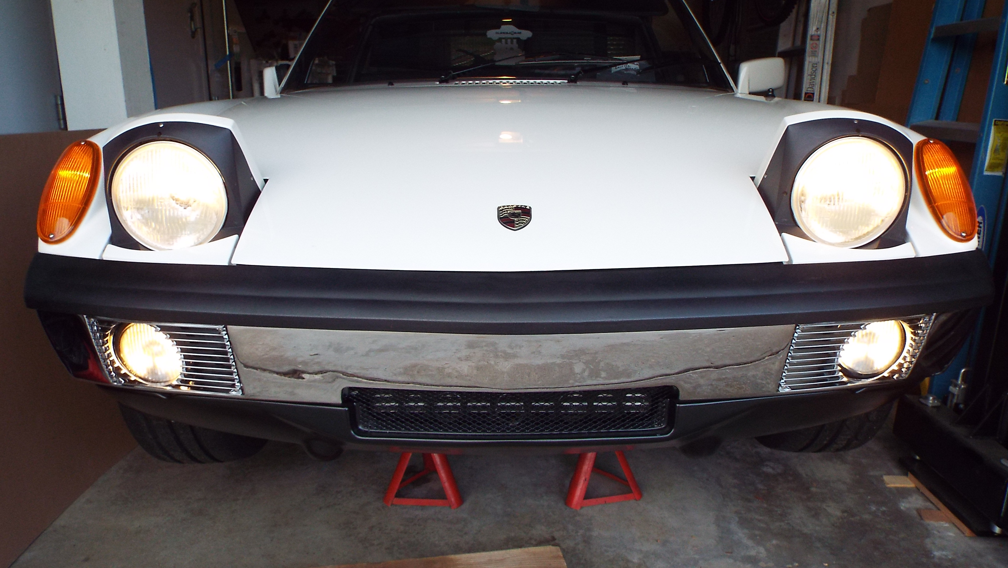

Not much progress lately. Or really it amounts to “little things” are getting done. (IMG:style_emoticons/default/smile.gif)
I finished the sound deadener on the floor and the majority of the carpet.
Reworked one seat track to install my 914 Rubber seat adjuster handle.

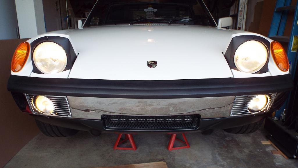

Your front lower snout looks "business."
I like that look. (IMG:style_emoticons/default/cheer.gif)

where did you find the front lower valence,..was it pre cut like that,.?? TIA Frank
914forme

It is a standard 914-6 GT front valance all the usual suspects carry them.

The valance actually came with the project car I bought so I really don't know who made it.
The trick was mating up the fiberglass lower valance to my customized front bumper because the valance was designed to mate up with the corresponding fiberglass bumper that it came with (since sold).
Know a metal magician who performed the work on the bumper, and it wasn't the greatest to start with. He actually matched the steel bumper to the valance perfectly.
(IMG:style_emoticons/default/sawzall-smiley.gif) (IMG:style_emoticons/default/welder.gif)
I see 914forme has a suggestion and I am sure there are others who make them.
Best of luck to you!

(IMG:style_emoticons/default/agree.gif) that front view is the business,looks really sharp,love the comment about the electrics Jim made SO true in my situation also,I don't run my car that often and there's always something ,I feel for guys with crappy/butchered looms lucky for me mines unmolested.

Thanks porschetub and also to Larmo63 and Cairo94507 for comments on "business" snout. Spending most of my time at the other end for months and recently moving to the interior I haven't really had much of a chance to see it with the front butted right up to the garage door. I love the look.

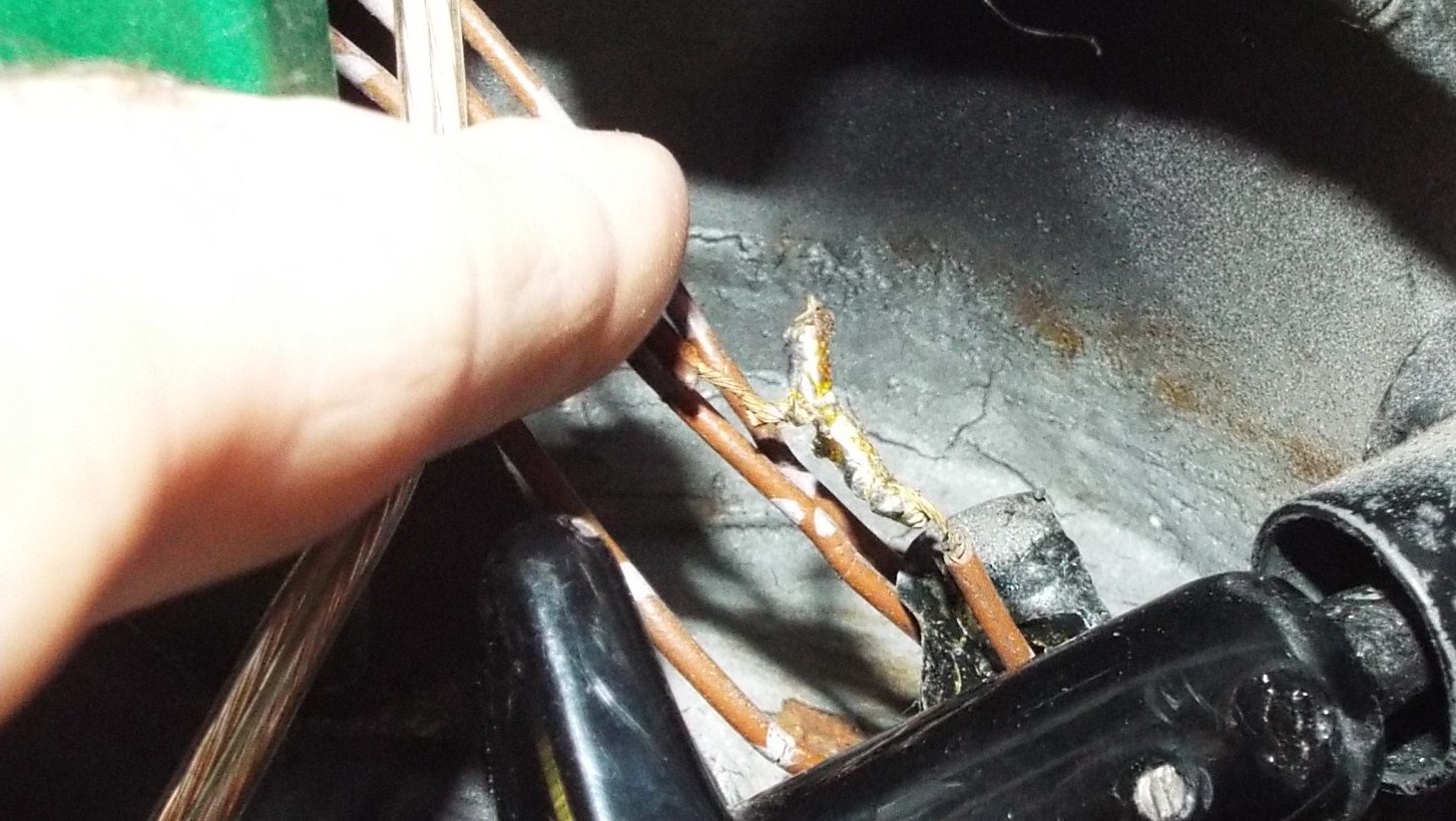

As for the wiring mine has been a bit more than molested I'm afraid. porscehtub you are lucky! (IMG:style_emoticons/default/agree.gif)
Here is one I am fixing today. Picture does not do it justice though as you cannot see to the right of that primo splice there were only 2 strands left hidden under crappy old electrical tape. (IMG:style_emoticons/default/mad.gif) Going to be fun to fix up by the hood release handle! (IMG:style_emoticons/default/wacko.gif)
