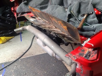

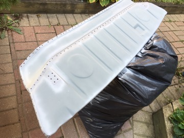

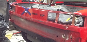

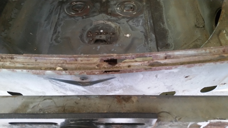

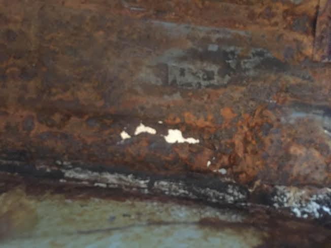

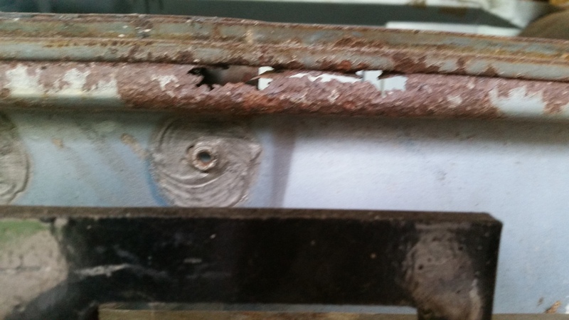

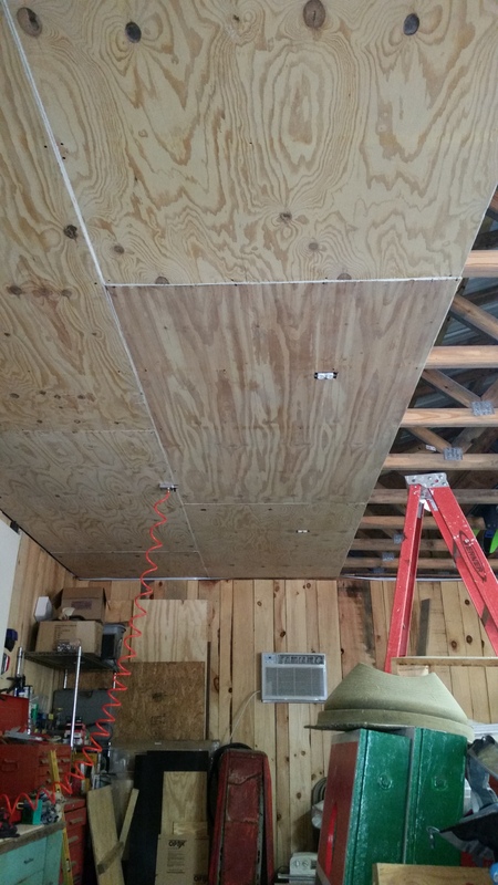

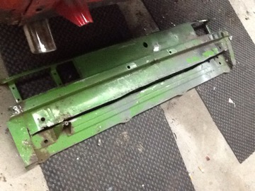

OK, so I guess I am the first one to post an October update...
I did not make a lot of progress this month for the usual reasons, but more on that later.
What I did get done was: Repair/weld up the weather strip channel for the front trunk, grind out more seam sealer and begin the rear trunk floor repairs.
Spots like these.Attached ImageAttached Image

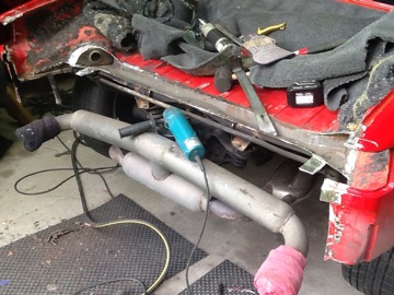

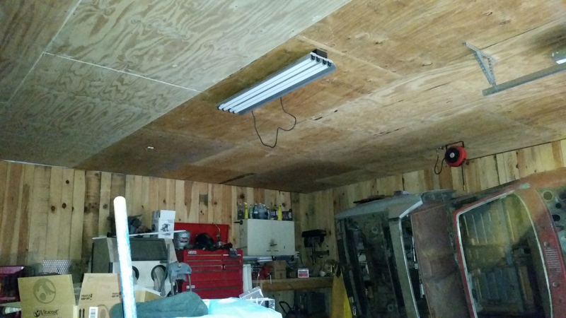

Then this happend and I had to stop work on the car and gather my rosebuds while I may.. could... what ever. Salvaged and installed for a warmer winter.
After money this is the number one killer of this project... other projects that jump ahead in line.
I did not receive any help from vendors this month, but my fingers are crossed that next month I can get the media blasting done.

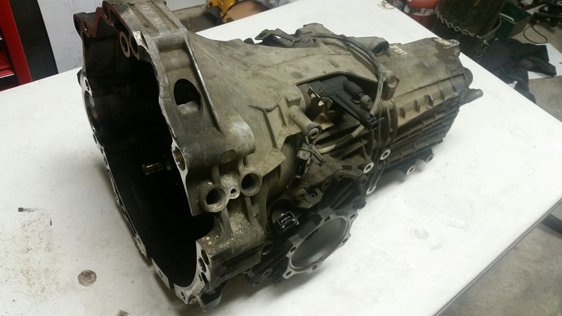

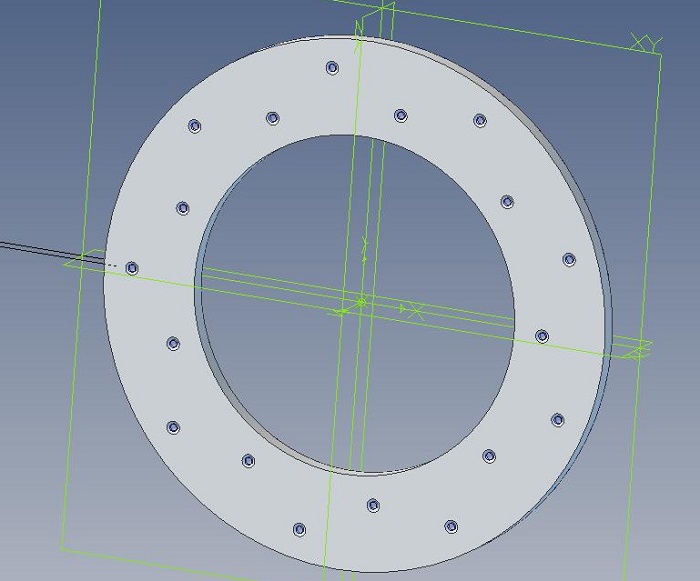

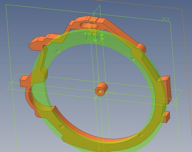

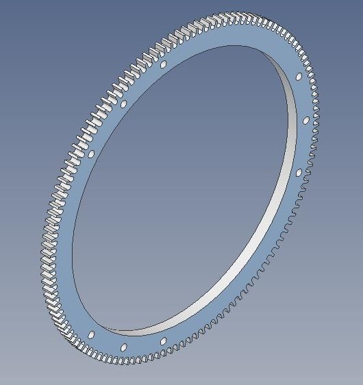

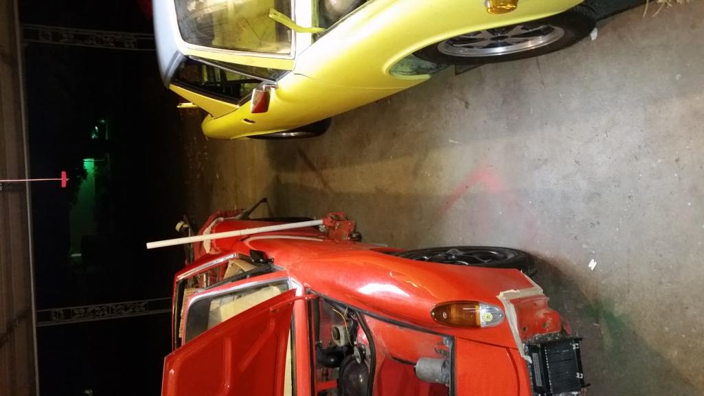

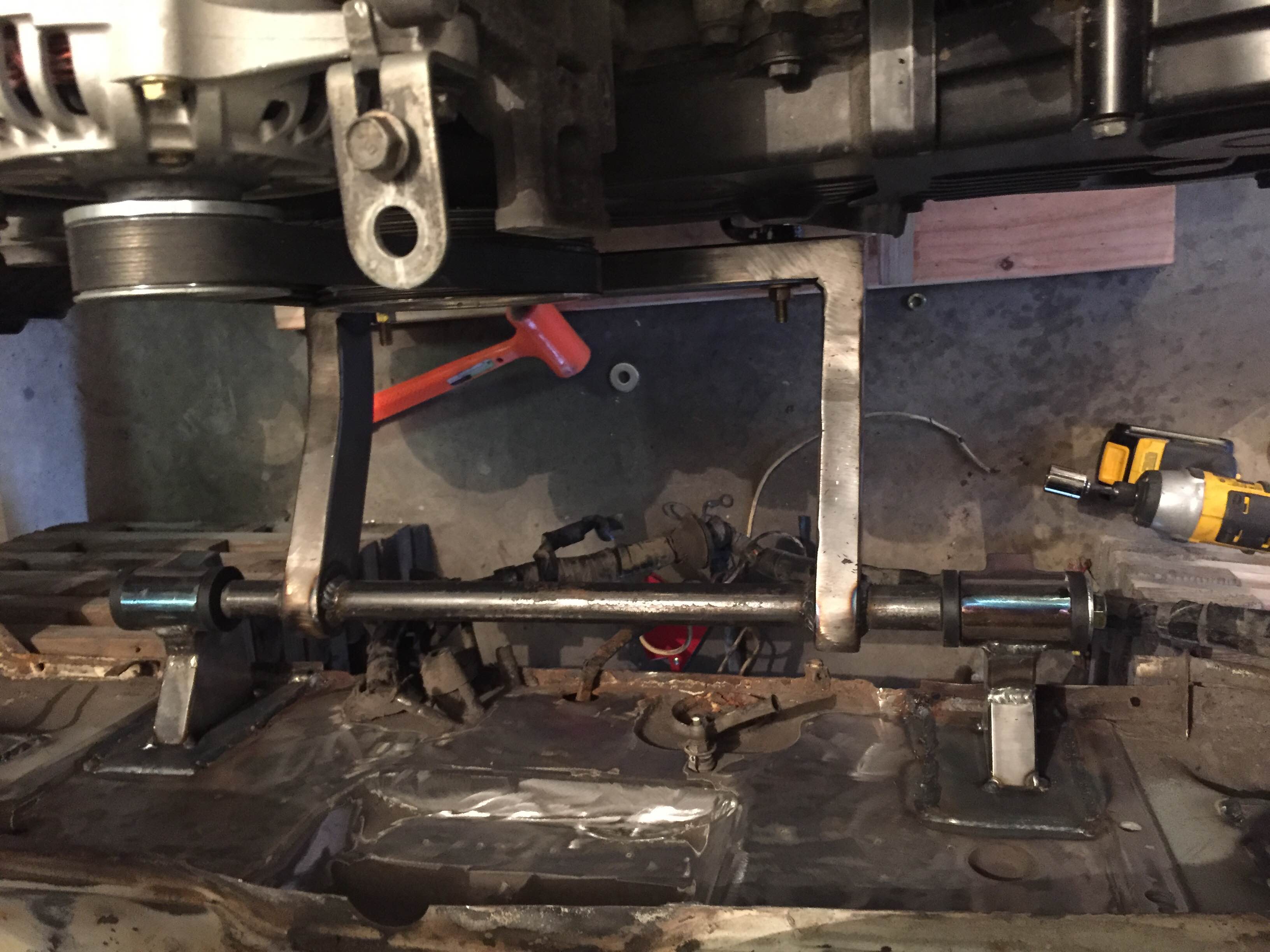

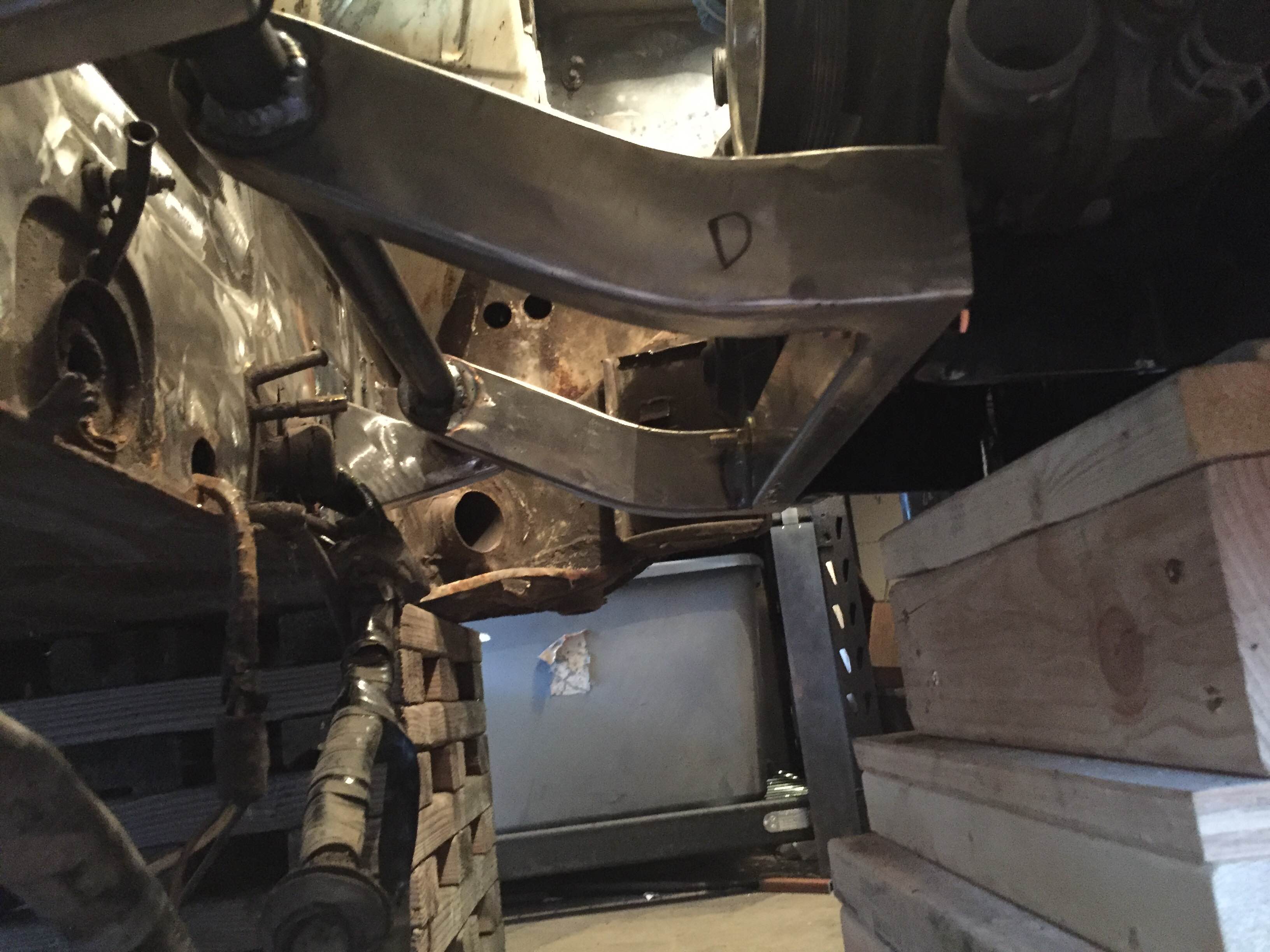

Update for October.
Car is still across the street at my friends house. Volvo taking longer to finish..dropped brand new piston wrist pin on ground, scratched the piss out of it, broke my piston ring compressor....capacitors for mill computer blew up, in process of converting to new motion controller (complete re-wire and programming of machine)
Not sure if the following is progress or not for the 914.
I bought a Passat/Boxster transmission to adapt to my 1.7 Type IV, the following pics show some drawings I'm doing to mock it up...I will be designing a billet aluminum flywheel for the ring gear and clutch friction surface I have drawn up also.
Oh yea, have not bought anything from a Challenge vendor nor have I received help or financial assistance (Dave Darling gave me a hard time for not getting the car running 1st, I expect no less from those I've known for so long!)
(IMG:http://www.914world.com/bbs2/uploads/post-87-1444711654.jpg)
(IMG:http://www.914world.com/bbs2/uploads/post-87-1444798498.jpg)
(IMG:http://www.914world.com/bbs2/uploads/post-87-1445704772.jpg)
(IMG:http://www.914world.com/bbs2/uploads/post-87-1445704783.jpg)
(IMG:http://www.914world.com/bbs2/uploads/post-87-1445800088.jpg)
I fully expect to come in at least 2nd to last place with all the other awesome builds and I'm okay with that (IMG:style_emoticons/default/MDB2.gif)

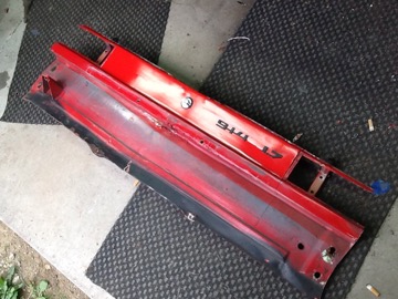

October Update: Extreme Budget Makeover - Creamsicle Edition
Only thing 914-related that happened this month is I sold a rear panel from a parts 914 to a friend who is in the process of repairing a 914 that was rear ended. So now I at least have a few $$ to put towards my build (IMG:style_emoticons/default/biggrin.gif)

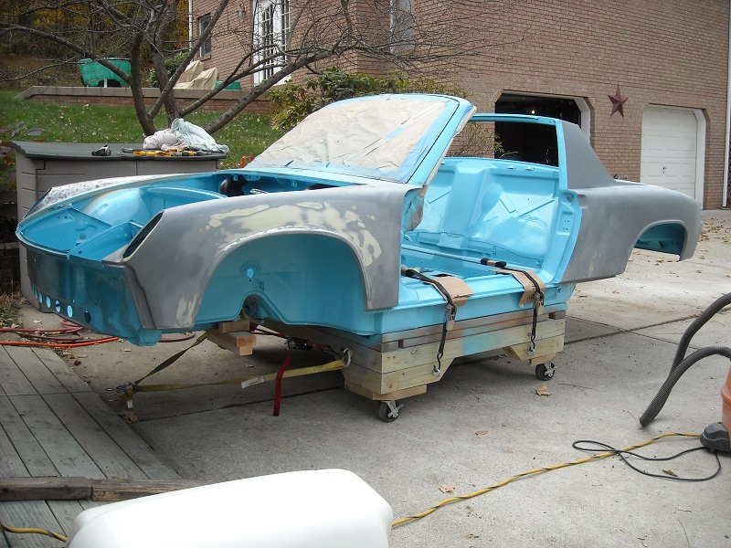

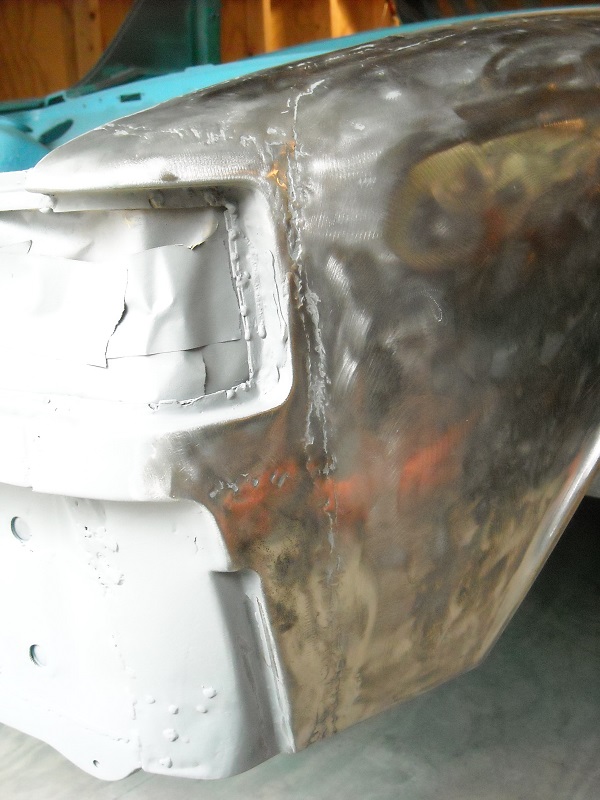

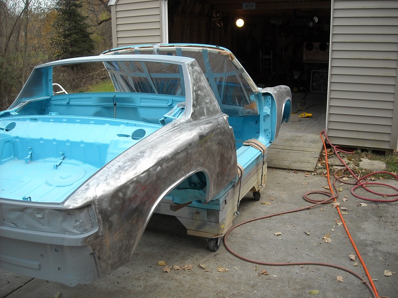

Oct 2015 progress
Still working on the drivers side fenders, bought some new Soft Sanders sanding blocks and they really helped smooth things out. The Durablocks are pretty good but the Soft Sanders bend more. I got the fenders to about 90% and had to walk away.
Taking too much time being anal about every little pit right now. So I pushed it out of the shed and turned it around, to work on the other side. The shed isn’t really big enough to easily work on both sides. but I can roll it over on the cart to get to the other side for some work.
Earlier I had just put some spray bomb primer on the passenger side just to keep the flash rust at bay, so I sanded all of that off to start the bondo work on the passenger side flares. (no Metal Surgeon here)
Next I have to make this look pretty and smooth.
Caught a couple warm days and it was really nice to work on the car outside for a change. Plus I could give the shed a good vacuuming.
Stripped the doors to take to the media blaster and found he will be out of town on another job for a month. That is going to slow me down, since I probably won’t get the stuff done until around Thanksgiving. I wanted to get started on the doors, and trunk lids. Something nice and flat to sand on for a change.
Stripped and epoxy primered the engine lid and found my rain tray had gotten warped and cracked up while in storage. Used a heat gun to get it straight, then epoxy glued the cracks. It turned out pretty good.
Diassembled my seat mounts and sent them to the powder coaters along with the rotor dust covers. And took my seat tilt aduster levers to my buddy’s Chrome shop. I know chrome isn’t for everybody but I like it on some things.
Shipped my calipers and prop valve off to PMB for a rebuild and ordered a bunch of related brake parts.
It didn’t seem like I got much done until I started writing it down. The weather will be an issue here soon and will screw me up as far a painting goes. I may have to just start installing some stuff while I continue to work on the body. Downside to that is the sanding dust gets everywhere, even though I tarp it off with old sheets.
That's about it for now.

Love the winch setup to pull your dollied 914 back into your shed. I was admiring your simple dolly, and then said WTF, whats that for, lol, and noticed the cable. Saves a few backs I am sure.

I once used a come-along to get my old 914 into the garage...I used a 2x4 in the door way and prayed nothing broke while ratcheting it up the driveway!

QUOTE(914forme @ Oct 27 2015, 02:20 PM) *
You guys don't miss a trick (IMG:style_emoticons/default/laugh.gif)
I have an anchor plate lagged into the front of the shed, using a small 12V 2500lb winch. works good when taking it out also. just lower it down the ramp.
I also used a come along till I got the winch. much easier now.

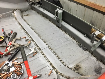

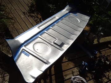

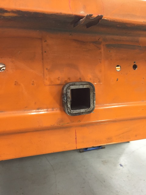

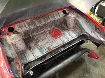

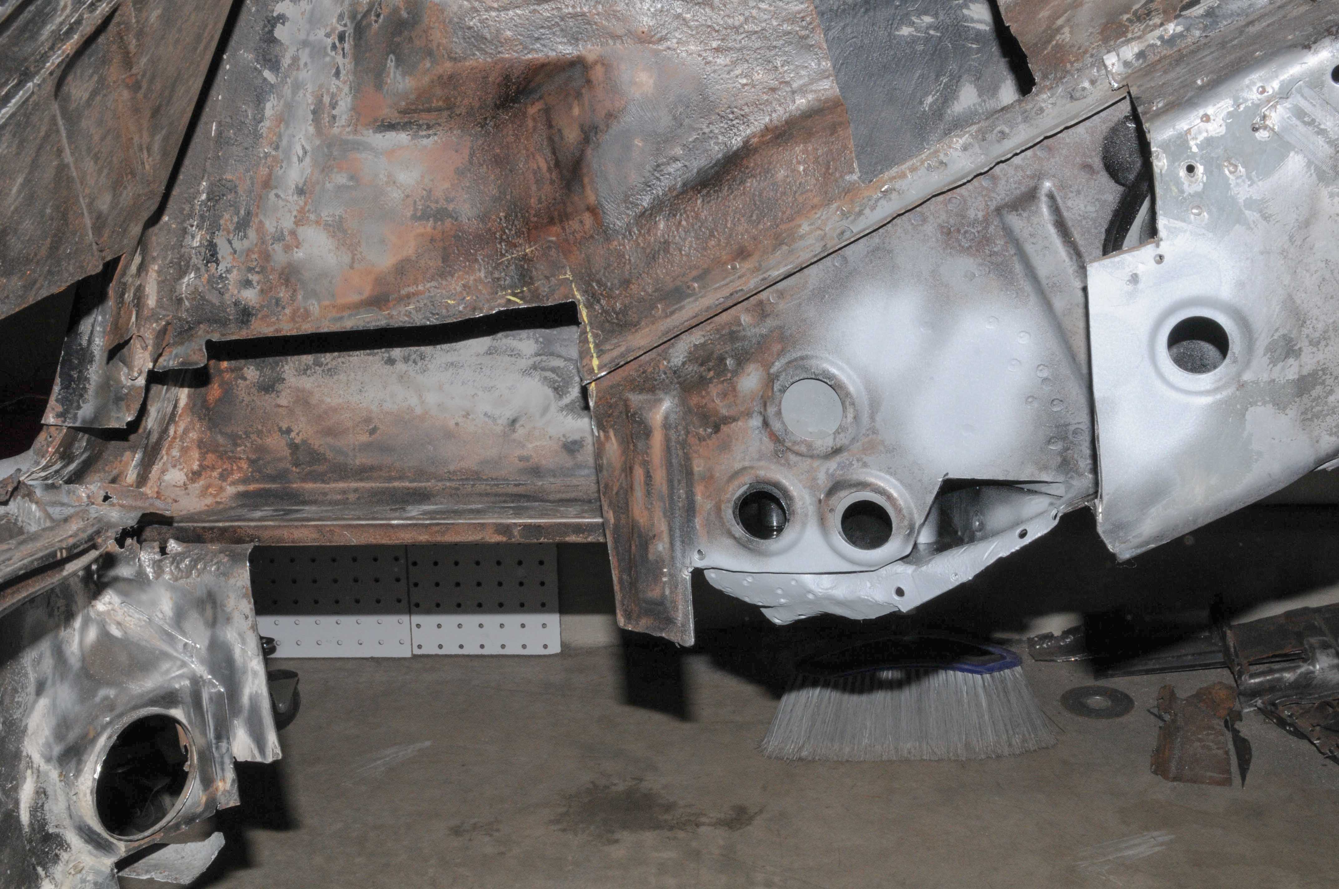

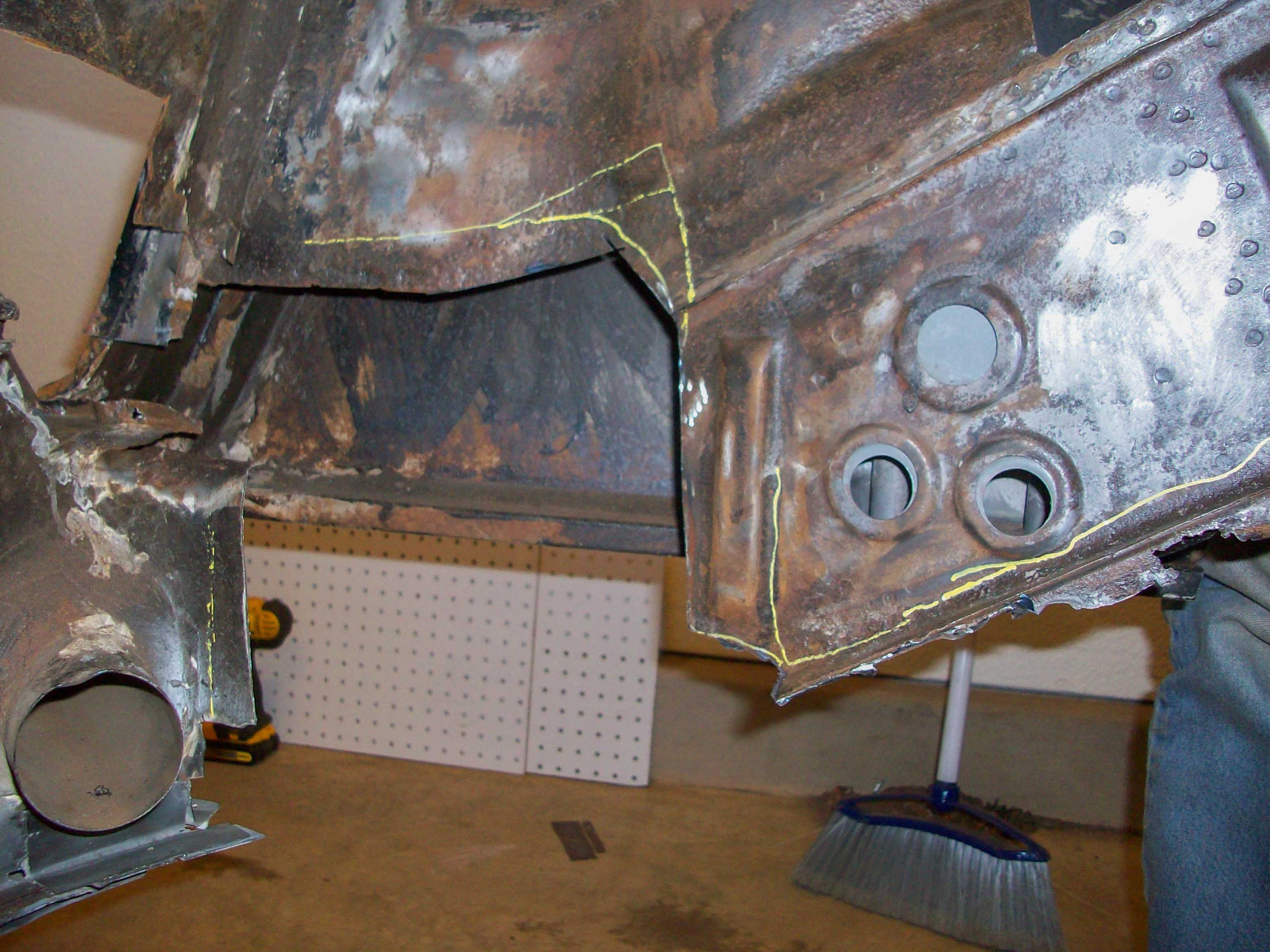

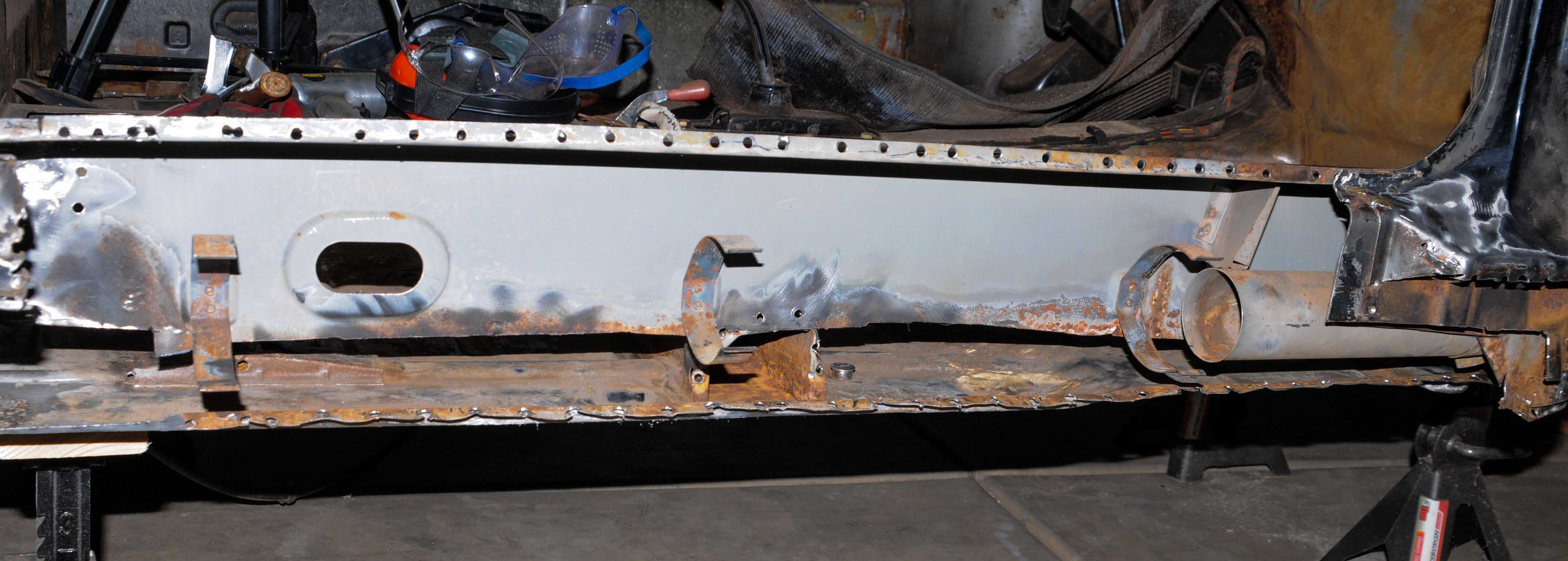

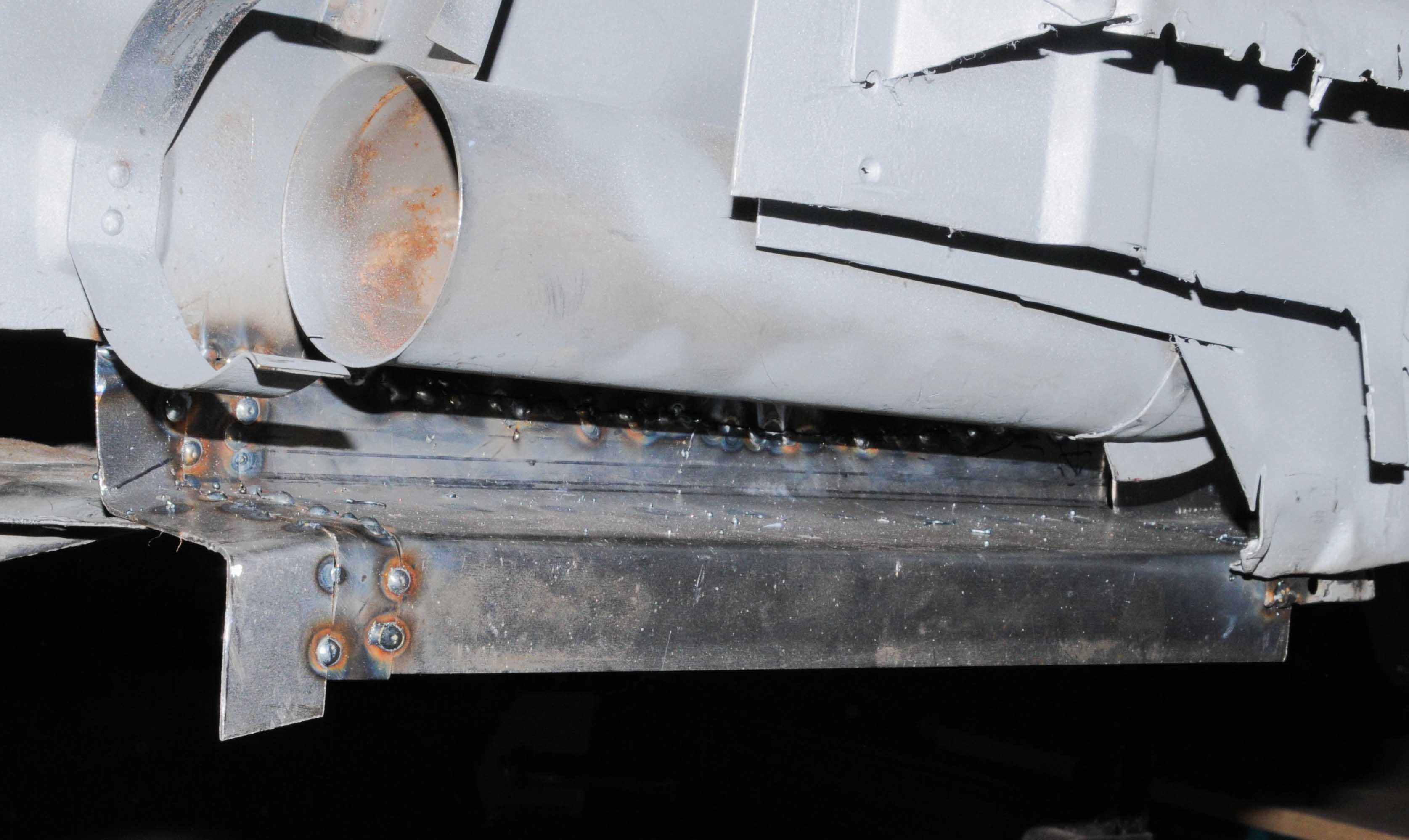

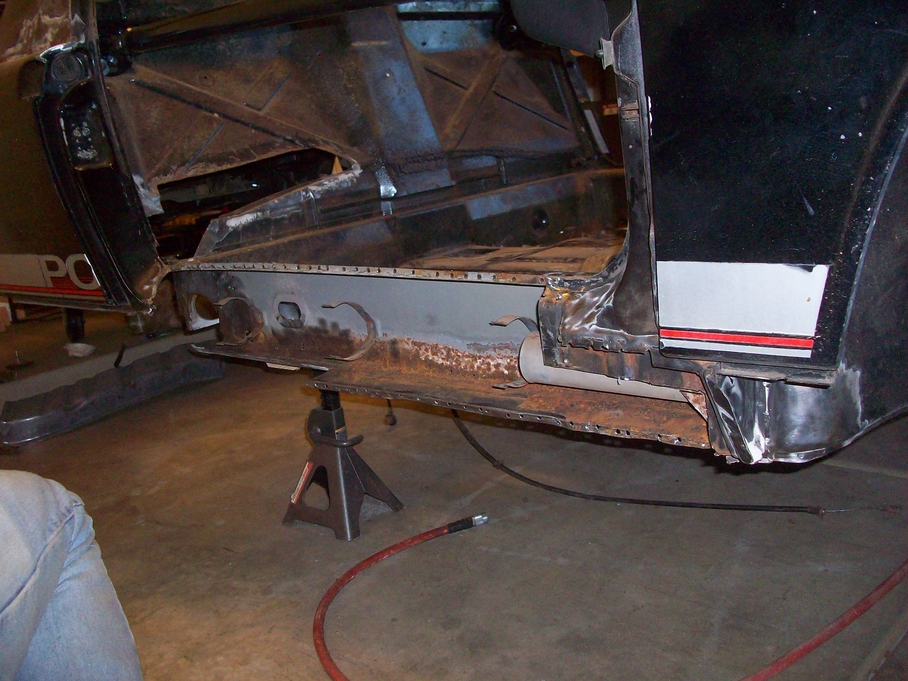

I don't feel like I had the most productive month. I spent most of it cutting out bad sections of the passenger long and then fabbing some pieces to go back on. I also fought some rust in the floor and prepped the wheelhouse for receiving its replacement after I finish the inner long.
I didn't receive any assistance from vendors, but I bought some parts from Restoration Design. The biggest challenge I faced was some extra rust and the fabricated pieces being a little more complex than I envisioned. On top of that, I found that I needed to do a lot of extra work to try and make later tasks easier. Most challenges were met and solved by patience and hope alone.
I'm really hoping November, with its 2 long weekends results in greater progress. My goals are to finish fabricating the inner long and have it fully welded in (as opposed to its current tack job), install the new wheelhouse (including finishing clearing up the surrounding area of crud and PO POR), and maybe even get everything completely lined up and the engine compartment long welded in.

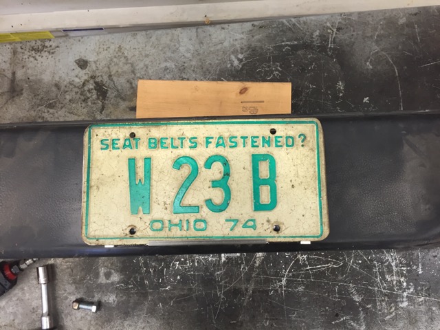

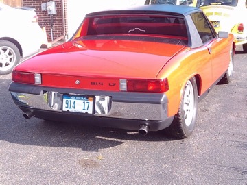

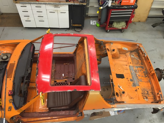

October Update:
Well I feel like I got nothing done. I have spent most of my time thinking. People like madmax914 do these neat things like engine mounts, and make me want to redo mine.
So this month, I have cut the 914 further apart. Cut a roof off a 944, and made slow progress towards getting focused and as of today, started installing the hidden hitch in my 914.
All fits behind this period correct plate.
Plate was my Grand Fathers

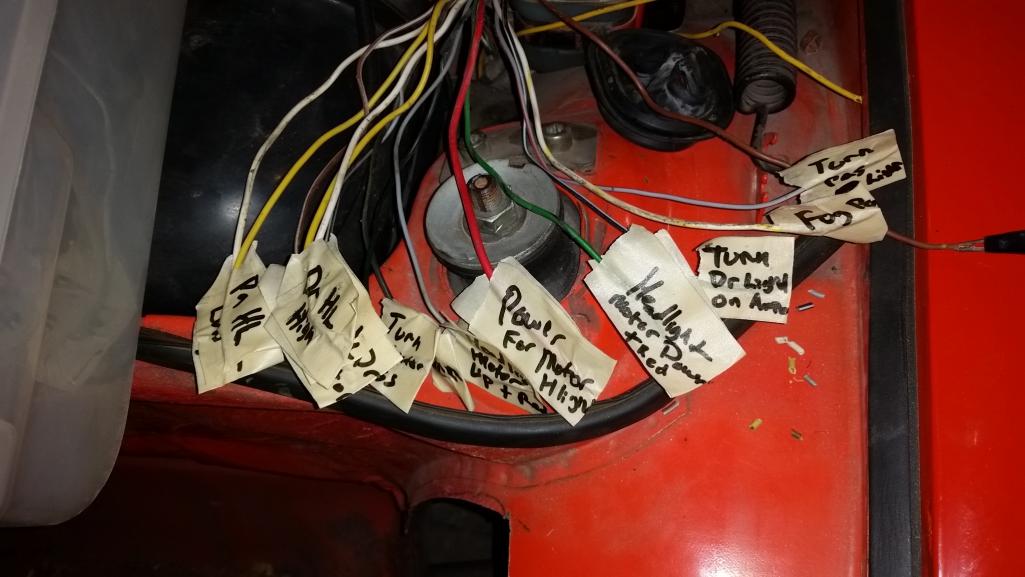

October update:
(IMG:http://www.914world.com/bbs2/uploads/post-172-1444600168_thumb.jpg)
Identified the front 914 wiring harness. Should be easy to match up to the Audi system.

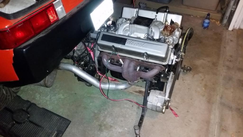

(IMG:http://www.914world.com/bbs2/uploads/post-172-1444600240_thumb.jpg)
Removed the v8 engine setup.

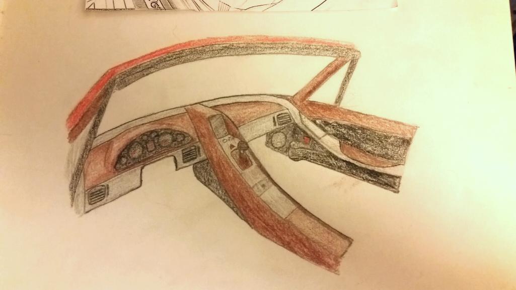

(IMG:http://www.914world.com/bbs2/uploads/post-172-1444716948_thumb.jpg)
Did some work on the interior concept. I like it a lot (IMG:style_emoticons/default/smile.gif)

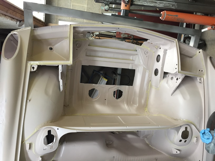

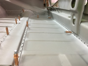

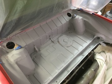

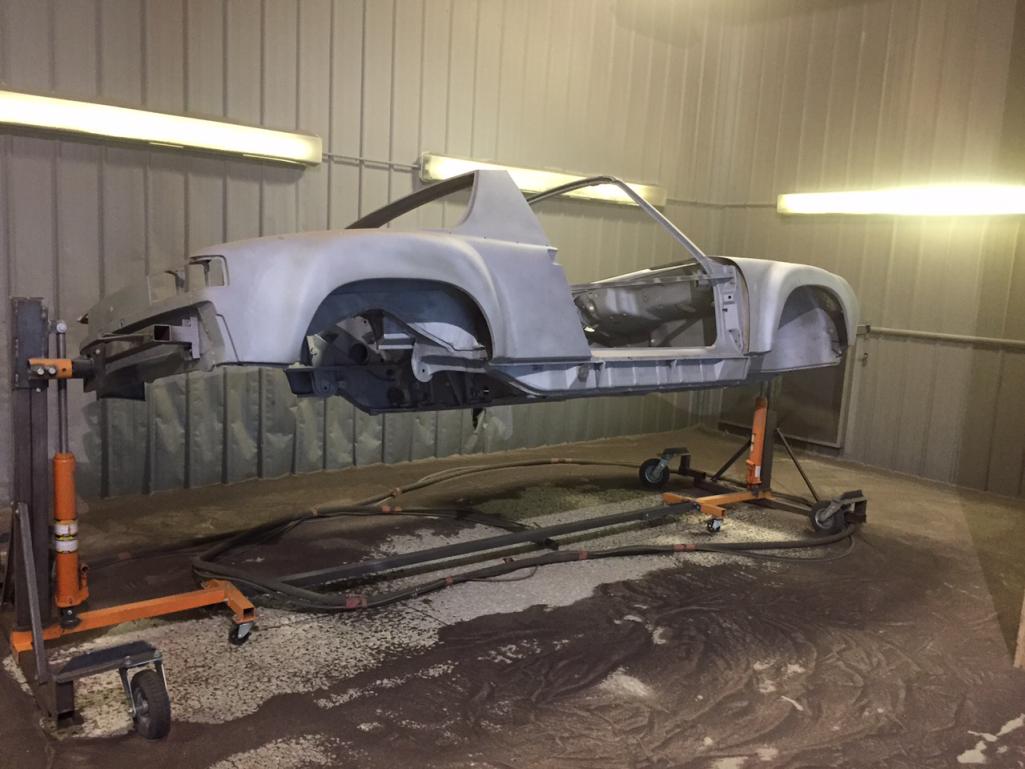

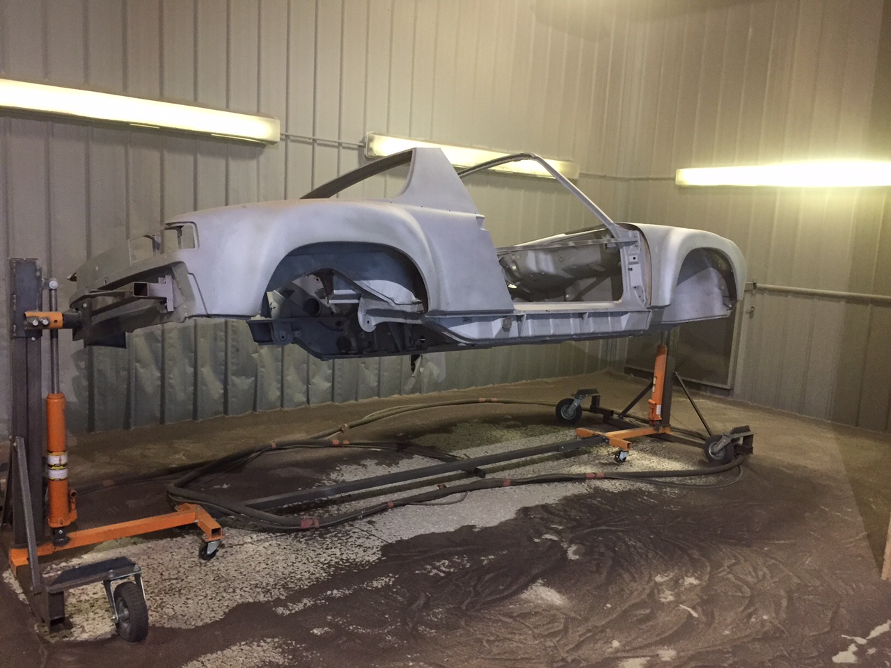

October Update:
A. A brief description of the progress you made on your build:
I have gotten the car media blasted and epoxy primed this month. I have also worked with the painter and have about fifteen hours of my own time in seam sealing with an epoxy seam sealer. This week I started sanding the epoxy primer so the painter can paint the inside of all the cars bulkheads.
B. Any unexpected challenges you encountered this month, and how those challenges were handled:
The biggest challenge has been keeping the painter focused on working on my car and not any other cars. If I go over and help then it gets worked on. I sort of understand it but I only have so much time to help.
The other challenge is that there are five bulkheads to prepare and paint instead of the normal three that most other cars have.
C. Whether any shops/vendors provided any services for the build during the month, and the value of such services:
No, unfortunately I am providing the help to the painter.
D. Progress Pictures:

Complete "Michigan Build"Project Link
9/2015
October Update: Michigan Build
Build progress :
Removed all the tail section, and the back hafe of the rear trunk pan along with a second layer of sheet metal and lots of welding wire. (IMG:style_emoticons/default/sawzall-smiley.gif) scraped lots of carpet glue off the remaining area's, lots of body filler, what a mess. Alinged, fitted, prepped and welded in the new pieces. Filled the holes for titts that were drilled in a early bumper, and hung it.
Unexpected challenges:
The previous repaired damage required a lot of time to clean up, and repair correctly before installing my parts, otherwise the body lines would be off.
Vendors:
I purchased the rear trunk pan from Restoration Design, great vendor.
Progress Pictures:
