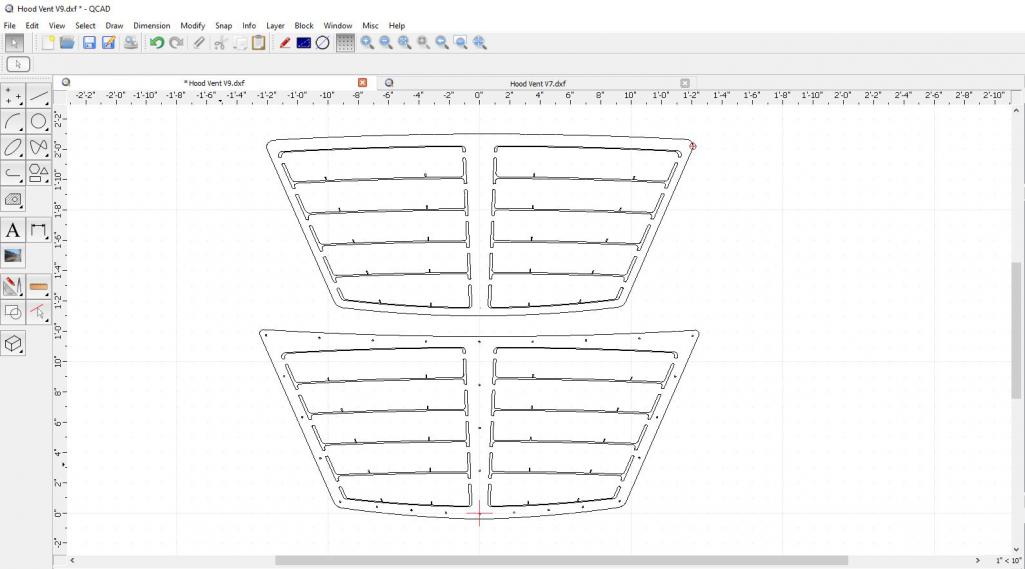

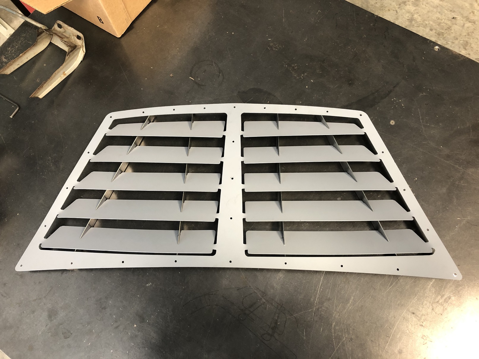

Previous version (top) vs latest. The latest has:
- wider frame dimensions because the previous frame looked a bit "light"
- trailing edge radius flipped. This is the element that's giving me the most trouble. I'm struggling with what works best with the 914's design elements. I think I like this better but it may be that a simple, straight line is the way to go... (IMG:style_emoticons/default/idea.gif)
- leading edge radius modified to better match the hood leading edge
- fastener/rivet holes
This whole "design" thing is soooo time consuming. I second guess every change.
And the whole "I have to make it and see it on the car" isn't helping! (IMG:style_emoticons/default/screwy.gif)

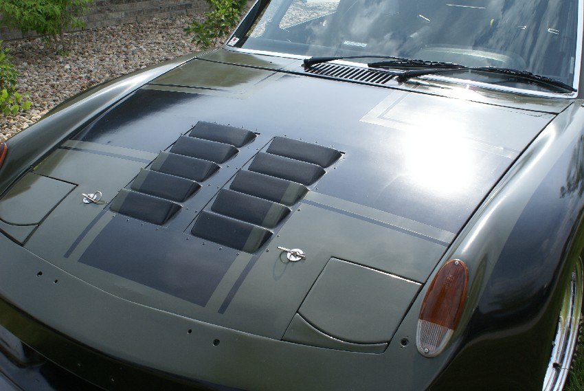

I always kind of liked what byndbad914 did with his hood vents. They are somewhat flush mounted (really lower mounts with rivets, but frameless). A bit more agressive than yours though.
(IMG:http://www.914world.com/bbs2/uploads_offsite/www.negativereinforcementracing.com-1659-1585237351.1.jpg)
http://www.914world.com/bbs2/index.php?showtopic=204965
http://www.negativereinforcementracing.com/update.htm
@jd74914 - Yep, I've liked that set up, too.

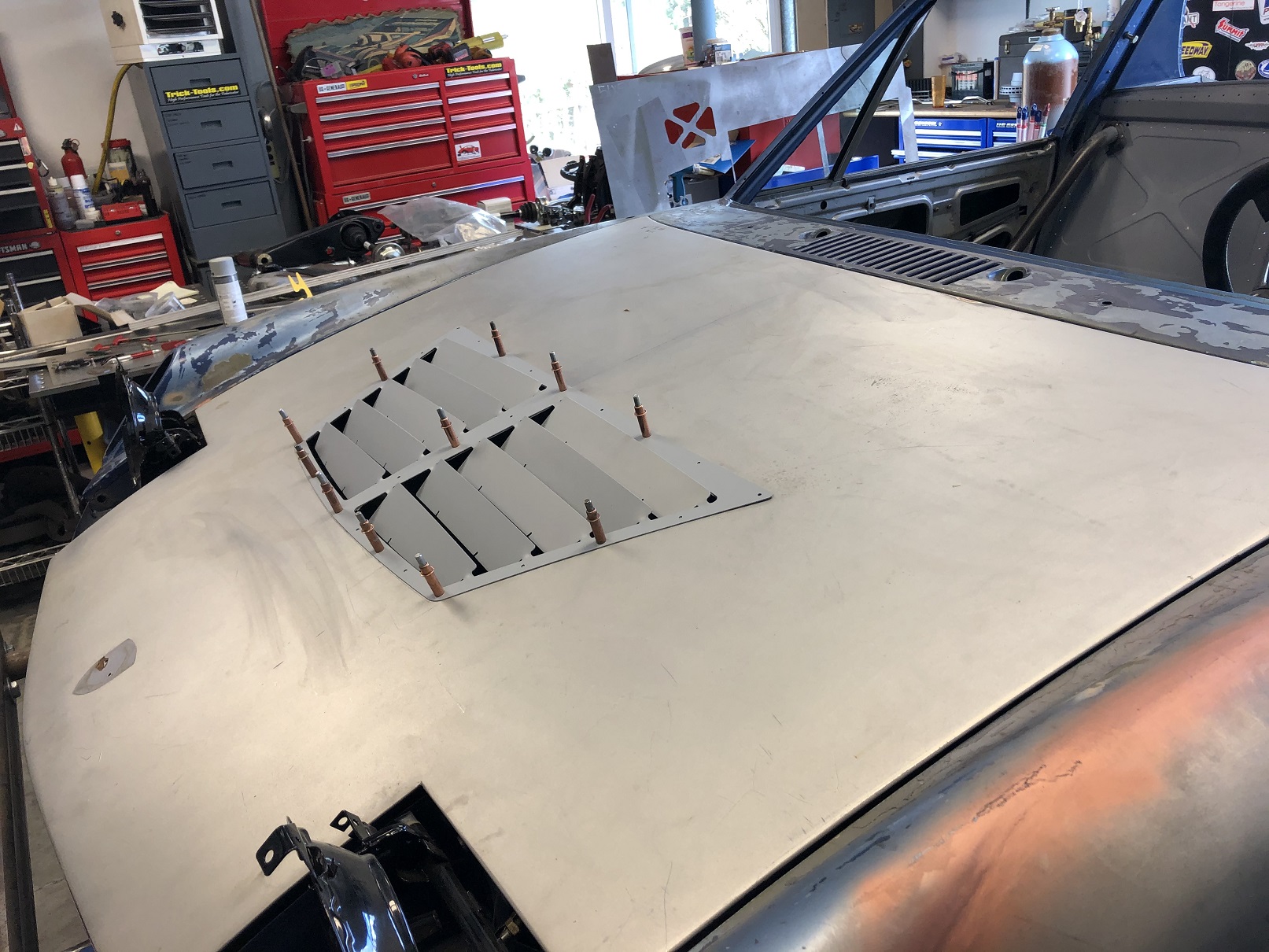

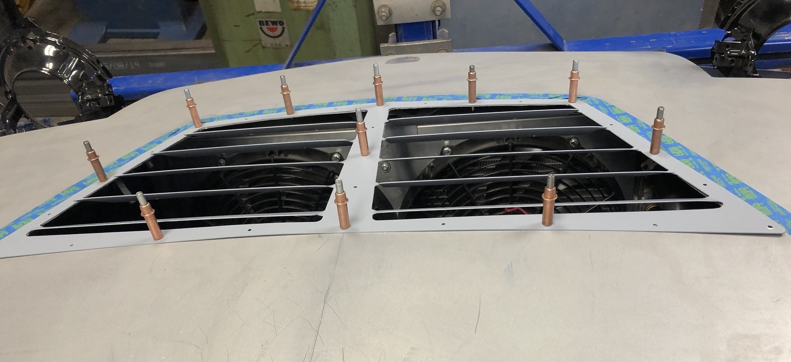

Test V1. The good news is this hood was worse than I thought! LOTS of filler and other damage so I don't feel bad about cutting it up.
So, regarding Function and Form:
Does this look like it'll work to vent the radiator? Certainly.
Do I like it how it looks? I don't know.
I need to look at it for a few days.
post Mar 26 2020, 03:28 PM
Post #2431
Posts: 5,858

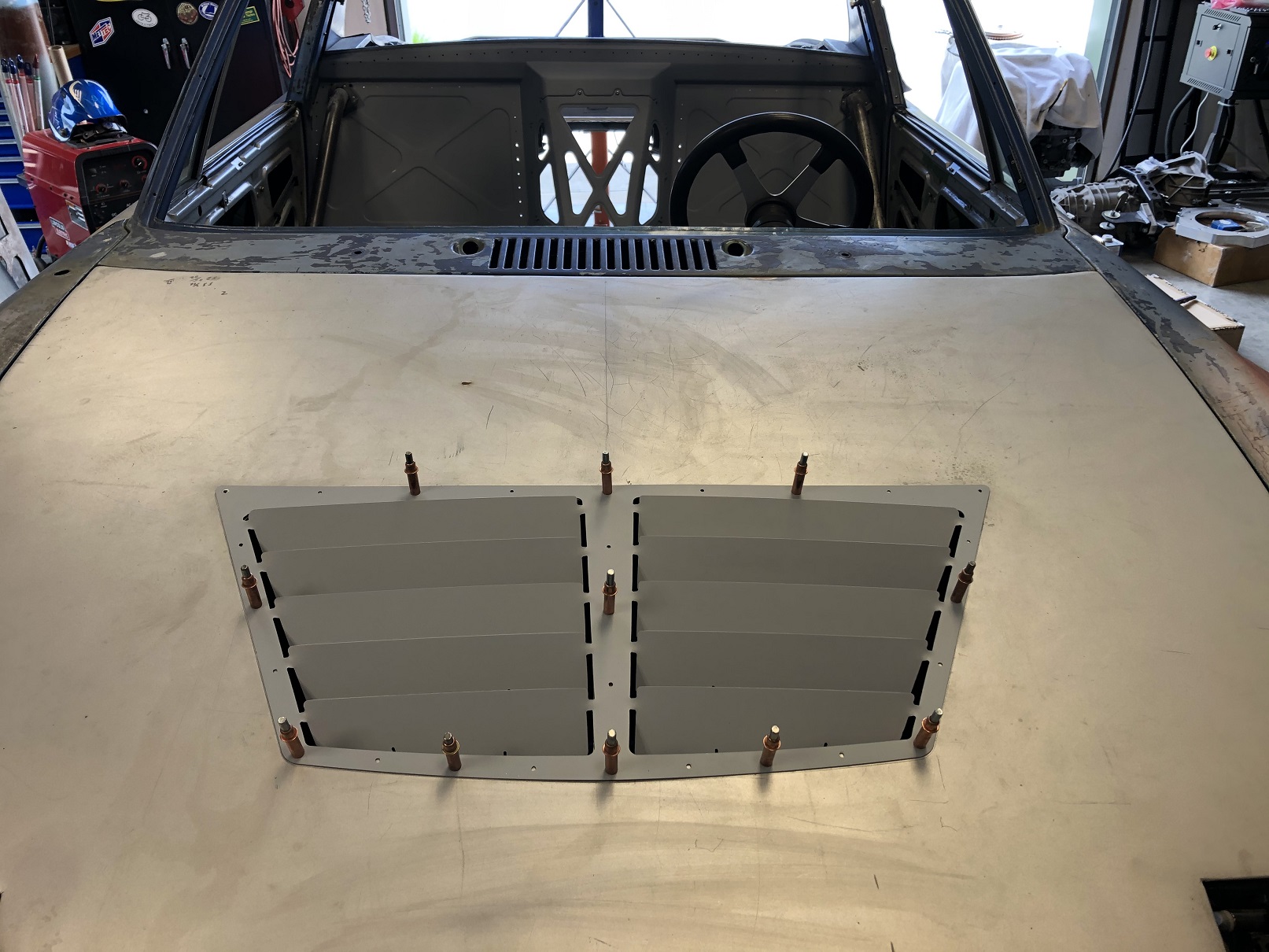

I do like the way the rivets on the vent tie in with the fire wall rivets. And the angles/corners seem to work well together, too.
post Mar 26 2020, 04:56 PM
Post #2432
Posts: 5,858
Better perspective on the "will it work?" aspect. Essentially a giant hole. OK, so really two medium holes... (IMG:style_emoticons/default/biggrin.gif)
I may add some ducting to help it flow as efficiently as possible.

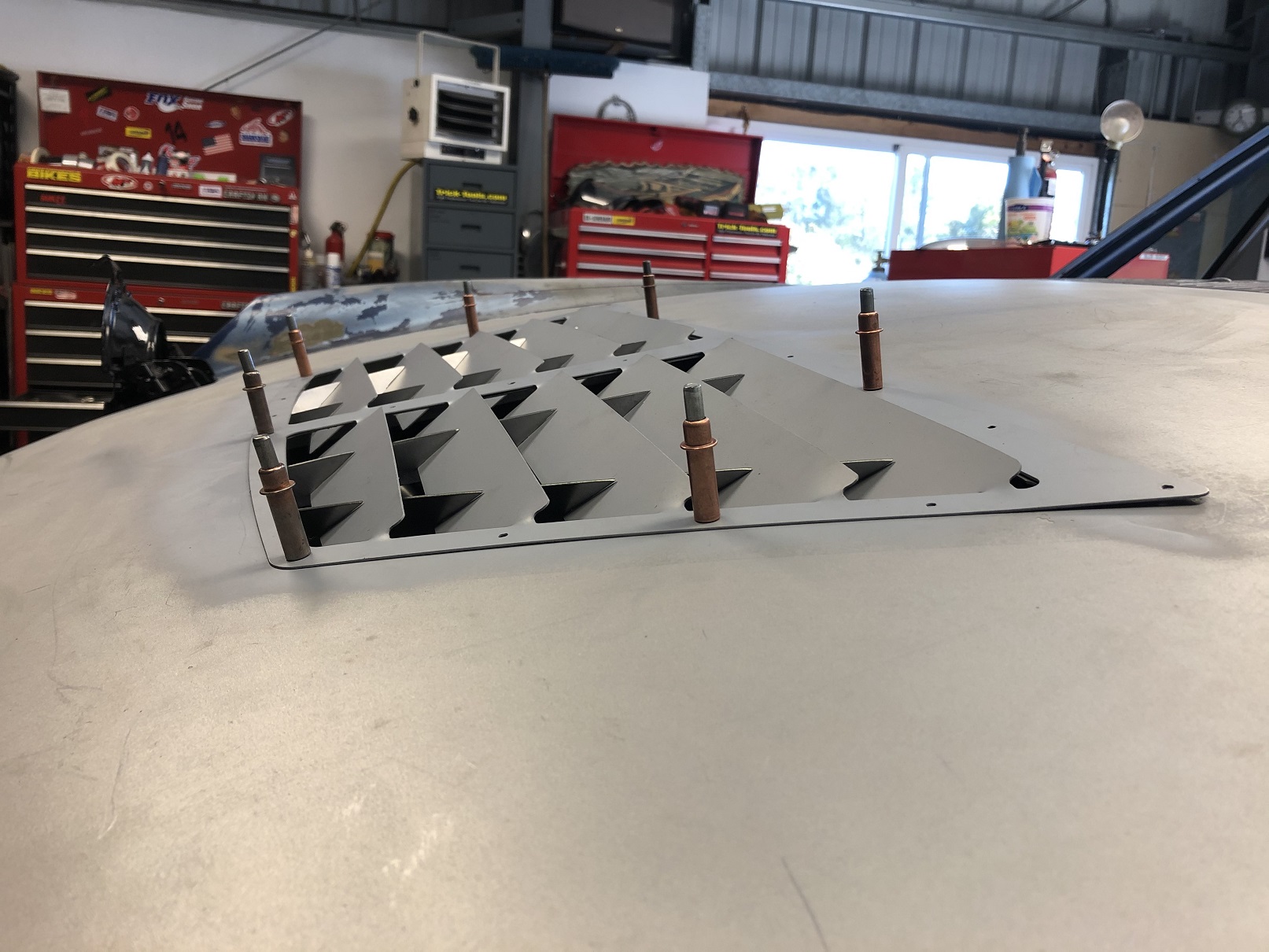

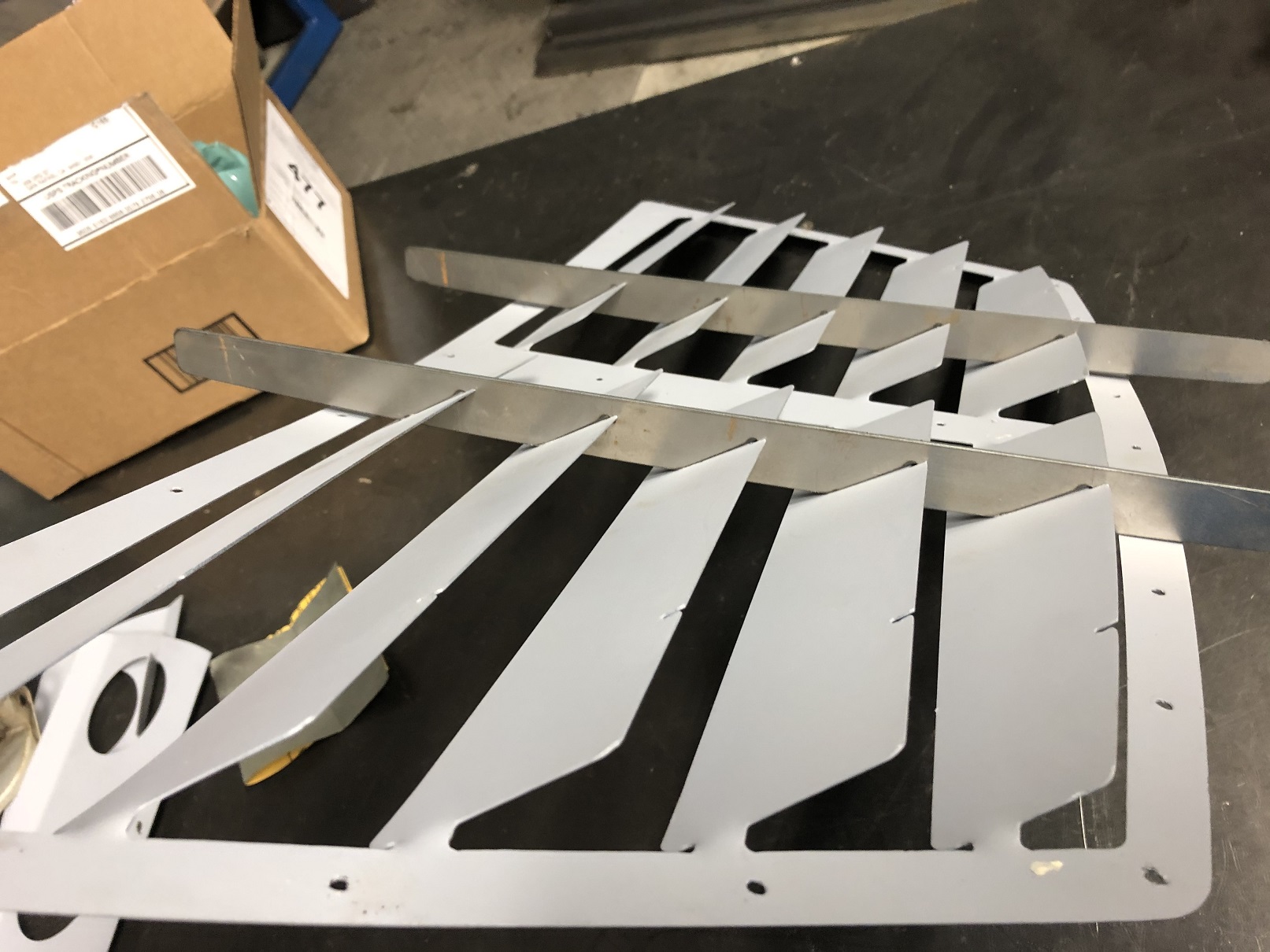

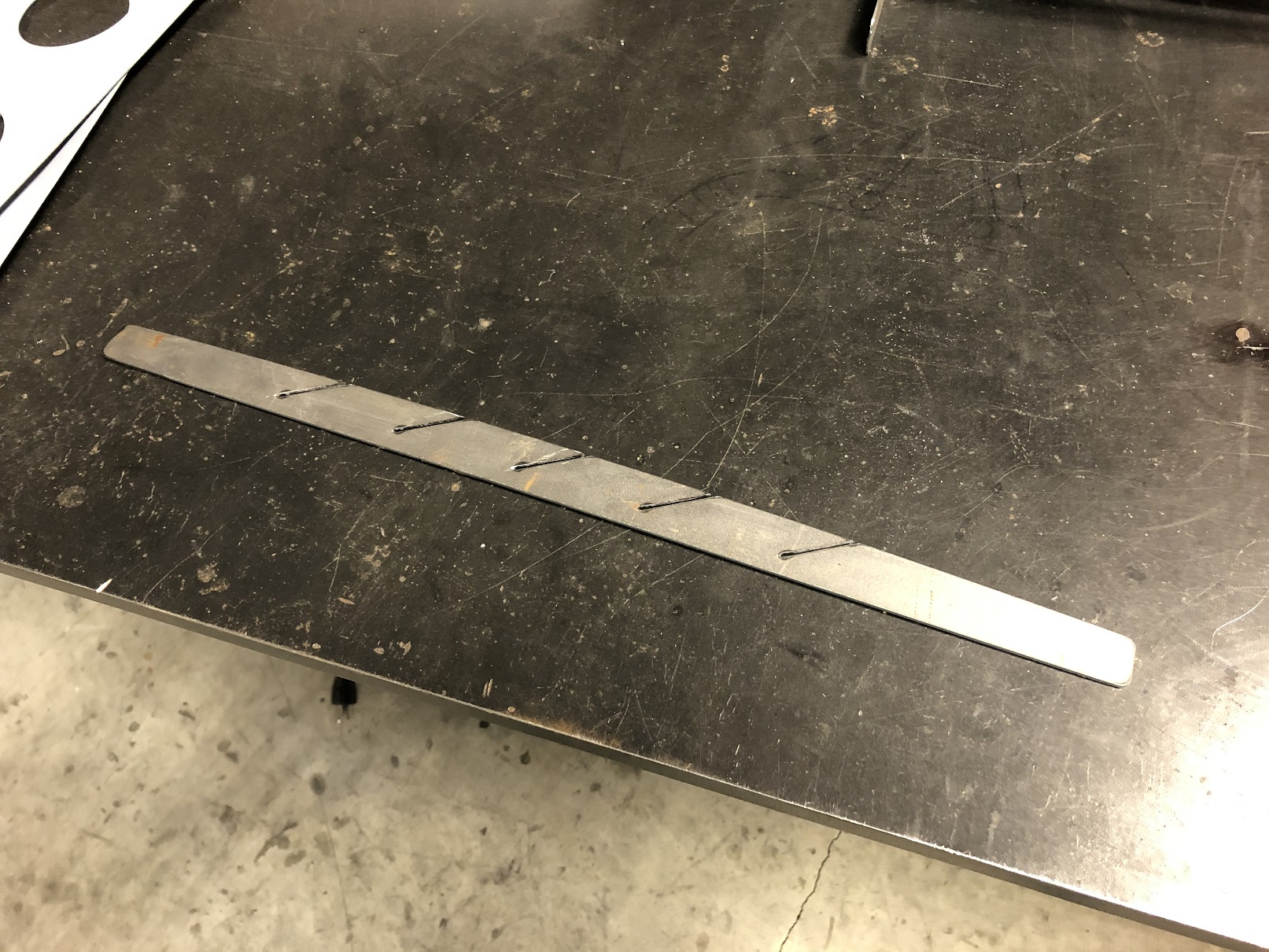

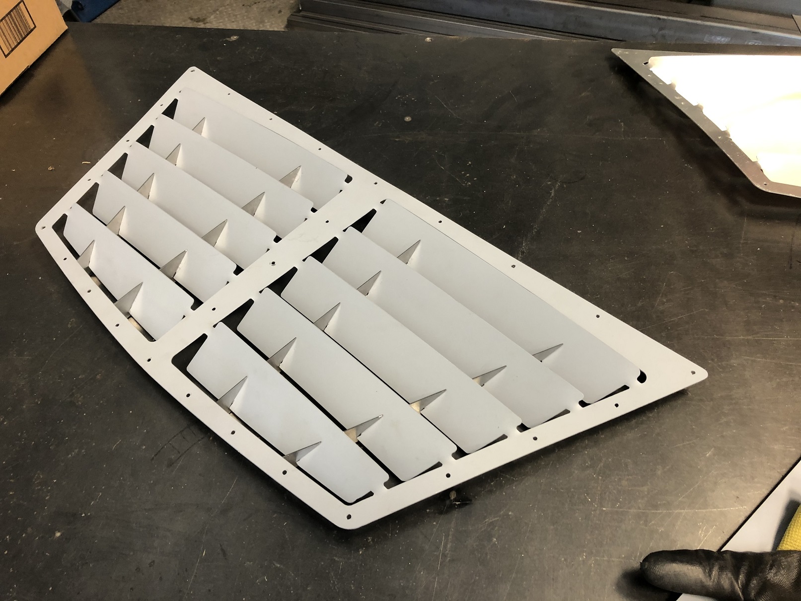

Initial draft of the inner vent strake. I need to prove out my math and determine where to add the mounting tabs but this is where I started. Total guess work, but what else is new? (IMG:style_emoticons/default/laugh.gif)
post Mar 31 2020, 05:08 PM
Post #2435
Posts: 5,858

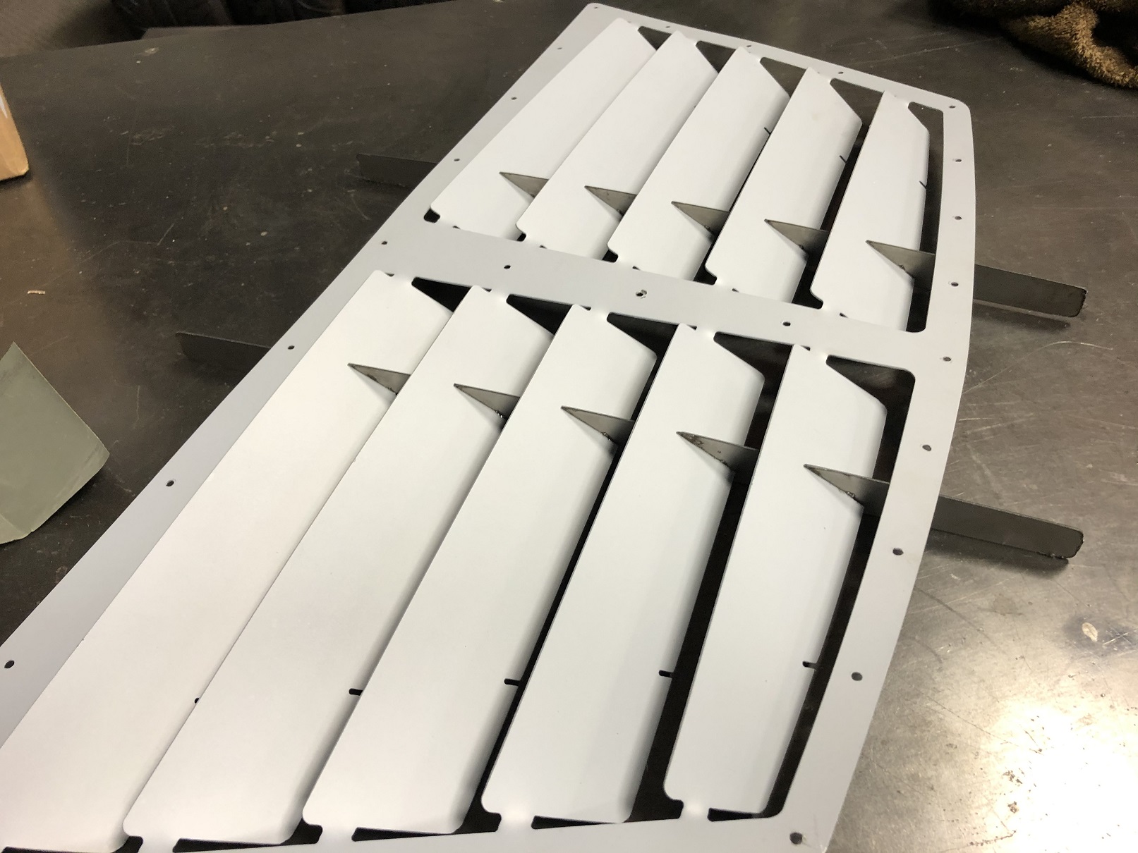

Fit strake slot A into vent 1's slot A... A little fiddling to get everything to line up and things lock into place. (IMG:style_emoticons/default/cheer.gif)
post Mar 31 2020, 05:09 PM
Post #2436
Posts: 5,858
I think this will look pretty cool. Maybe do the strakes in a contrasting color? We'll see.
On to fabbing the outers.

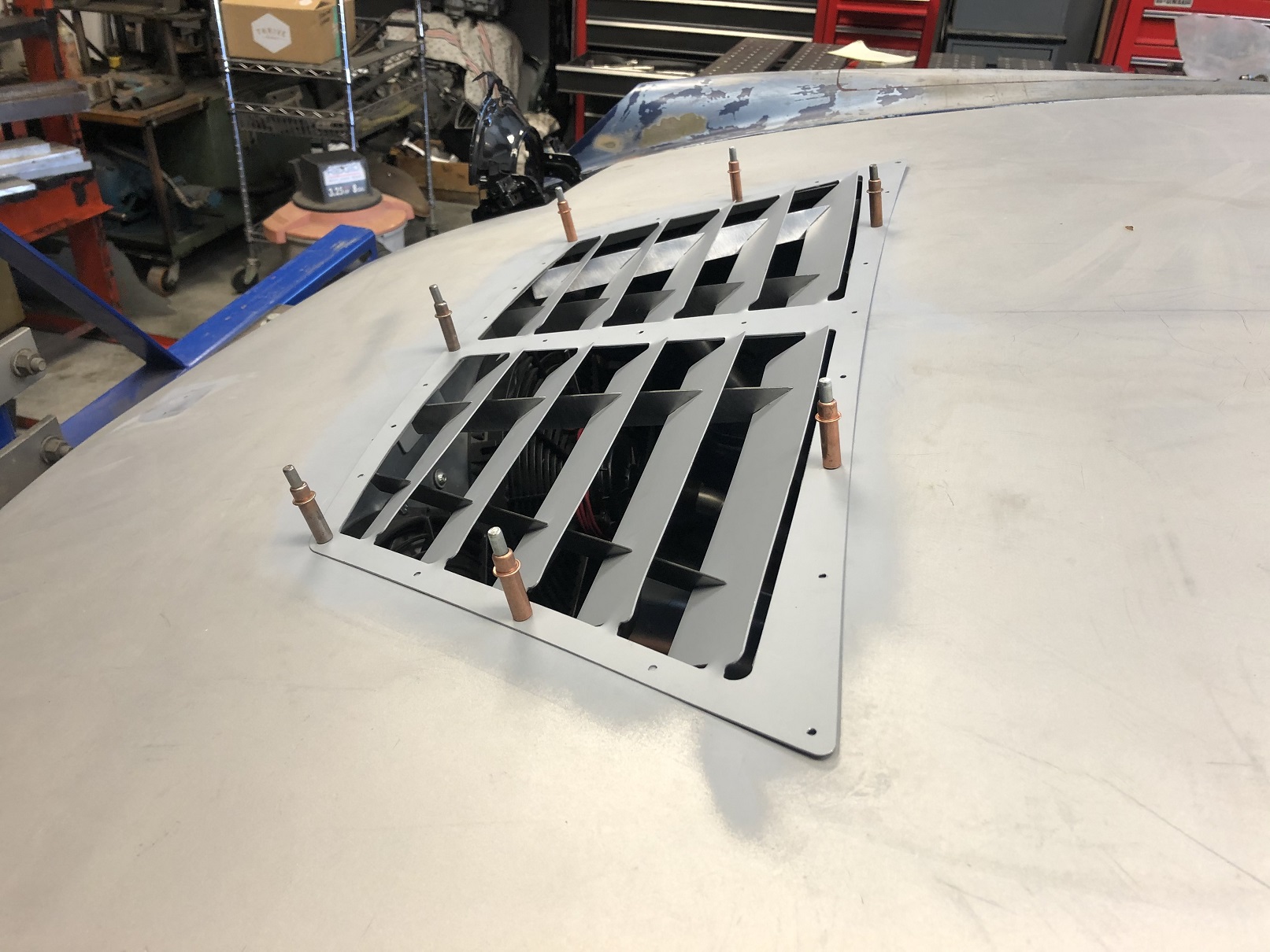

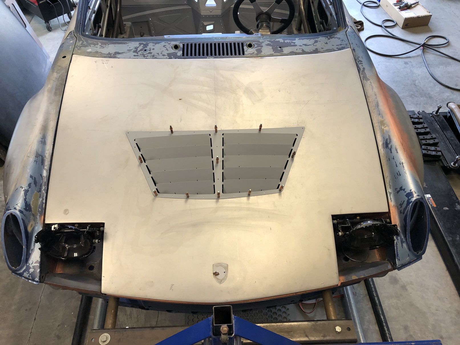

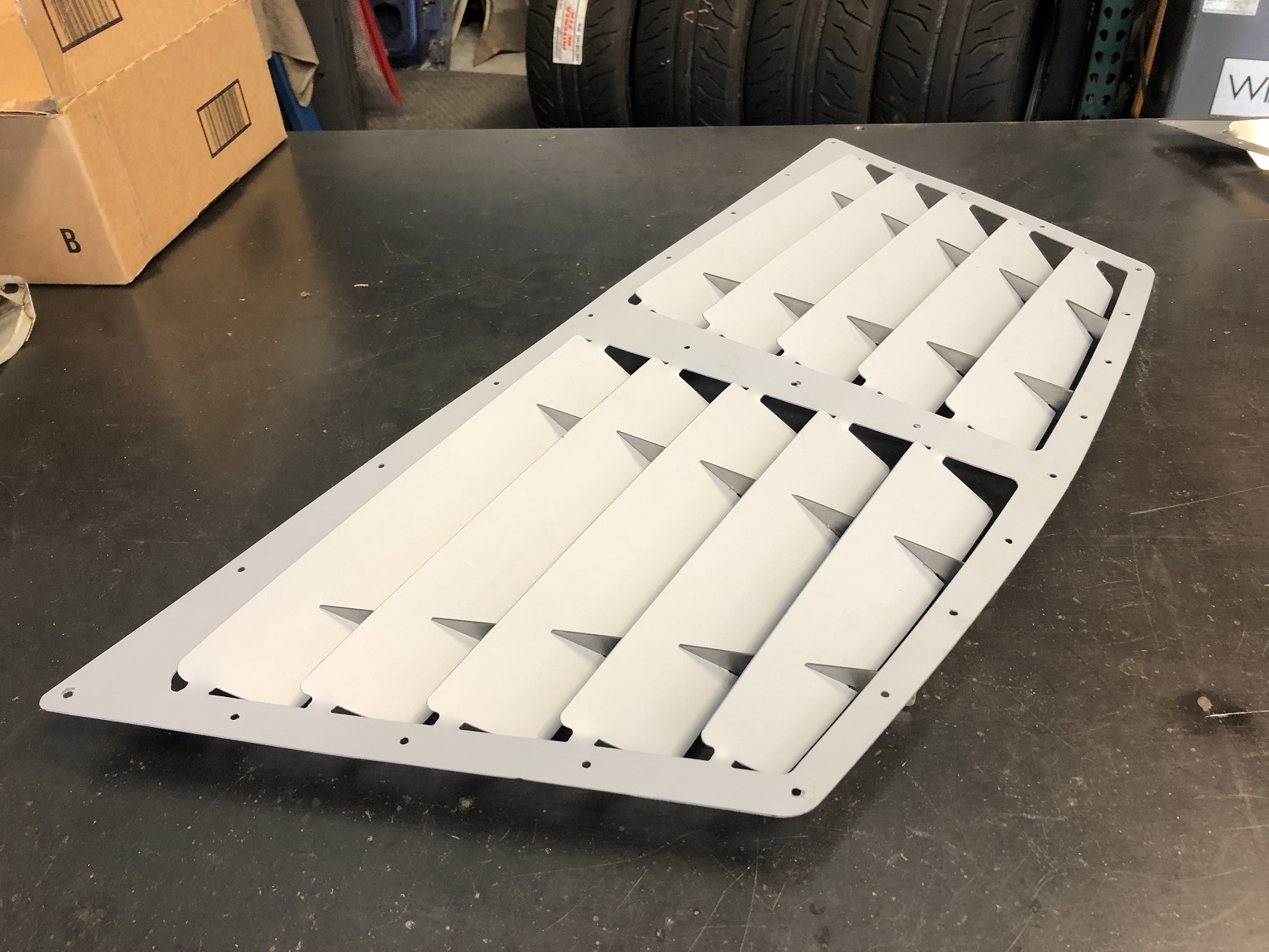

Strakes completed and fit.

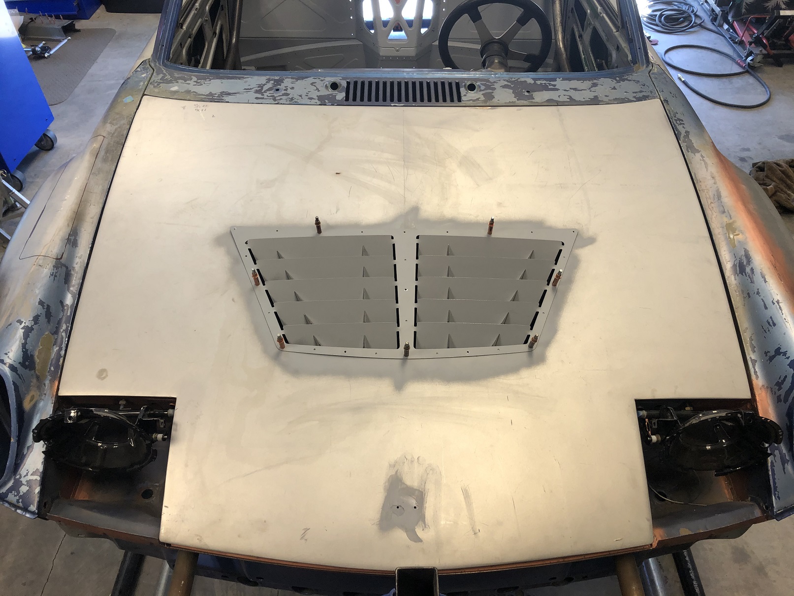

post Apr 1 2020, 01:11 PM
Post #2439
Posts: 5,858
And on the car.
As always, I see a couple things I need to change and a couple I want to change.
A few updates to the CAD file and I'll cut all new pieces, including the main panel.
I hate to toss this one as it really is a usable piece so if anyone wants it, as is, PM me. Shipping costs only from 94952.

That is coming along quite nicely especially once those strakes are installed. Compound angles like that throw my brain for a loop so that's very impressive.
How would you feel about moving them outward towards the edges and adding a third strake in the center?
P.S. I'm tempted to take that one off your hands to put on my stock -4 just cause it looks so cool (IMG:style_emoticons/default/aktion035.gif)
