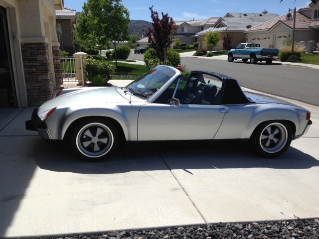

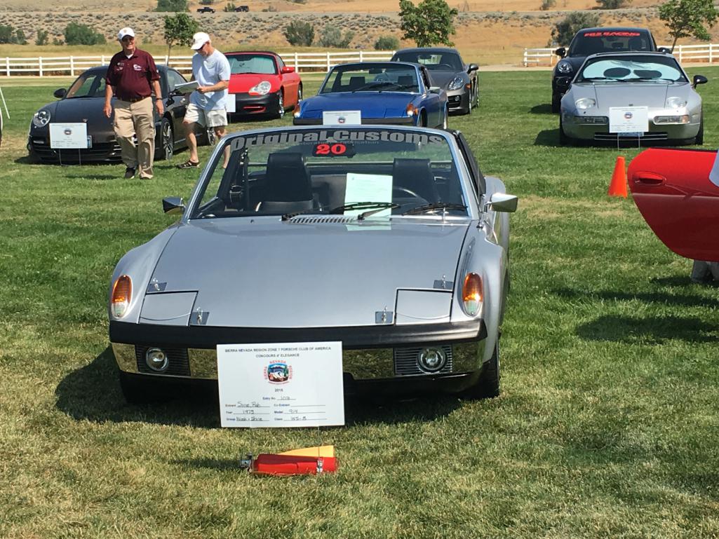

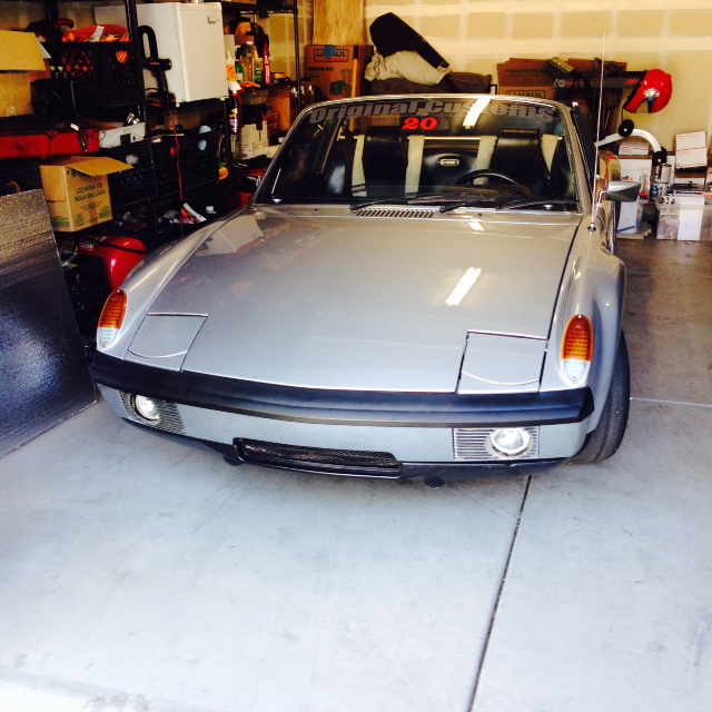

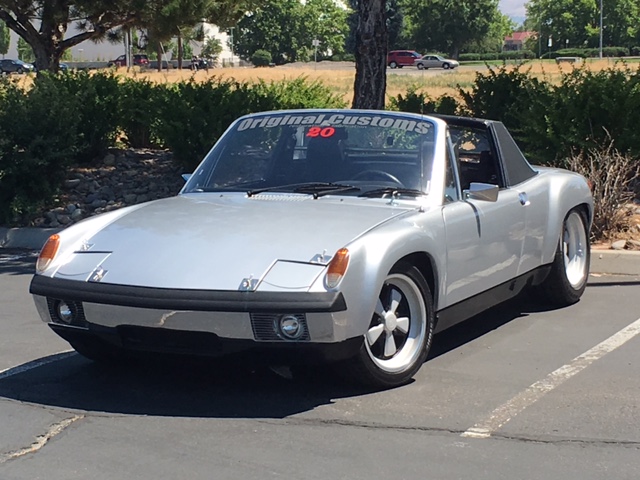

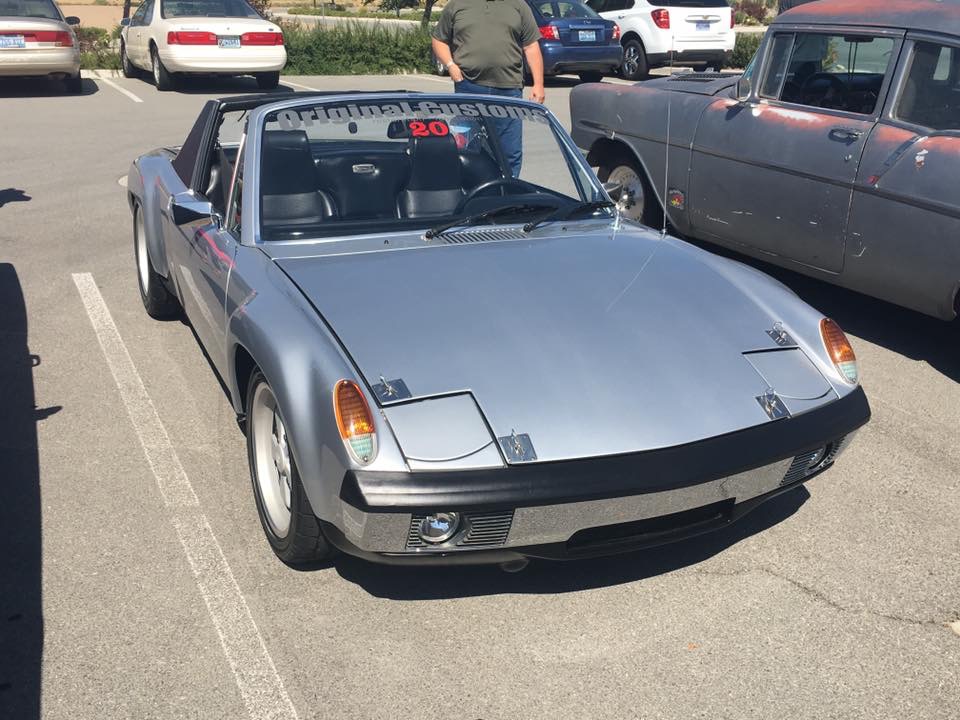

I have Getty Design front and rear deck lids and lower valances all the way around. The lids are perfect without any reworking. The side covers and lower valances will need to be reworked for the flares but as every flare installation is different, I'd expect that.
Attached Image Attached Image Attached Image Attached Image Attached Image Attached Image

QUOTE(ConeDodger @ Jan 13 2017, 12:51 PM) *
Are yours the "regular" 914 hood and trunk lid or Getty's "914-6 GT" version?
I'd be curious if there's any difference in fit between the two.
BTW: Dang! Your car is beautiful! Great work...
ConeDodger
post Jan 13 2017, 04:09 PM
Apex killer!
Posts: 24,396
Joined: 31-December 04
From: Tahoe Area
Member No.: 3,380
QUOTE(tygaboy @ Jan 13 2017, 06:45 PM) *
Thanks Chris! They are the GT version with the balsa. Basically a reproduction of the factory GT lids.
