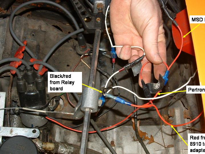

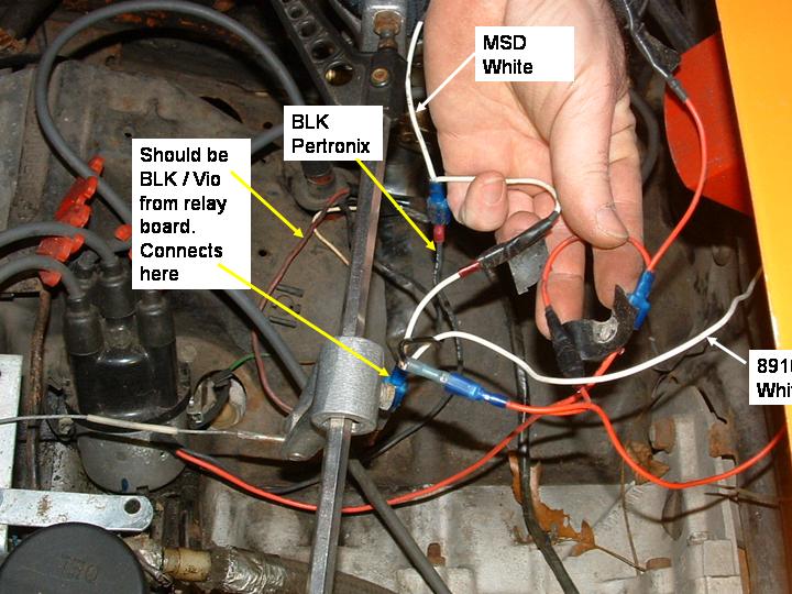

It took me a while to get my tach working using a Pertronix, MSD 6AL and the 8910 tach adapter. I had a couple of incorrectly colored wires that caused me much grief in the process. The set up was on a 72. I had a red wire coming from the relay board that should have been black/violet and a solid black wire that should have been black/red. It forced me to read and understand wiring diagrams. Once I discovered the wire color mismatch I got it hooked up and it worked just like it should.
Here are a couple of 2 pics of how I had it all hooked up. First pic covers the white wiring. Second covers the red wiring.
Also, the oragne wire from the MSD goes to the positive side of the coil. The MSD black goes to the negative side of the coil.
Do you have a Pertronix installed?

Holy shit!!! I'm amazed that I was able to get the pic to actually post like I wanted!!! (IMG:http://www.914world.com/bbs2/html/emoticons/biggrin.gif)
Here's the red wiring. My fingers are crossed hoping that this one works also. (IMG:http://www.914world.com/bbs2/html/emoticons/laugh.gif)

Well the pics almost worked right. (IMG:http://www.914world.com/bbs2/html/emoticons/unsure.gif)
The first pic had a label cut off that should have been "8910 white"
The second pic had 3 labels cut off " MSD Red", "Pertronix Red", and "Red from 8910 tach adapter"
