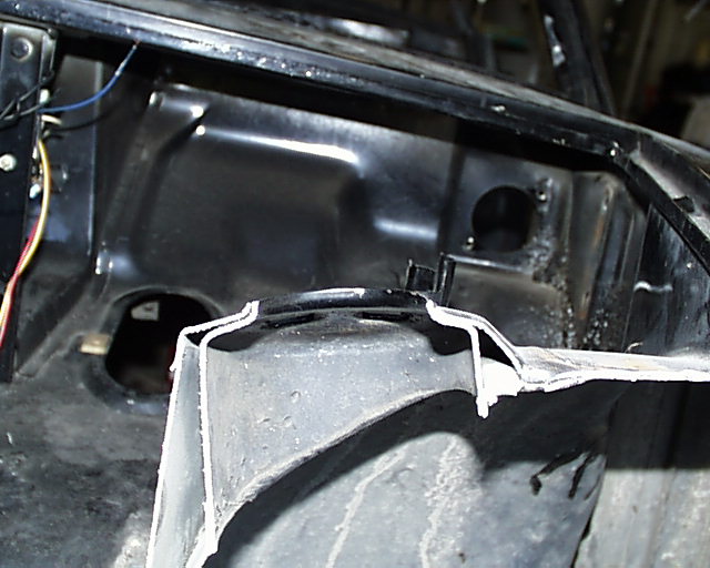

detail view:

I got more:
Cross section pictures of a 914, rare view for most (IMG:http://www.914world.com/bbs2/html/emoticons/smile.gif)
