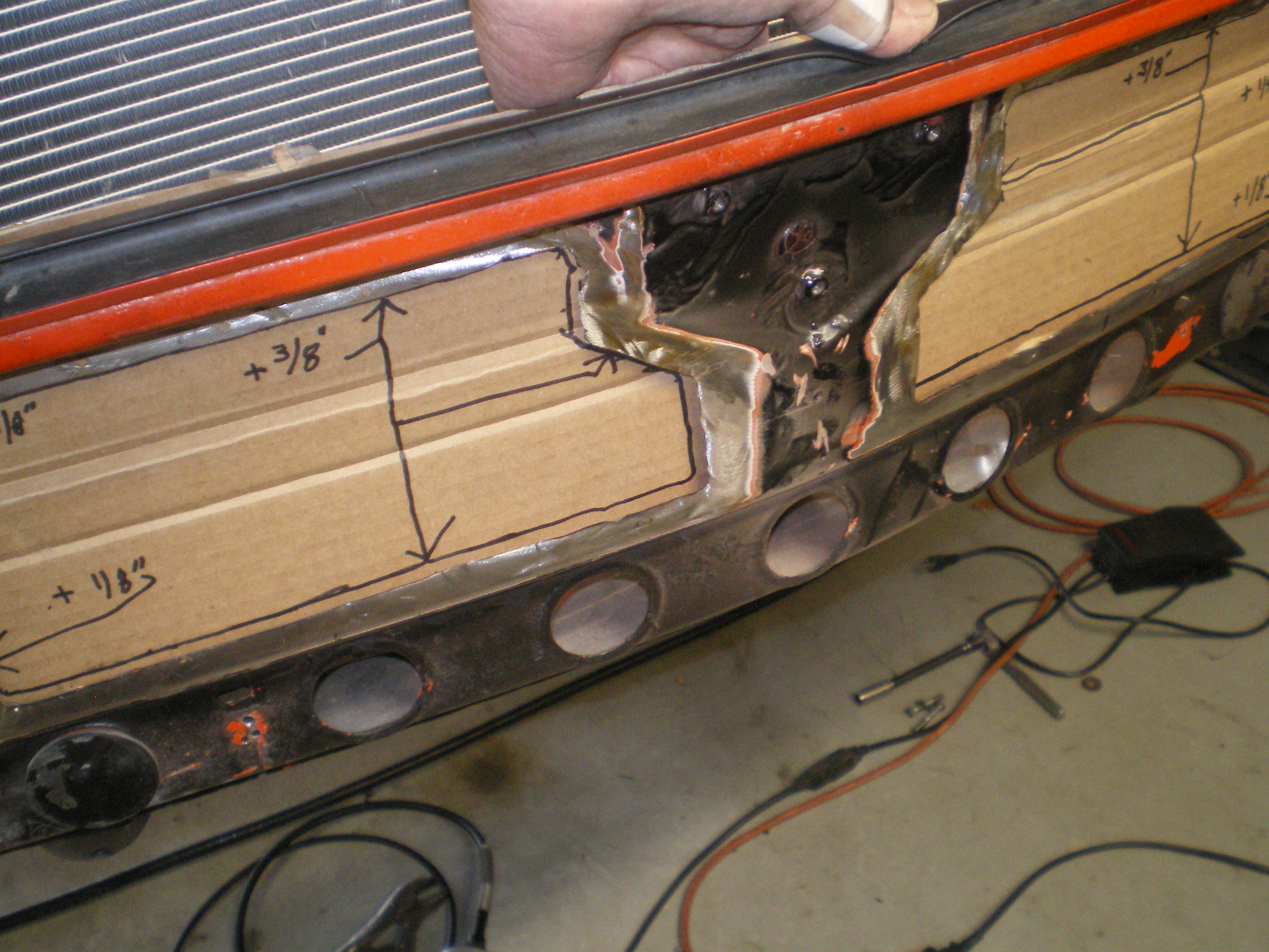

post Sep 29 2021, 09:37 AM
Post #121
Posts: 13,993
Joined: 23-January 09
From: Temecula, CA
Member No.: 9,964
76-914

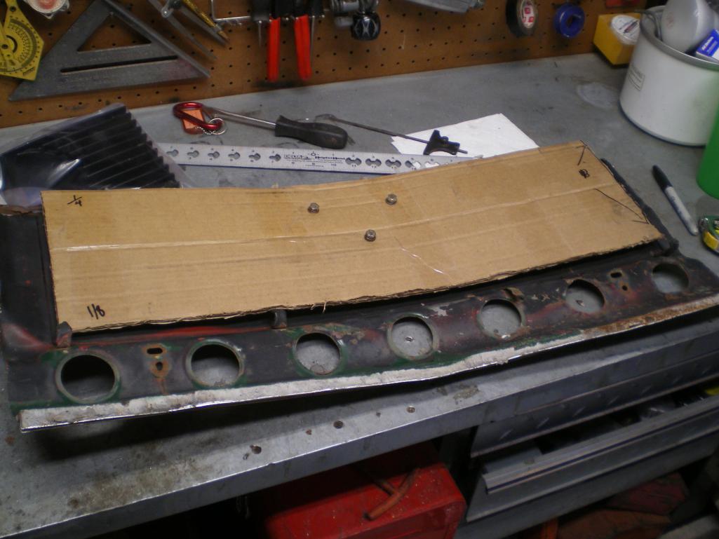

76-914
post Sep 29 2021, 09:41 AM
Post #123
Posts: 13,993
From: Temecula, CA
Member No.: 9,964

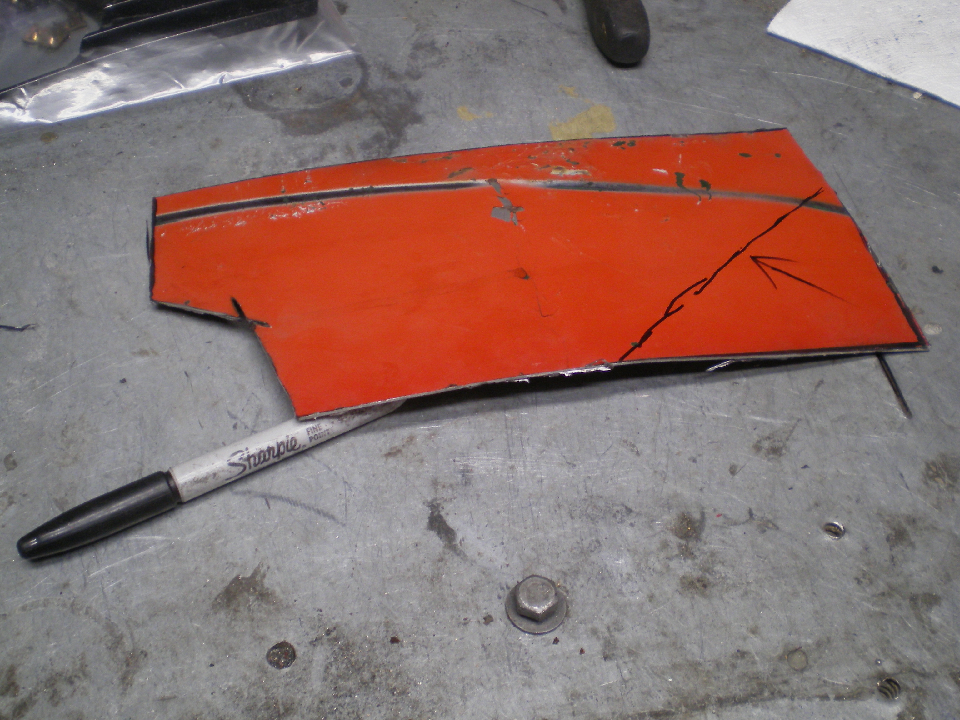

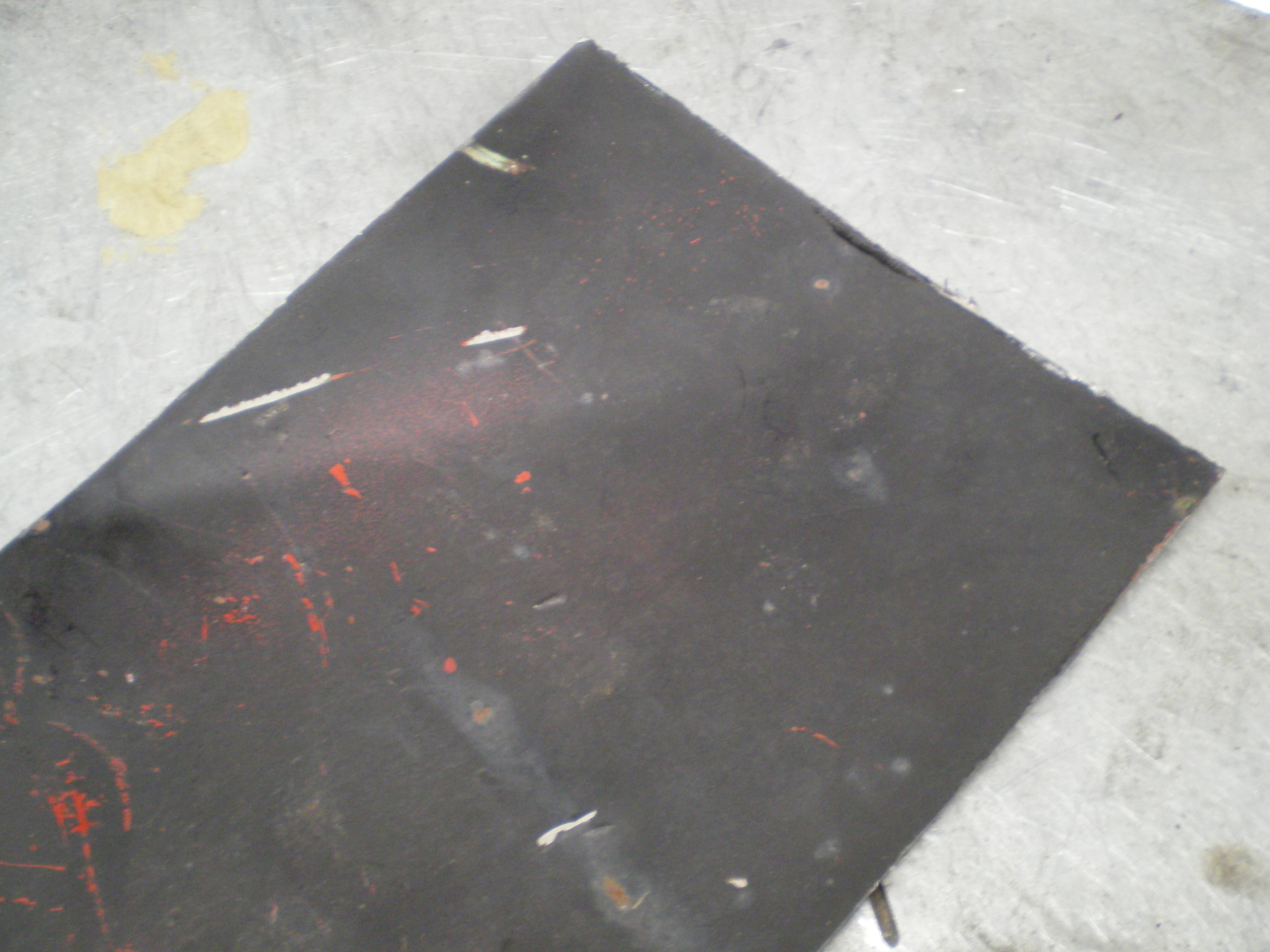

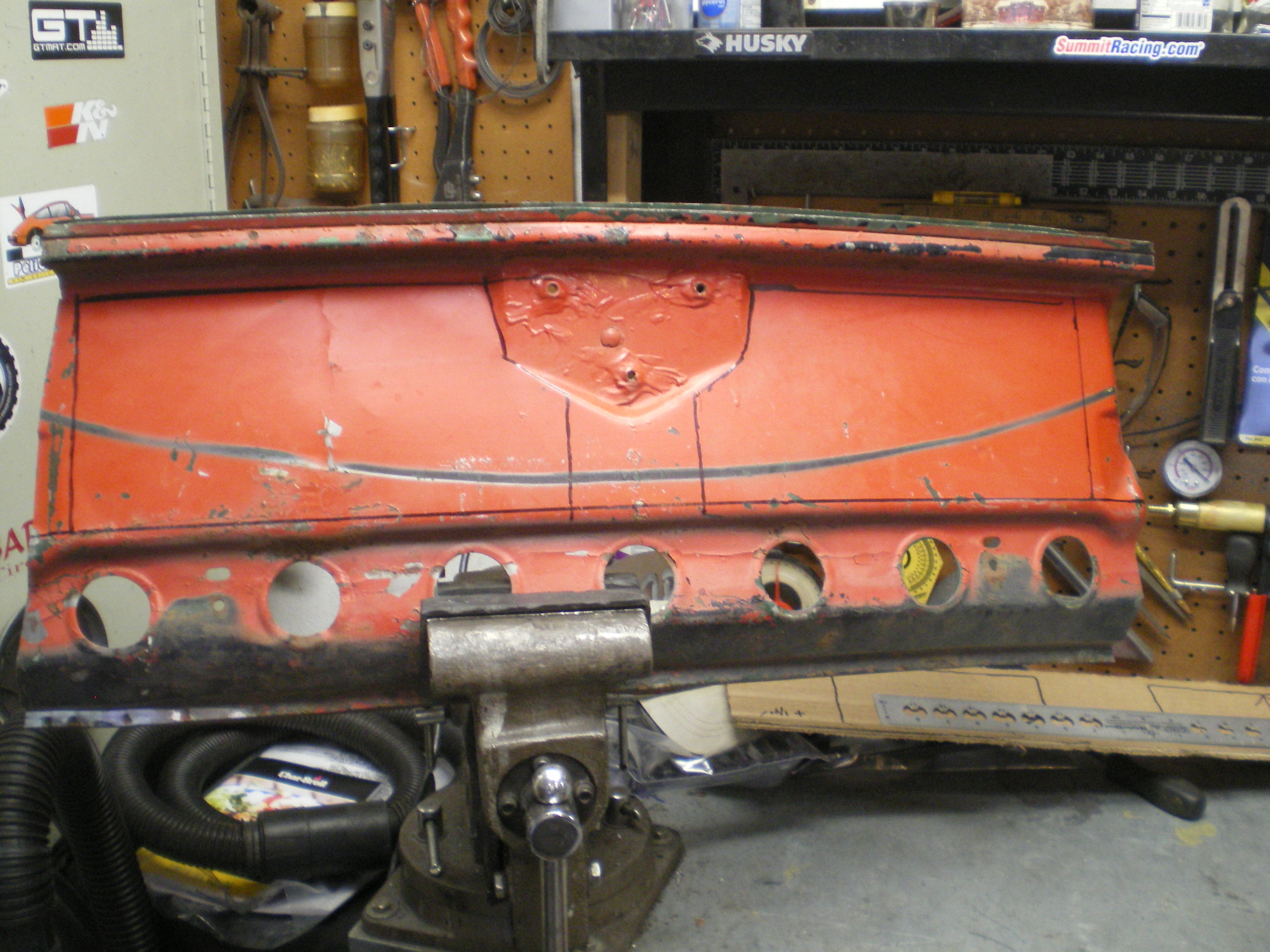

Oddly enough, this piece revealed a crease once it was cut away from the donor part. No problem as it was easy enough to hammer out. I drew a line across the crease in the pic above. This is the backside but it is still visible.

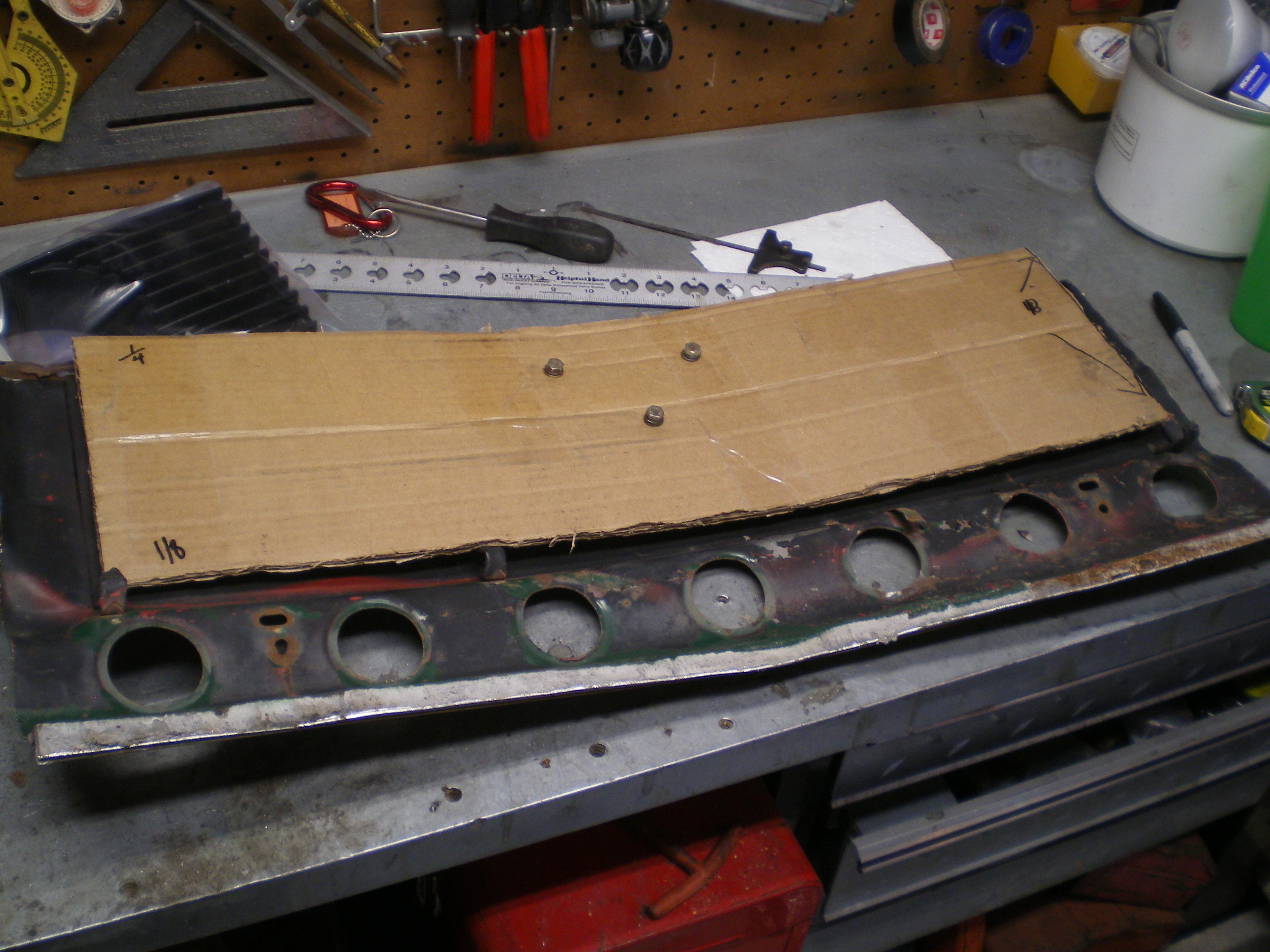

76-914
post Sep 29 2021, 09:47 AM
Post #124
Posts: 13,993
From: Temecula, CA
Member No.: 9,964

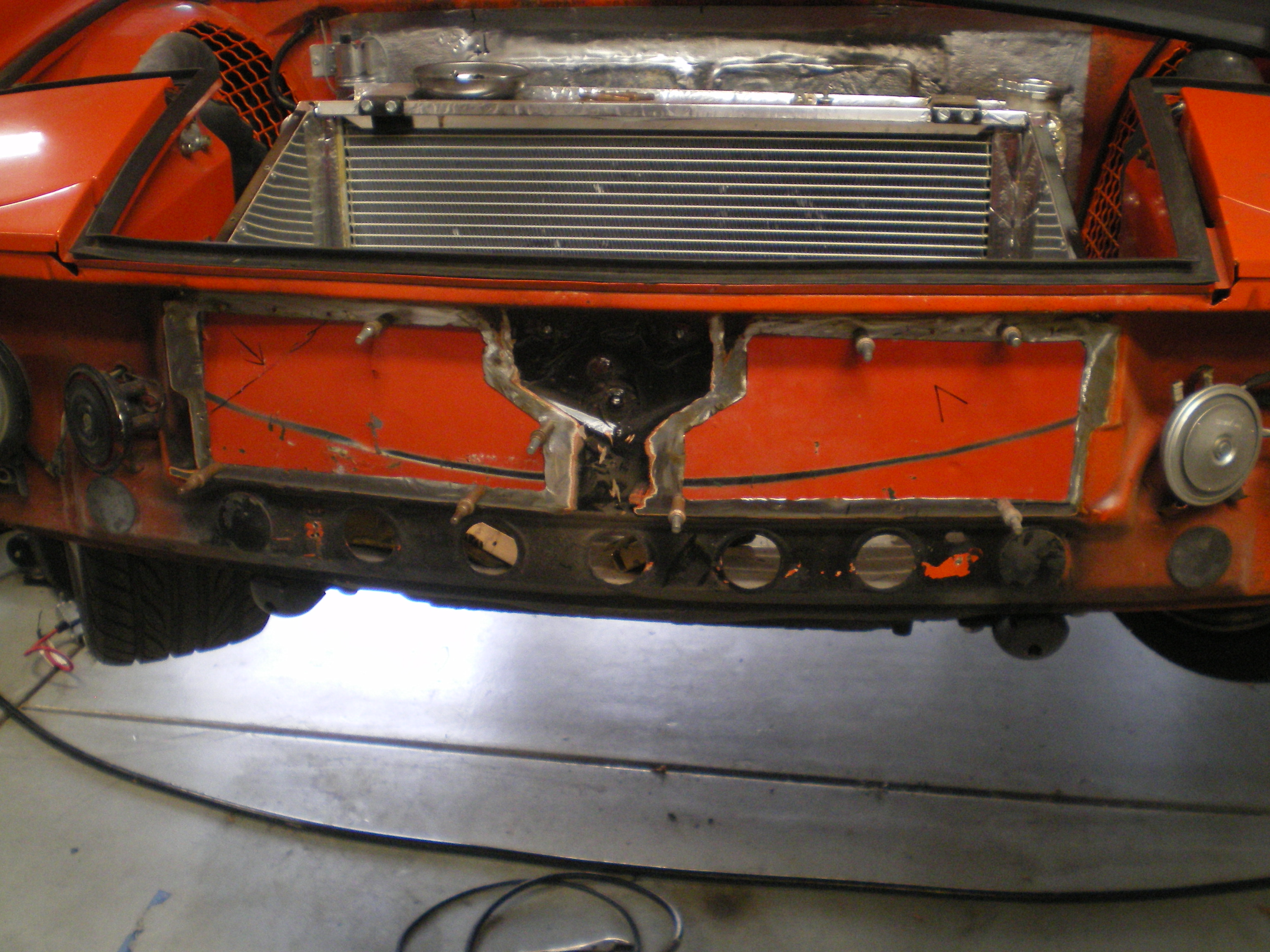

Cleco's & patch piece's in place for final trimming. I will trim and weld them in place within the next day or 2. Currently I am serving time in the Honey Do Hotel and have been tasked with cleaning the windows and replacing the screens. (IMG:style_emoticons/default/sad.gif)

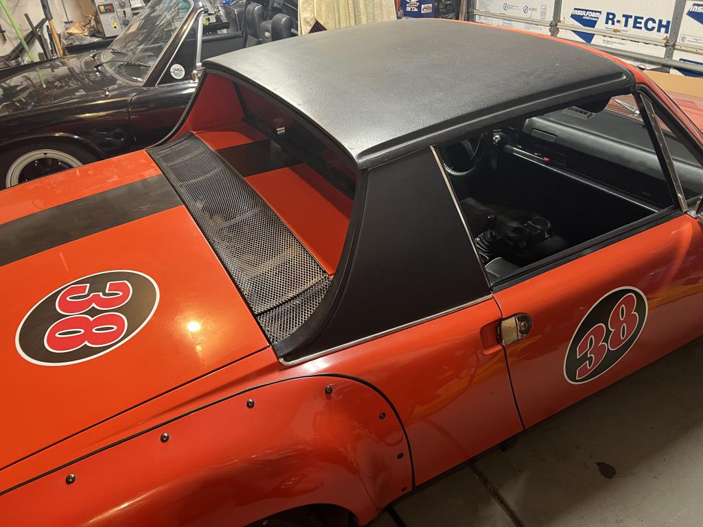

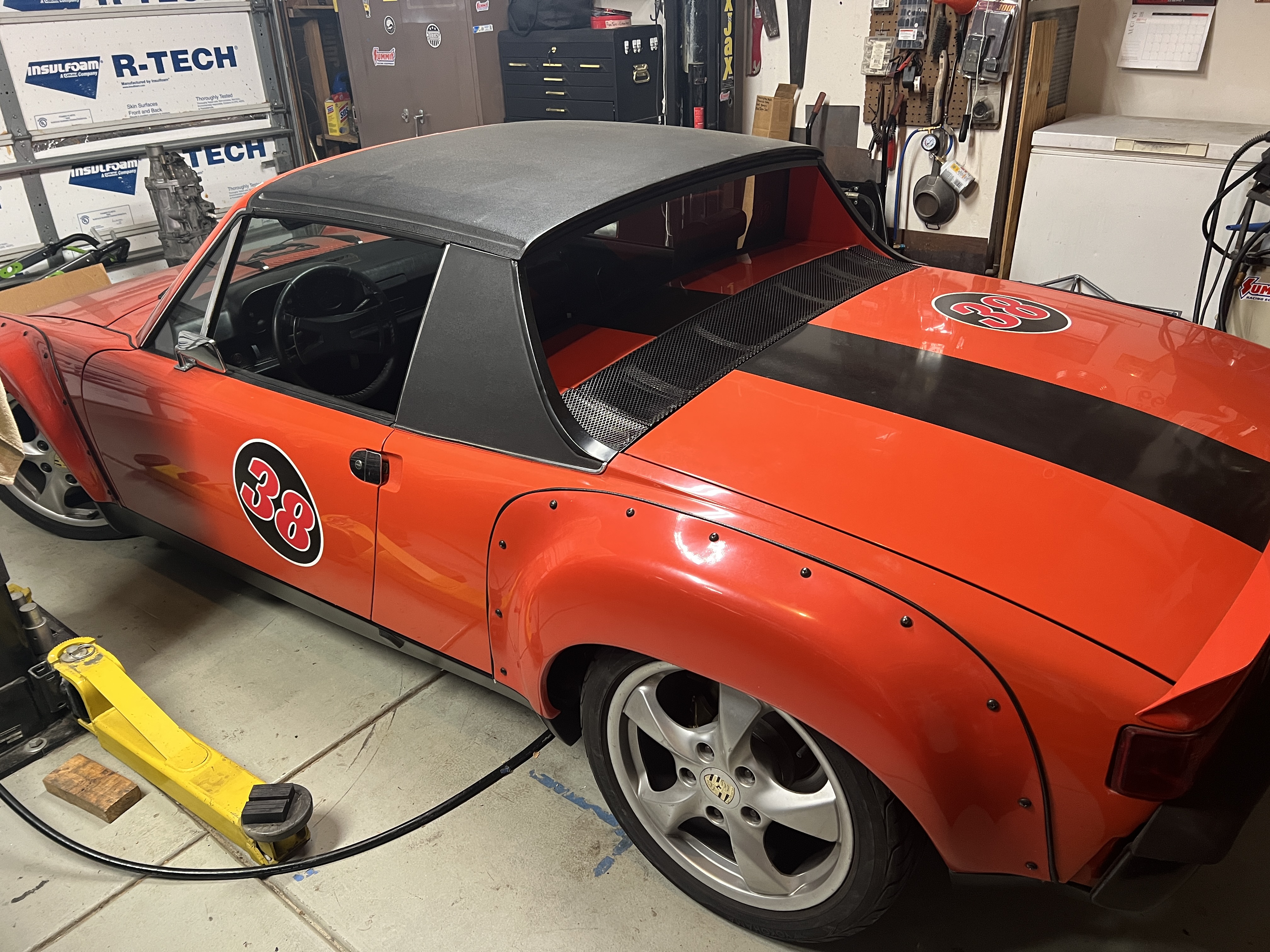

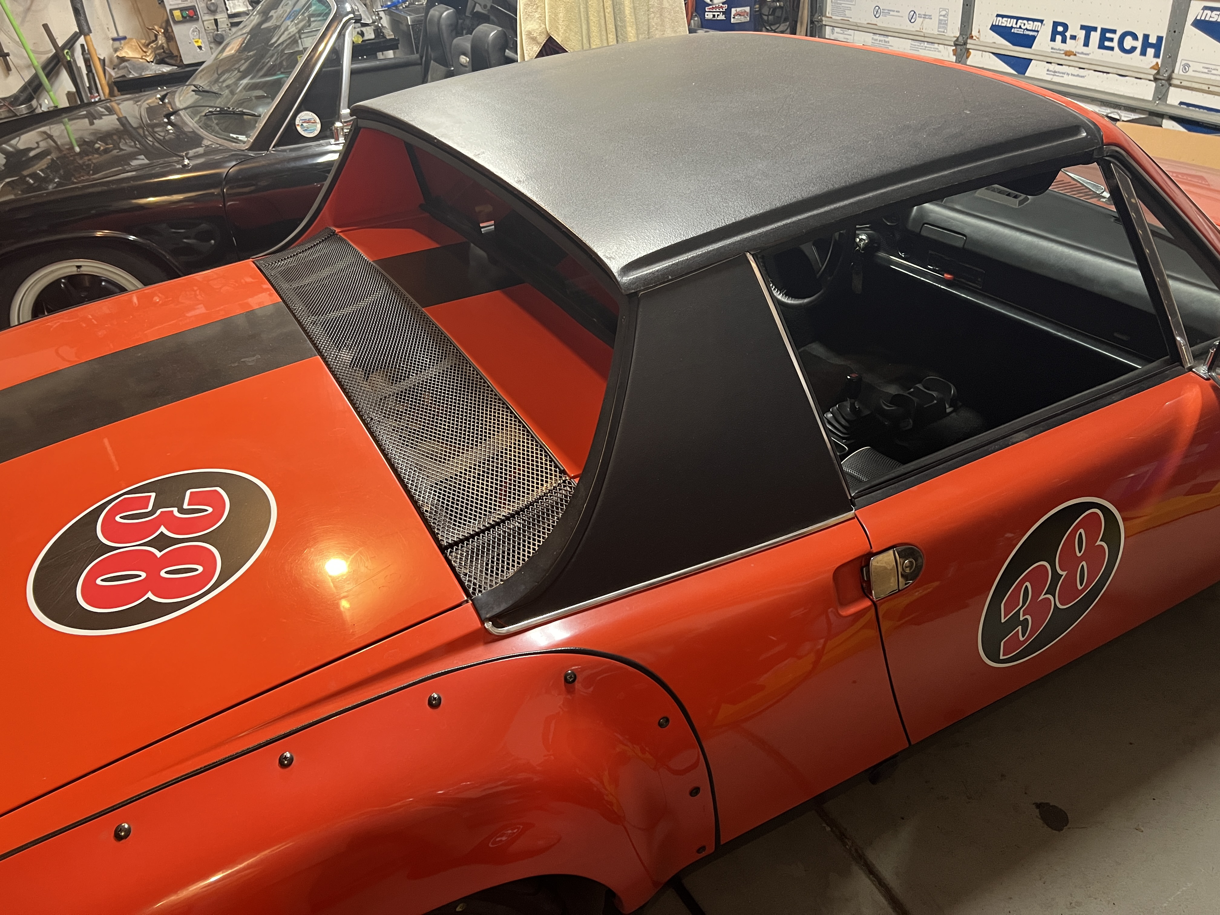

As it appears now that I put some make-up on her. (IMG:style_emoticons/default/biggrin.gif)
