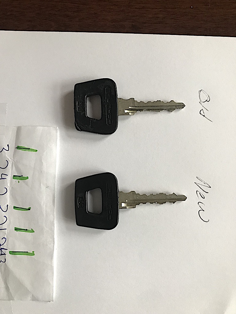

mlindner
post Sep 3 2022, 07:02 AM
Posts: 1,741
Joined: 11-November 11
From: Merrimac, WI
Member No.: 13,770
Well Curt has really done it....Keys by code, how about Keys by picture. I only have one key, told Curt I would send it to him this fall after Wisconsin driving weather to have two duplicates made. He said, why don't you send me a good picture and I'll see what I can do. Results, BRAND NEW key that works as good as the 45 year old original. That is really neat Curt. What a service to our little 914world community. Thanks, MarkAttached Image

TheCabinetmaker
post Sep 4 2022, 04:52 PM
I drive my car everyday
Posts: 8,367
Joined: 8-May 03
From: Tulsa, Ok.
Member No.: 666
Thank you Brian, you were a pleasure to work with.
