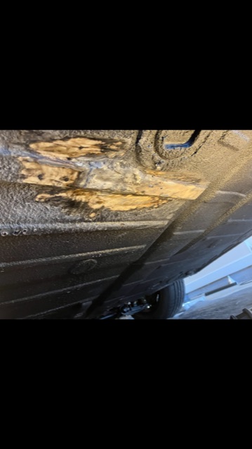

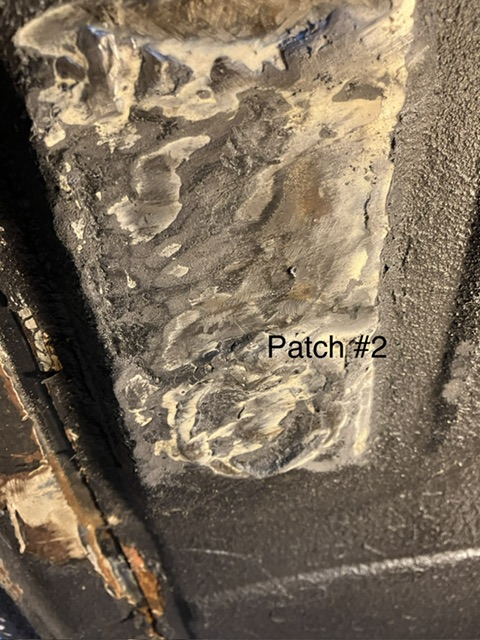

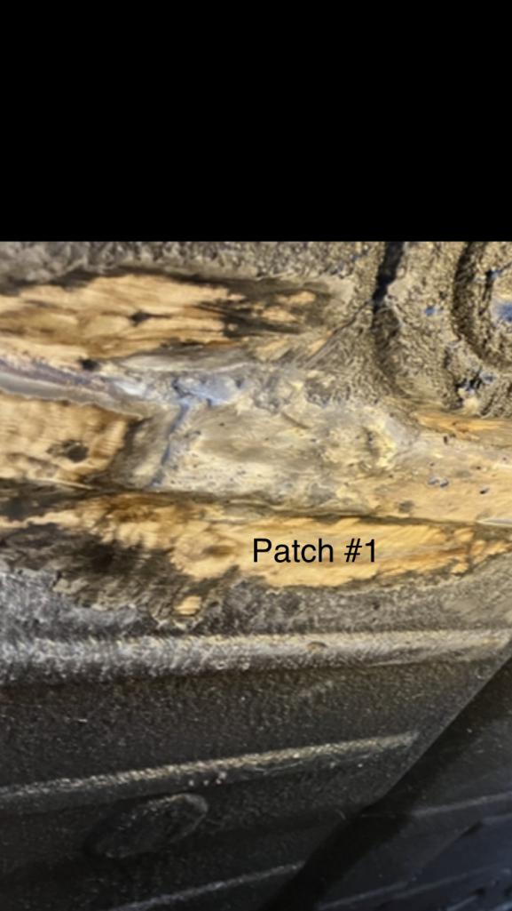

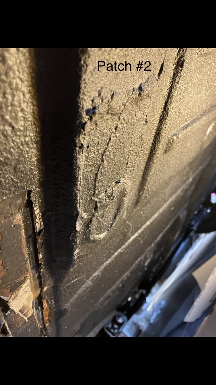

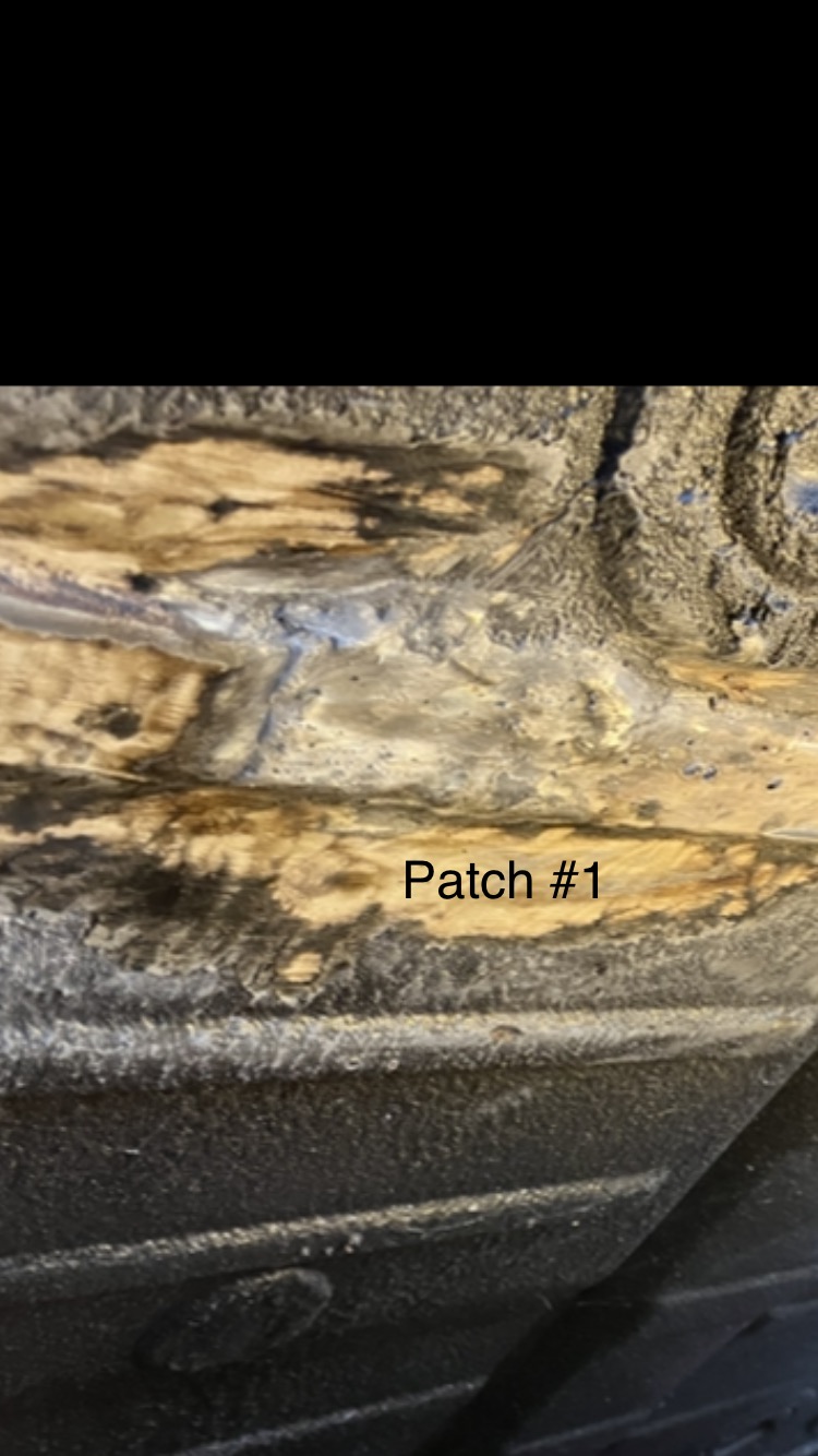

Rufus   Before deciding to purchase, I hired Jeff Gamroth ...   Jan 19 2024, 03:22 PM
Rufus   Based on Jeff’s report, I proceeded to purchase ...   Jan 19 2024, 03:34 PM
Rufus   Here’s the resulting invoice I paid for Jeff’s...   Jan 19 2024, 03:45 PM

930cabman   All sounds and looks great, until the last photo. ...   Jan 19 2024, 04:42 PM
Rufus   Headlight /high beam malfunction. Left headlight d...   Jan 19 2024, 05:31 PM

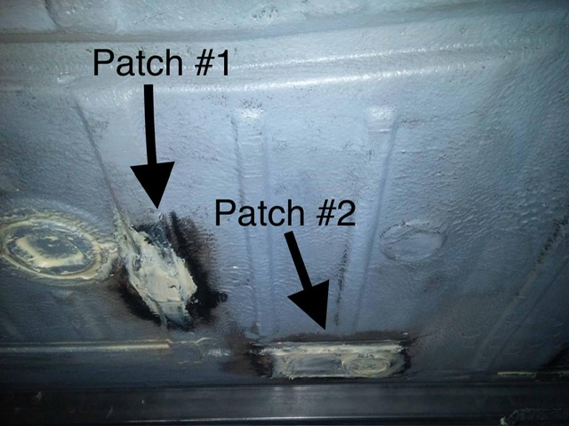

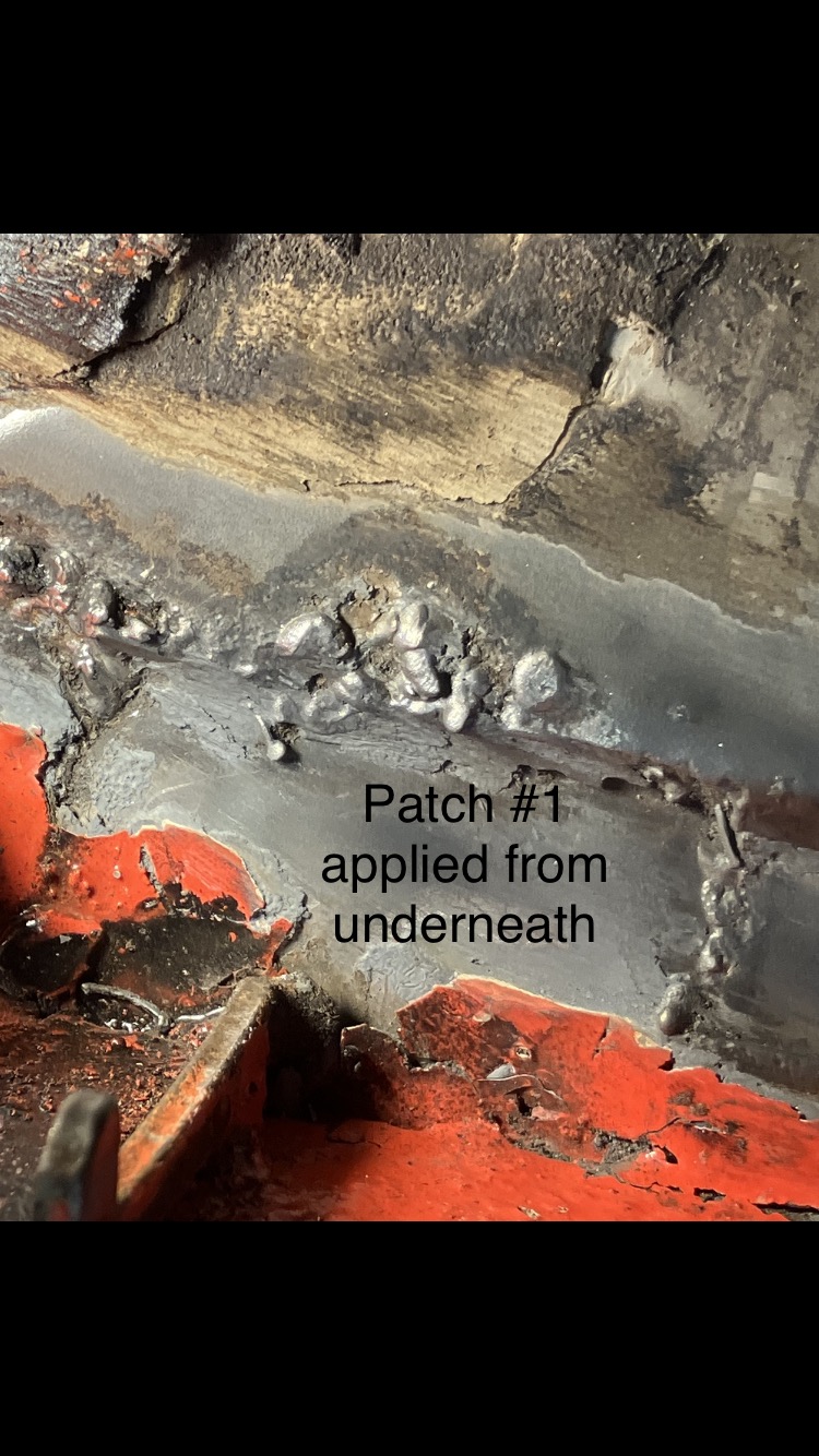

Rufus   Most, but not quite all work I approved is shown o...   Jan 20 2024, 02:34 PM

Superhawk996   Central will be whether there’s any welding inv...   Jan 20 2024, 07:40 PM

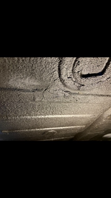

Superhawk996   And would it be a good idea to remove the underc...   Jan 21 2024, 06:10 AM

Rufus   And would it be a good idea to remove the under...   Jan 21 2024, 08:49 AM

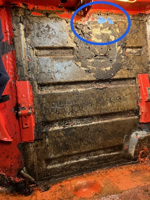

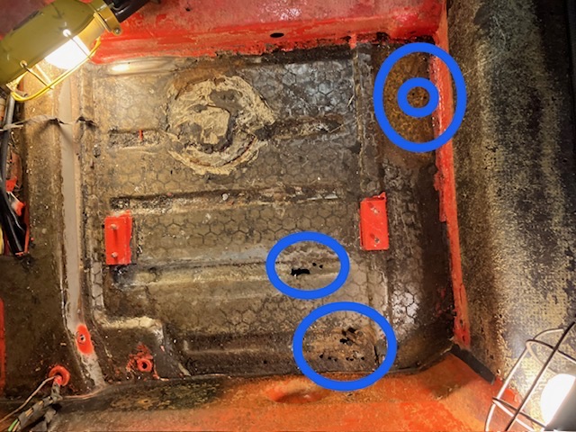

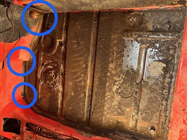

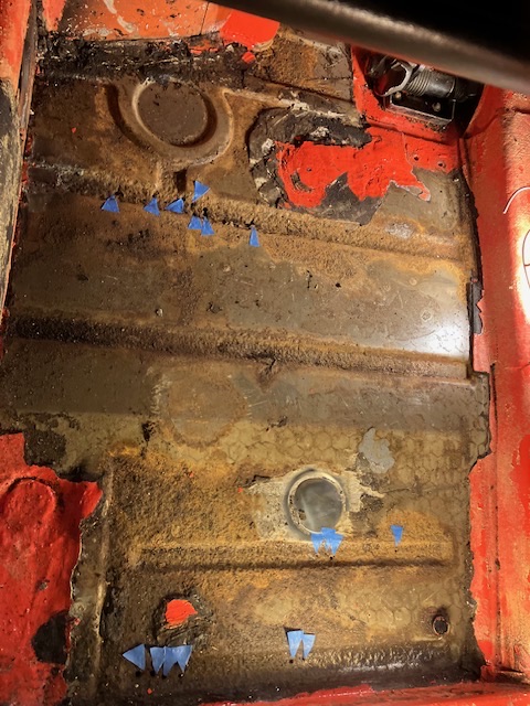

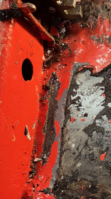

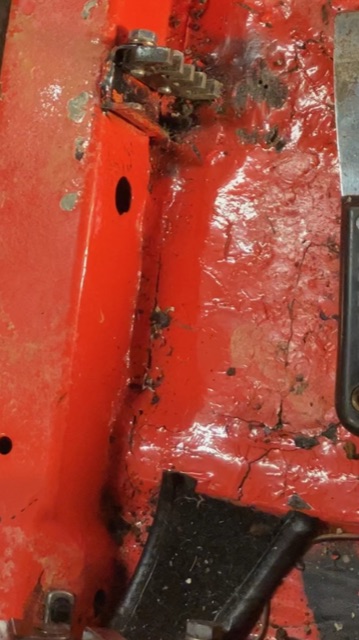

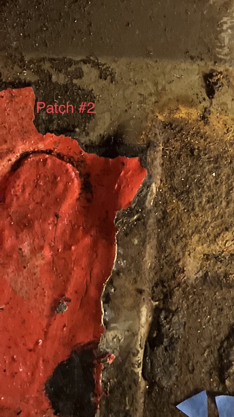

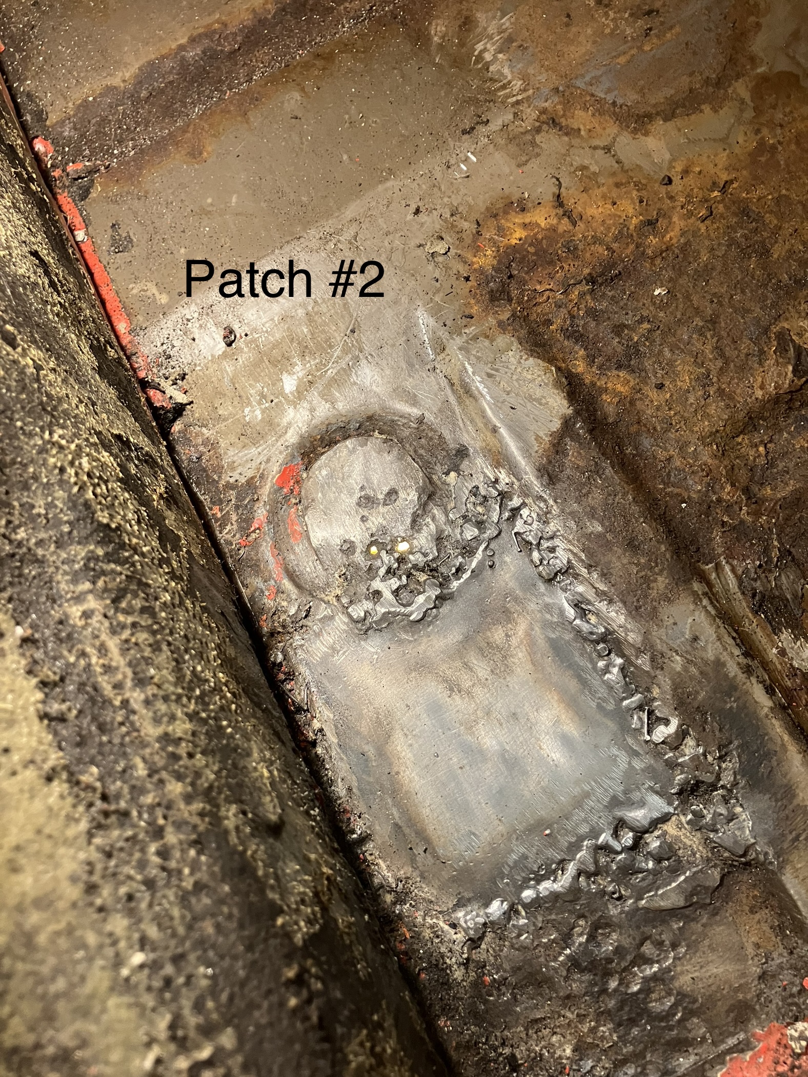

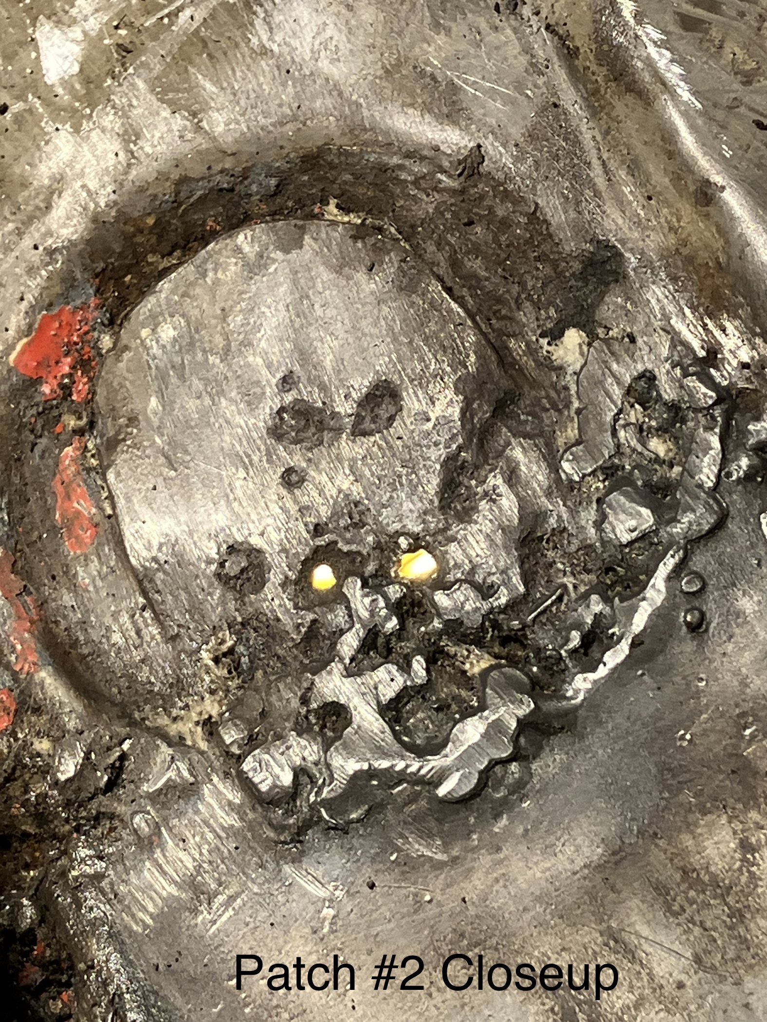

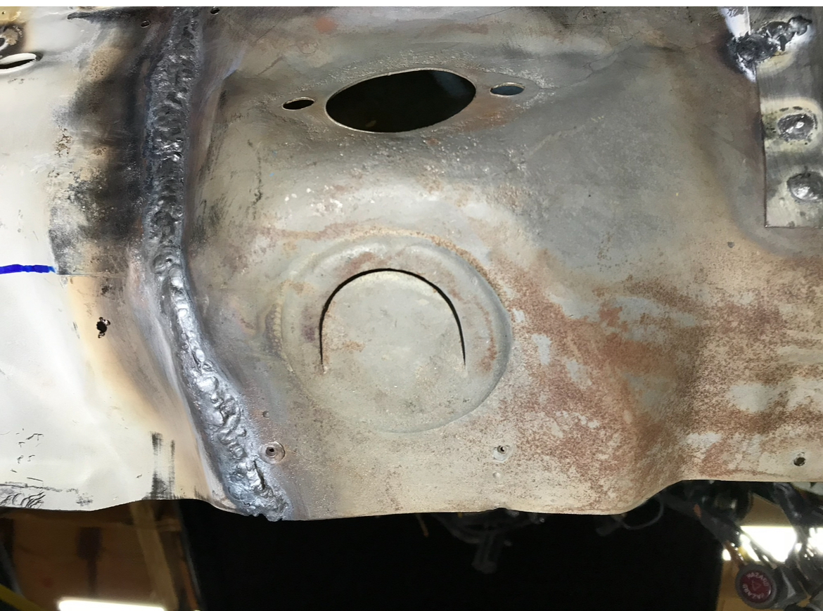

Rufus   The first 10 minutes of process of exposing the dr...   Feb 4 2024, 06:03 PM
mate914   The first 10 minutes of process of exposing the d...   Feb 4 2024, 07:38 PM
mate914   The first 10 minutes of process of exposing the d...   Feb 4 2024, 07:45 PM
930cabman   Progress. I am just about 99% convinced there is...   Feb 4 2024, 07:03 PM
Rufus   The first 10 minutes of process of exposing the ...   Feb 4 2024, 07:49 PM
Craigers17   Those floorboards look really solid so far. In a ...   Feb 5 2024, 05:43 AM
mb911   Looks like it will clean up nicely   Feb 5 2024, 05:45 AM
VaccaRabite   Those floors are pristine. You have started so yo...   Feb 5 2024, 10:48 AM
KELTY360   Much ado about very little.   Feb 5 2024, 12:21 PM
Rufus   And after a little wire brushing (under the driver...   Feb 5 2024, 12:50 PM
930cabman   Looks quite pitted, got to be some section loss   Feb 5 2024, 02:14 PM
Superhawk996   Very typical of rust under the tar. Better to g...   Feb 5 2024, 05:28 PM
Rufus   Thanks for your encouragement Superhawk. The screw...   Feb 5 2024, 05:48 PM
Karl R   I have recently had good luck using Evaporust in t...   Feb 5 2024, 07:02 PM
mb911   With a brush or spray bottle use this after you ge...   Feb 5 2024, 07:33 PM
Superhawk996   With a brush or spray bottle use this after you g...   Feb 5 2024, 08:11 PM
sixaddict   Unfortunately this story is far too common. As Mar...   Feb 5 2024, 07:36 PM
