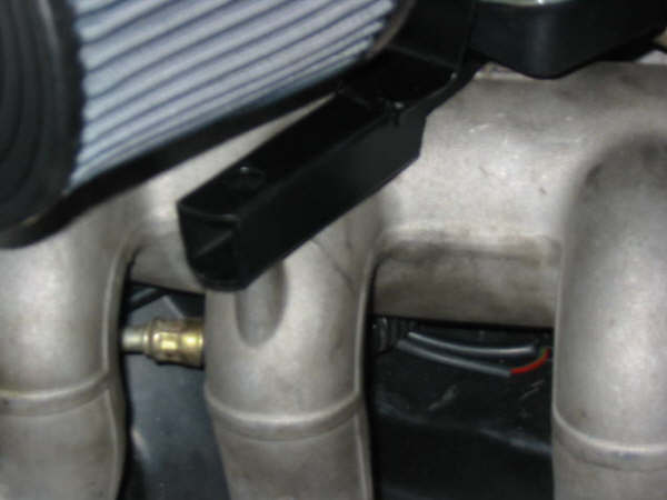

Ferg   Mount Close up   Oct 25 2005, 09:29 AM
Ferg   slightly turned to clear latch...   Oct 25 2005, 09:30 AM
Ferg   one more... I have more at home or can take more ...   Oct 25 2005, 09:31 AM

Ferg   More Pics were promised so here you go.   Oct 25 2005, 09:04 PM
Ferg   nuther, the mounting point on the aluminum intake ...   Oct 25 2005, 09:06 PM
Ferg   very tight but works, the pic angle makes it look ...   Oct 25 2005, 09:06 PM
Ferg   last one   Oct 25 2005, 09:08 PM
