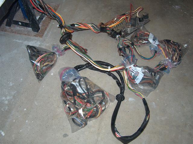

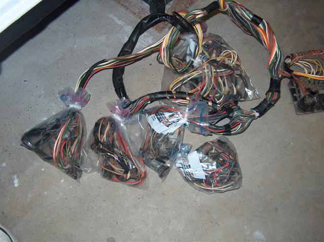

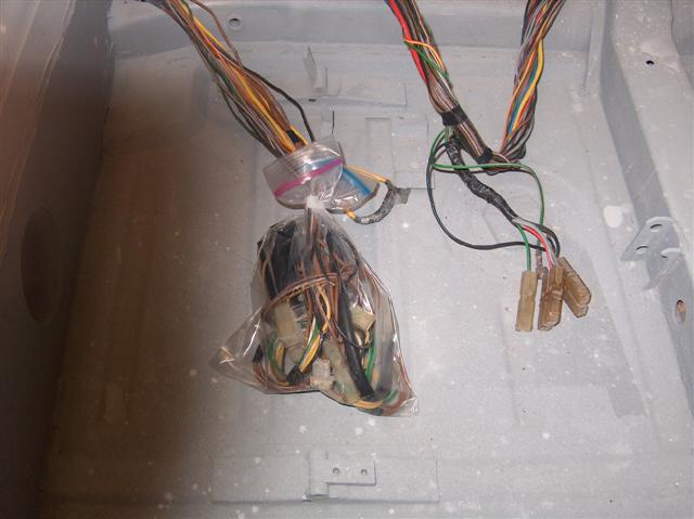

I made a mess of my wiring the last time that I shot the primer, so I bagged all the ends and I'll do a better job of masking the wires, scrubbing them with Acetone is a real pain.

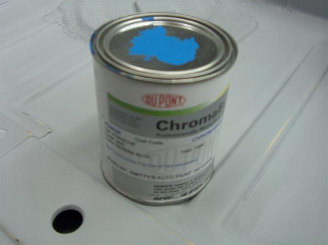

After careful consideration, I've decided not to paint the car the Riviera Blue. I bought a pint of it along with all the additives and the clear too, it came to $60.00 (IMG:style_emoticons/default/dry.gif) , so anyway, I was ready to shoot the rockers to see if I was going to like it, but first I thought that I should put a dab of the color on the lid... and it's just too light for what I want, so the search is on again for another color. I plan on doing this once, so I want to make sure its the right color. (IMG:style_emoticons/default/smile.gif)

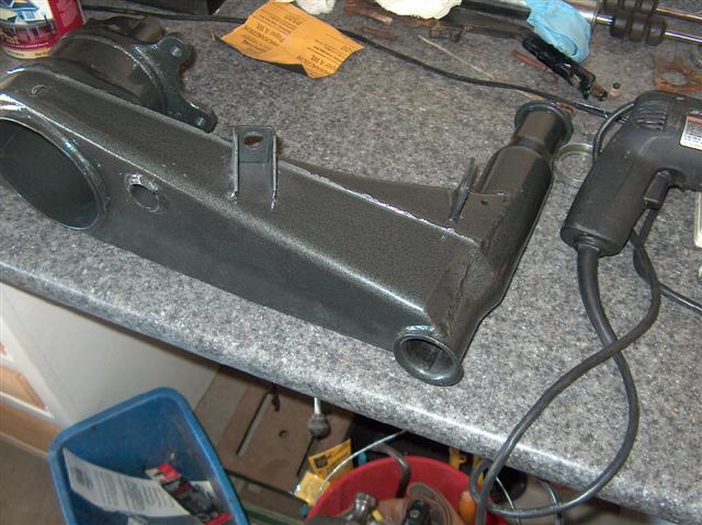

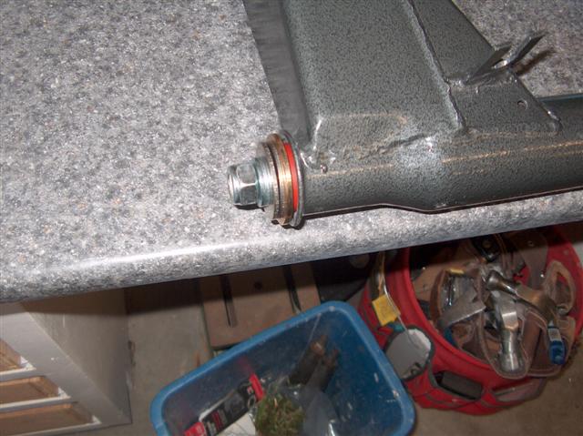

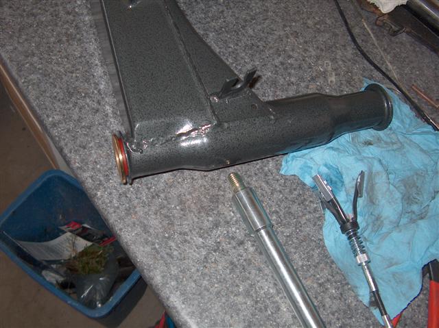

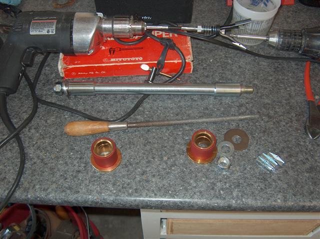

Well, I was waiting to post after I've completed the Poly/Bronze Bushing Sets. I've been working on the rears first. the Rear Control Arms openings after a period of time seem to go out of round, so after alot of work with a rat tail file, I was able to make them round again. I cleaned up with a honing tool;
Lou W
post Aug 16 2006, 11:52 AM
Post #135
Posts: 4,109
Joined: 9-May 04
From: Roseburg, OR.
Member No.: 2,039
Region Association: Spain

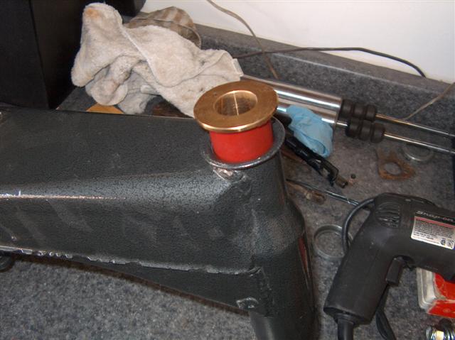

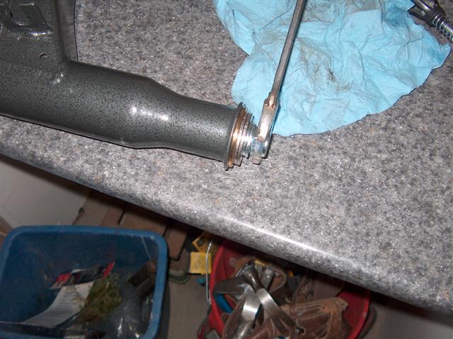

Here are some pictures with the bushings going in:
Lou W
post Aug 16 2006, 11:54 AM
Post #136
Posts: 4,109
Joined: 9-May 04
From: Roseburg, OR.
Member No.: 2,039

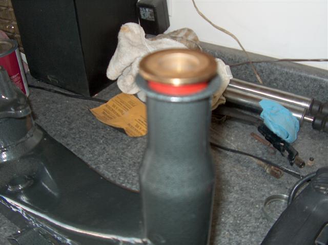

Here I got them just about all the way in, I had to stack some washers to drive them in tight:
Lou W

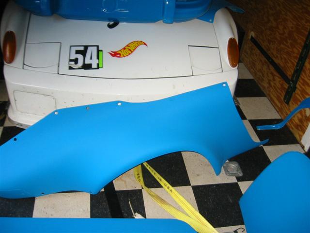

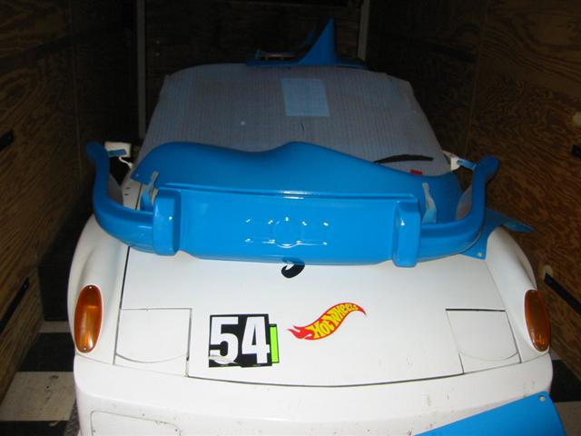

This is caribean blue. A water born paint by AutoAir Colors.
the first shot is a carbon door panel after clearing. the second two shots are some pieces of bodywork in my trailer
Lou W
post Aug 16 2006, 12:02 PM
Post #139
Posts: 4,109
Joined: 9-May 04
From: Roseburg, OR.
Member No.: 2,039
(IMG:style_emoticons/default/drooley.gif) oooh, I like that, my friend told me that the Rivera Blue looked too much like Earl Schieb blue, that really messed me up. (IMG:style_emoticons/default/mad.gif)

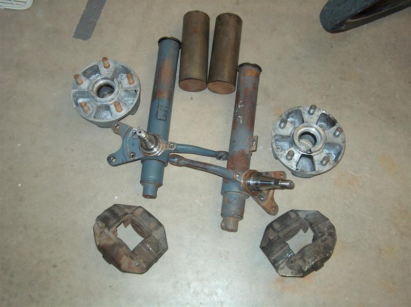

I decided to go a different route on the suspension, I got a set of 914-6 front struts with "M" calibers and a set of rotors. I'm getting ready to send the struts out for powder coating and the rotors out to be bead blasted;
