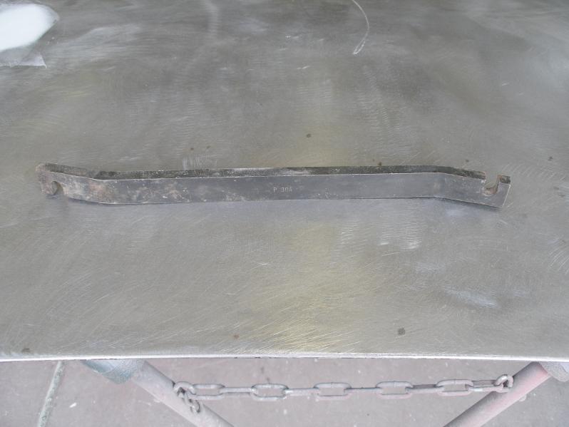

this it?
cooltimes
post Feb 21 2007, 09:03 AM
Posts: 2,508
Joined: 18-May 04
Member No.: 2,081
QUOTE(type47 @ Feb 21 2007, 08:50 AM) *
this it?
That's very like the Porsche factory original but you still have to remove the rear lid to use it.
I think AA and maybe Pelican sells one like that too.

Thanks to everyone for your recommendations (I'm going to keep the torsion bars) and Mike for the diagram....
Mark, thanks for the offer to borrow yours, you have a PM...

QUOTE(914Sixer @ Feb 20 2007, 09:43 PM) *
I have the factory tool if you want to borrow it. You pay the postage.
I want to publicly thank Mark for the use of his torsion bar tool. It worked very well. I was able to reinstall the torsion bar easily and safely.
It is people like Mark that make this the great BBS that it is.... (IMG:style_emoticons/default/smilie_pokal.gif)
BTW, I didn't need to remove the engine lid or the rear trunk lid, but I did remove the battery....
