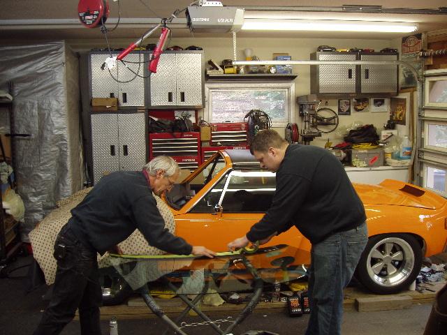

Ok i had the glass guys out here and we did a dry fit, the Plinkington glass did not fit the lower corners it sat up too high. I lost all the feeling in my thumbs for nothing.
They ordered another Window and a PPG, we will dry fit them all on Monday. What ever fits will get installed by them. I got my passinger window from BIGKAT today crated up in wood "NICE JOB" I can finish up the passinger door now and putz with other stuff while I wait till Monday. I will post some pictures later. |

Dry fitting a windsheild is scary! good work. Let the glass guys crack em! That way it's their dime!

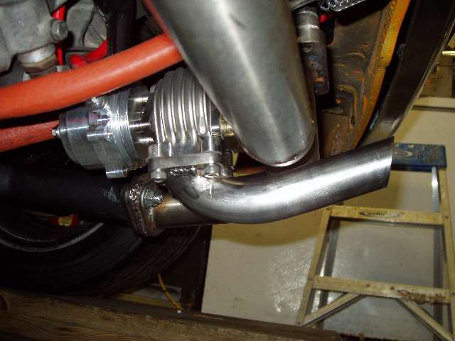

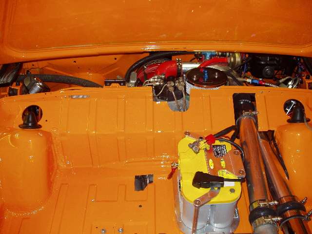

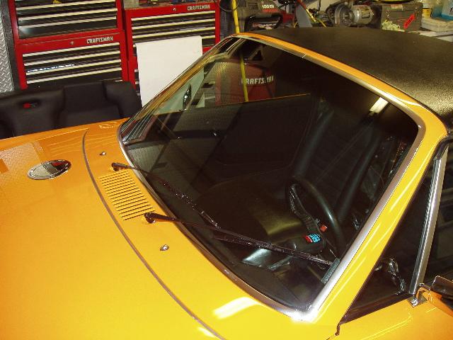

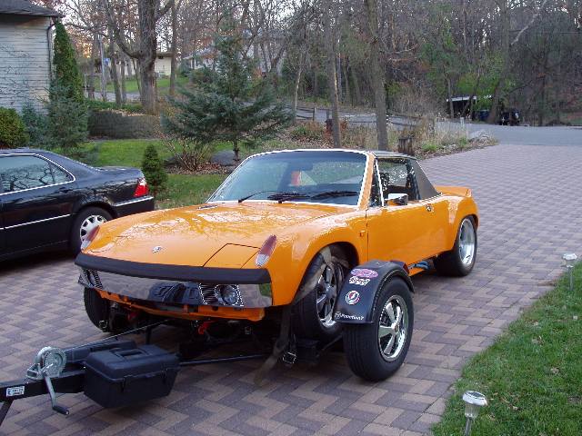

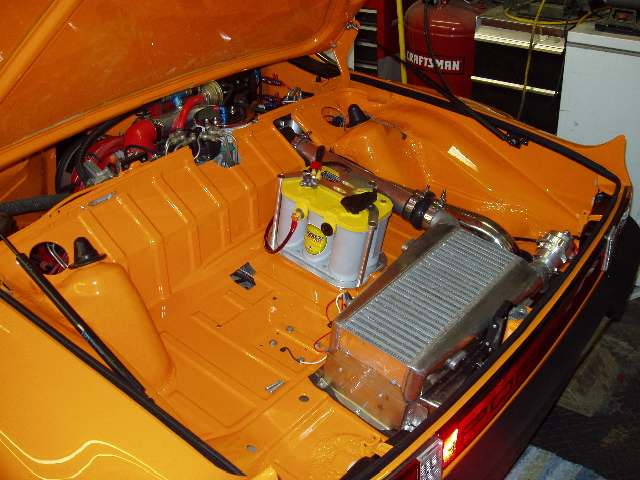

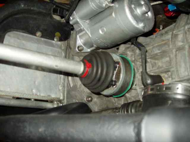

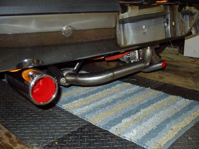

Windshield is in. wasn't picky i ended up with a PPG with a tint stripe across the top. Not as nice looking as the Plinkington full tint, but it fits! The old installer was from Belarus, he took care in doing a good job. I think I could of done a few things better if I had done it myself but it's in, the trim fits ok there are a few spots where the windshield is a little low and the trims not flush with the glass where i can peek under it. Spoke to the engine builder about firing it up and timing it, he says bring it in. I should have it on the road by the end of the week. Things i've done since i was waiting for the windshield: Installed the interior trim back on.(except backpad waiting till after the engine is timed) Lotus65's mirror, and sun visors. Rewelded tail pipe to fit and welded wastegate dump pipe. Safety wired CV's with the evil ones (using a shaky picture for depiction.) Hooked up heat controls and ducts installed engine heat shroud forced air duct.(may just install one for the other-side and fore go mounting the electric blower.) Fitted front trunk firewall and cleaned up battery wires Will start on the rockers and valance tomorrow, then I am done, REALLY! (IMG:style_emoticons/default/piratenanner.gif) Attached image(s)

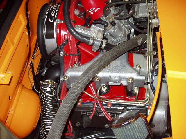

So I load up the car on the dolly and head out to Johnson Autosports to start the engine and time it. I get there and something is hanging up the dizzy from rotating looks to be my coils, Damn I will have to wait till Monday. I was so hoping to drive the car this weekend. (IMG:style_emoticons/default/mad.gif)

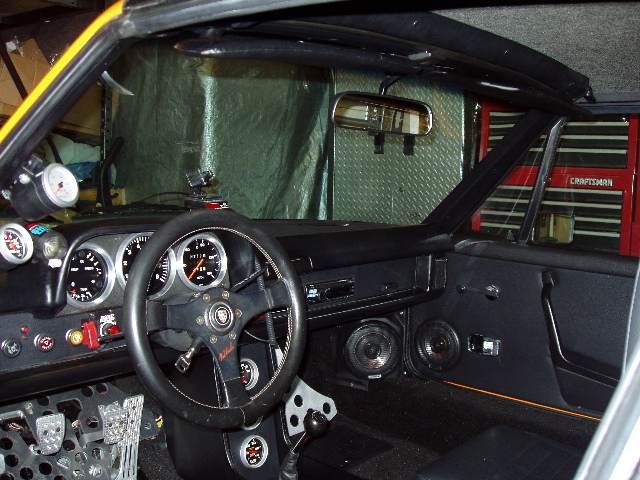

Nov 16 2007, 05:55 PM
#197
What it eventually will look like . . . . ![]() ![]() Group: Members Posts: 355 Joined: 29-March 07 From: Maple Grove, MN Member No.: 7,632 Region Association: Northstar Region |
That looks like the cockpit of an aircraft! Iffin' Paul hadn't already called shotgun for the first ride . . . .

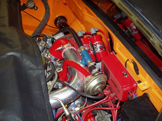

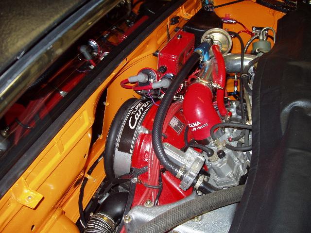

I moved the coils up to the alternator shroud so I am good to go, I will bring the car in this morning to start it up and time it.
The coils were mounted on my firewall, I never thought of moving them as they fit, well the problem is the twinplug dizzy cap is wider and the engine was spaced down about a 1/2 inch before to accommodate my other induction system, I found the dizzy cap was pinched against the coils bracket and actually cut the rubber boot on one of the plug wires, lucky it didn't crack the cap $$$$. The coils are now in mounted a better place and I may move the electronic ignition over to the drivers side now to make the passenger side less crowded. I will let everyone know how it goes.. (IMG:style_emoticons/default/bye1.gif) Attached image(s)
