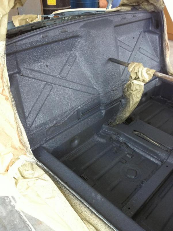

jsayre914
championgt1
Man that looks really nice!
dlee6204
agree.gif It looks awesome.
silver74insocal
pretty as a peach!! ya i used the damplifier pro and it made a huge difference. used brake cleaner on all the tar clean up...worked great..but kills a few brain cells..good luck bro
