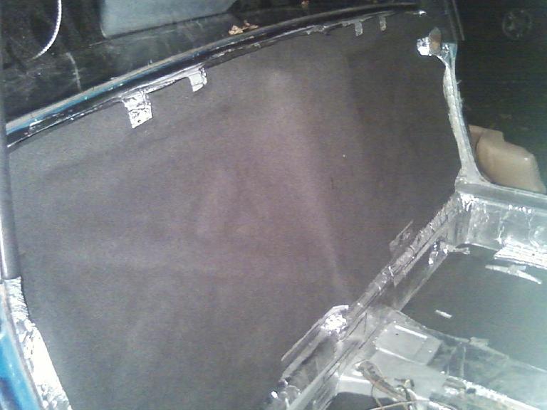

jsayre914

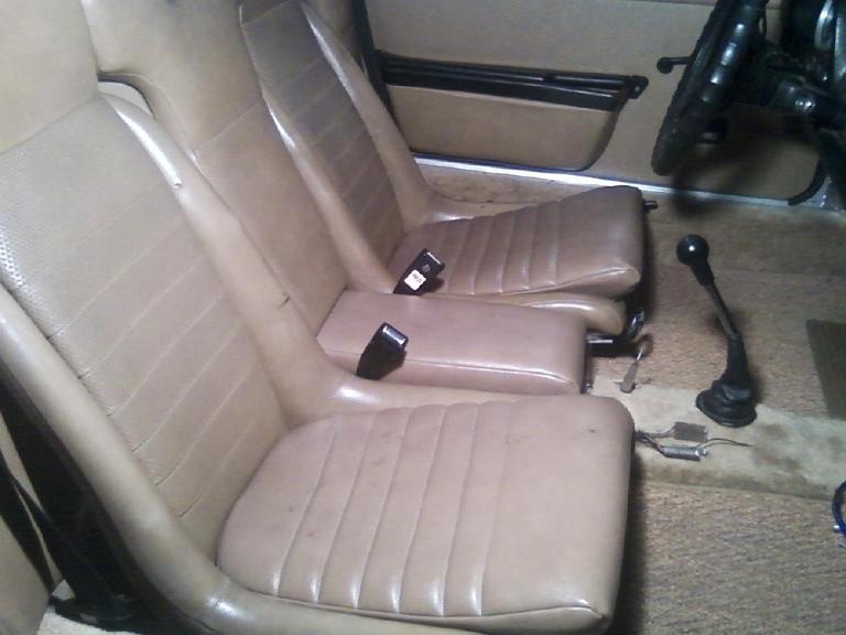

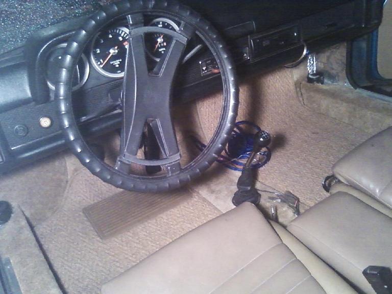

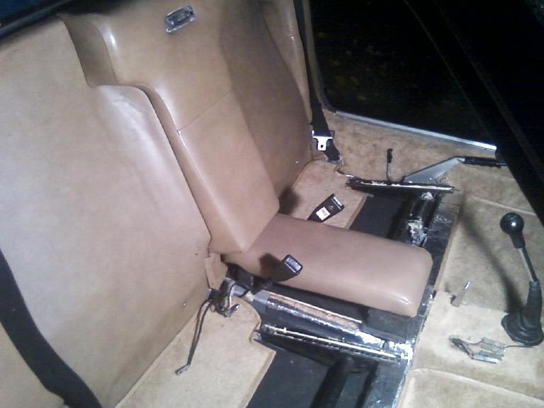

I put the interior back togeather last night. Man, was that a tight fit smile.gif the next steps on this project will be the doors and the front trunk.
jsayre914
The carpet is from 914 apperance and performnance. Camel, very nice.

Looks awesome great job dude. how did the carpet go in? what did you use to attach it and did you have to heat any up to get around the e brake area? thanks beerchug.gif
jsayre914
QUOTE(silver74insocal @ Oct 29 2010, 06:14 PM) *
Carpet went in easily, but you only get one shot with the adhesive i used. It is more sticky than any 3m product i have ever used. It almost has a spray/ sillystring kinda effect. Got it from the second skin company, figured i would try it. I highly recomend it.
As far as the Ebrake area, i just ran the carpet straight, then once i had everything tight on the straight edge, i grabbed the ebrake and put it up and down a few times, it created the shape just perfect. I was a little worried about that area before i did it.
