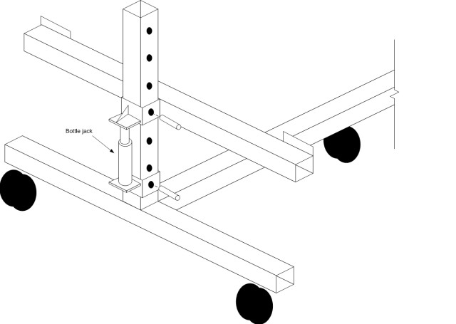

This may be a dumb question but how do you get the 914 high enough to bolt it onto the rotisserie? Most of the rotisserie redesigns I have seen would require the 914 to be 3 to 4 ft off the ground to bolt it on.
jcd914
QUOTE(9fourteen @ Dec 22 2011, 04:29 PM) *
I think it is great question, I have not attempted this, yet.
Several ways come to mind depending on what you have to work with.
A lift works really well but only a few here have them in their garage at home. I have a couple friends with shops and I could go there and put the car on the rotisserie but then I have to load the car on to a trailer while it is on a rotisserie, may not be my first choice.
A fork lift could be used but you have to have access to one or rent one. Probably more money that I want to spend.
Someone here posted some picture of an engine hoist being used to lift 1 end of the car up to get it on the rotisserie, a possibility since I have access to a couple of those. Have to figure out how to lift it without damaging the body.
Floor jack(s) and some sort of cribbing. Jack up one end at a time and stack wood or such to rest it on while you jack the other end up. going back and forth you could work it up to the right height. You have to be sure the cribbing you use is stacked stably and your jacking method is still stable as you get up off the ground. If the timing was such that I was replacing the back fence (that is starting to fall apart) I might have enough 4x4s to use for cribbing before I built the fence with them.
I also have a friend that has a couple motorcycle service lifts. They are small enough to bring 1 to my house and use it to lift the 914 body. Weight of the 914 shell would be in the range of the lift but i am not sure the height that is possible with it.
Just a thought or five

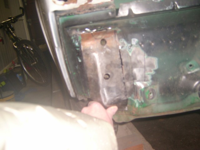

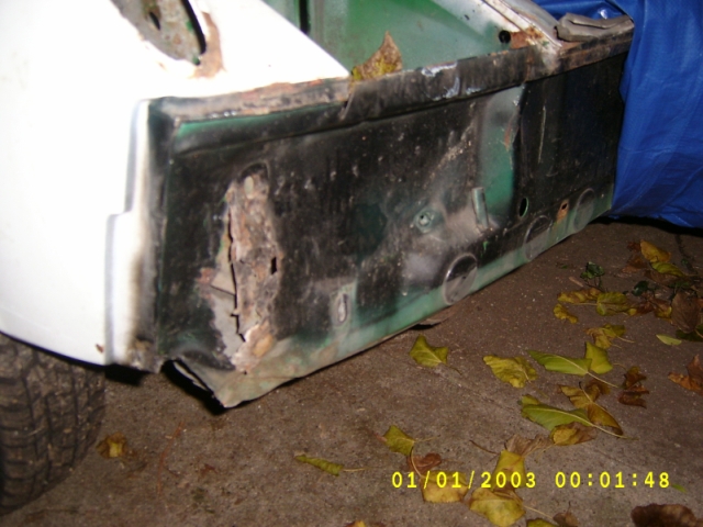

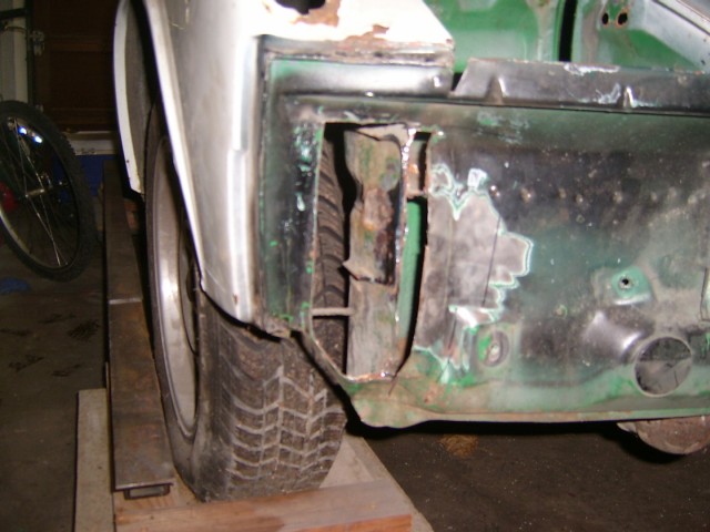

Just one question. I plan on putting my 914 on a rotisserie but the front bumper holes are quite rusted. Is that a problem?
Thank you,
Lee
9fourteen
QUOTE(leebenedi @ Dec 23 2011, 04:25 AM) *
Lee,
I have the same issue and assumed "yes" since that is where I plan on mounting the rotisserie. I am a complete novice on this stuff so I figured this was a good place to start perfecting my welding and metal working skills since it would not be visible and not as critical structurally.
Here is what I found when I pulled the bumper
Here is what I have cut out, still need to grind it a bit
Here is my patch. (second attempt) It's starting to look ok. Just need to get it cleaned up and welded in.
Here is a crude drawing of what I was thinking as a solution to getting the car up high enough to spin. (this drawing is missing a lot of stuff. it's just to show my raising and lowering idea)

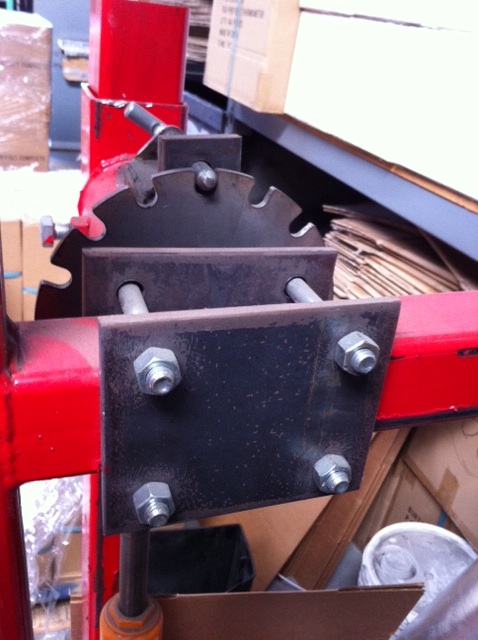

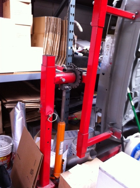

burton73
Mark,
This is on my unit I bought it for $1100. But it has a great indexing holder when you turn the car. It makes it very easy to work on the car at all different angles. With the Jacks it makes it very easy to make the car go to the perfect working height as well. Just some ideas for you.
Bob
Click to view attachment Click to view attachment
McMark
I'm building a similar locking pin setup.
The hydraulics are nice, but beyond the scope of this project. I have a lift, so getting cars up and down is no problem. sunglasses.gif

QUOTE(McMark @ Jan 25 2012, 03:36 PM) *
Finally found the bearing setup I wanted to make the rotation super smooth. happy11.gif
This also sticks with my plan to just try and use up crap I've got laying around the shop. So far I have $0 invested. smilie_pokal.gif

McMark
Finally finished up the brackets for the rotisserie. Used some 1.75" DOM tubing, and 1" DOM tubing I had lying around. Works really well and all the nay-sayers from above were wrong. tongue.gif It rolls just fine and its super solid. I'm happy. biggrin.gif
Yeah, it's a 911. 914 fixtures are next - gotta do the floor pans on the 914/6 project.
FourBlades
Looks great! That is very innovative.
Now just add a motor and brakes. You already have the steering wheel. biggrin.gif
