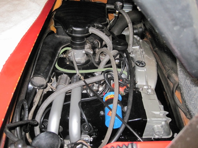

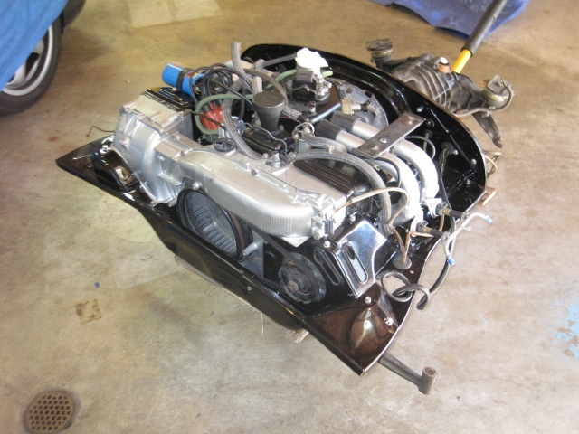

Hi guys,
I spent last few weeks to prep on my newly acquired 2.0 and it's finally in the car! But she doesn't wanna wake up.... sad.gif I know our Bay has been cold lately...but today is beautiful!!!
It turns over, has fuel pressure around 30psi when cranking(20psi soon after when the key turned off), static timing done after points gap adjusted, all the electrical connections checked I think, and what else???
Actually there're at least 2 concerns I can think of. When I got the motor, the dizzy rotor was pointing somewhere around#4 position when the TDC mark was showing in the round window. So I moved the gear in order for rotor to point #1 as I confirmed the valves were loose. But wondering if I did it correctly. I took the gas tank out as I installed stainless fuel lines. The tank was sitting in my garage for about a week or so then it developed some rust. So I cleaned inside with rust remover. But I might not have rinsed it well enough. New fuel filter still looks clean after uncountable numbers of attempt of starting the motor. New fuel sock is in the tank.
What do you all think I screwed?
Thanks in advance,

Are you starting the engine with it in the car o on an engine stand?

it's in the car already as seen on the 2nd pic.

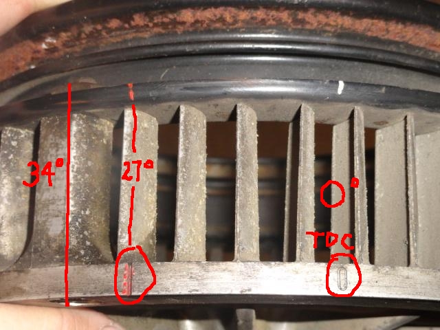

QUOTE(kkid @ Dec 13 2013, 03:30 PM) *
... When I got the motor, the dizzy rotor was pointing somewhere around#4 position when the TDC mark was showing in the round window. So I moved the gear in order for rotor to point #1 as I confirmed the valves were loose. But wondering if I did it correctly.
You'll see the TDC marker in the window for every revolution of the crank, not just for cylinder #1. Make absolutely sure you're at TDC on cyl # 1. The fact that you said it was pointing at cyl # 4 and you had to rotate go the dizzy drive gear 180° has me wondering if you were watching TDC for cyl # 4 instead of # 1 confused24.gif
For a spark check, pull one of your spark plugs out and lay it where you can see it. Keep the hi tension lead attached and ground the threaded portion with a good-sized alligator clip and jumper cable, then have an assistant crank the motor while you watch for spark.

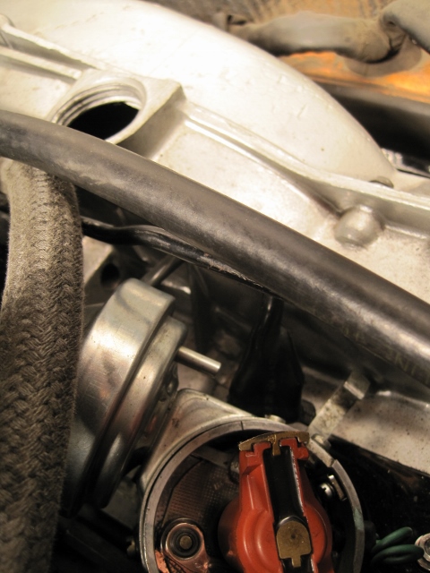

By changing the distributor drive gear around whn you got the motor back from the engine builder, you probaly have it 180 degrees out of time. The is only one correct position for the cam, crank and distributor to all be timed correctly when the engine is assembled. Let's assume the engine builder did it right, but the engine was turned over by hand after it was assembled, probably when they installed the fan & alterntor belt.
The firing order is 1-3-4-2. That means whenever TDC comes up to the timing mark/pointer, the rotor will either be pointing to #1 or #4 cylinder (and no others). Switch the distributor drive gear back to where it was when you got he engine and then set the static timing of the distributor. I bet it will probably start right up. I once had a similar problem with a 1960 Alfa Romeo Gielietta. The PO's previous mechanic had installed the distributor shaft drive gear wrong by 180 degress and then moved all the plug wires on the cap by 180 degress to make it run, instead of tearing the engine down to install the distributor shaft drive gear correctly. There is a reason the distributor shaft drive has a gear at one end and an offset "notch" at the other.
wndsnd
QUOTE(914sgofast2 @ Dec 13 2013, 08:09 PM) *

Install your dizzy with Cyl#1 at TDC and snap some pix of the dizzy with the cap off. Show us where the little notch is in the dizzy's body is and where the rotor is pointed.

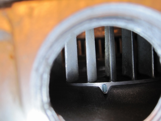

That is not the flywheel, it's the cooling fan. That IS a timing mark which may or may not indicate TDC. I think It may indicate 27 deg BTDC. The timing mark on the flywheel is viewed through a hole where the trans and engine cases come together, from underneath.
Assuming both pictures were taken without rotating the crank AND assuming that is the 27 deg BTDC mark then It looks to me (not an expert) that your timing is retarded 27 deg when its not running. That may keep it from running.
So I wonder... If you rotate the dizzy clockwise 27deg, to match up with the timing mark on the fan, would it start???
At least I think it's clockwise (not an expert).
Good luck!
euro911
Zero is TDC. The hash mark on this fan is 27° BTDC. For a 2.0L, you'll want approx 34° at 3500 rpm. Depending on a couple factors, 34° may be too much advance. You don't want any pinging, so be prepared to retard if necessary, then make a new mark for your specific requirements.
Read this Pelican article on timing ... Click here
kkid
QUOTE(Bob L. @ Dec 15 2013, 11:51 PM) *
Good luck!
You're right! It's a cooling fan not a flywheel that's we're looking at. On my 2.0, I believed the TDC is painted in white and timing mark is a red skinnier mark. How's yours, BOB?
Speaking of a flywheel, if we see the engraved mark(TDC) from the window underneath where the cases are mated, it means the TDC for both #4 or #2. Am I understanding this correctly?
Thanks,
Bob L.
Mine has only one mark for 27deg BTDC. I have read there is some variation in these marks depending on the engine size/Mfg date... I set my timing to show the red line in the notch at 3500 RPM, fully advanced.
I believe the flywheel mark in the little window should be TDC for #1 or 3 depending. It will alternate, one then the other.

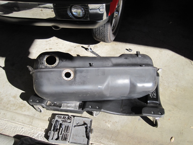

kkid
Pulled the gas tank today and sent it to a local radiator shop in my area.

The zero on your fan is tdc. That and the notch in the distributor body that the rotor points to is correct. The timing for a djet is at the 27* mark on the fan like Euro's pic shows. Never 34 with djet.
Try pouring more than "just a little" fuel in the manifold then crank it again. If you have fire at the plugs, and fuel in the manifold, it should start.
kkid
QUOTE(The Cabinetmaker @ Dec 17 2013, 08:47 AM) *
Now my gas tank is out and the 2 fuel lines are hanging in the trunk(plugged with paper towel). Everything else is connected. Can I still try your method with more than "just a little" fuel? Maybe I should take the fuel pump relay out and try this again? Can I pour it from TB with the butterfly closed or direct into the plenum?
I can try now but hope the battery is still strong enough to start it.

It looks like I should abort the fuel tank cleaning until we discover the problems(s).

Will pick up my gas tank from my local radiator shop this afternoon.
Hoping to install the tank either today or tomorrow to see if she wants to wake up this time.
