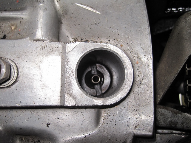

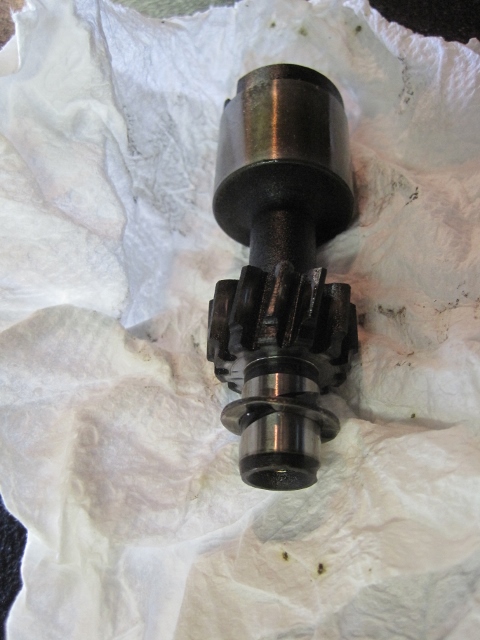

Someone gave me a suggestion that the squeak noise maybe caused by a dropped dizzy drive gear washer in the case.
So I took the gear out to see if the washer is still with it. Yep, the washer came out with no problem. It wasn't dropped in this case. Does the gear look OK for you guys?
Click to view attachmentClick to view attachment
I also tuned the flywheel a few cycles by hand again. It's not hard to turn with the all spark plugs removed. But there is a noticeable hardness at a point in the revolution. Somehow the squeak noise seems to have disappeared today.
Where should I go from here?
